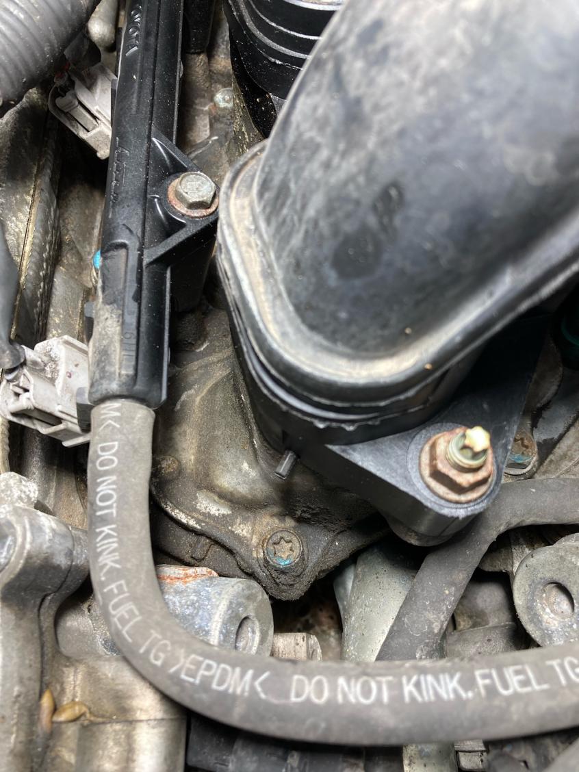

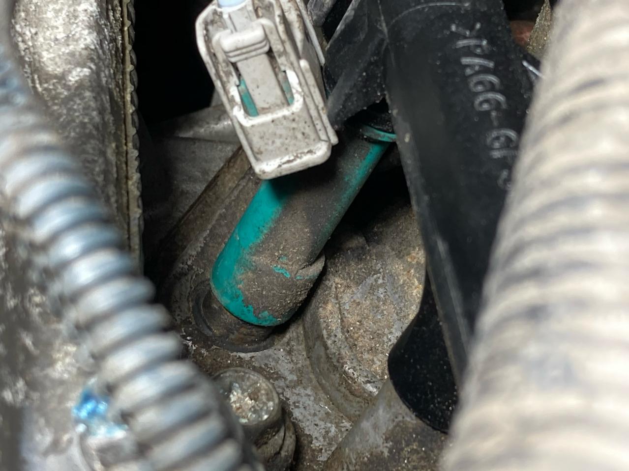

I am removing the plastic intake plenum to replace the Left side fuel injectors because my LTFT bank 2 is going lean under load. No misfires, no codes. And i suspect the fuel injectors are faulty. If it was a vacuum leak, the LTFT would be less affected under load than at idle.
After removing the airbox, I can see heavy oil residue (not wet) on the aluminum intake, up the fuel injectors, mostly on the passengers side. Its not from the valve covers although I am changing the valve cover gaskets while I am this deep in. What I’m not sure of is if the oil is migrating up from the intake/head gasket or migrating down from the intake/plenum gasket. I started cleaning the oil off with carb cleaner before taking the picture but in this picture you can see a thick coat of oil and dirt at the front edge of the intake which is what the whole area looked like before cleaning. The oil is all the way from front to back.
So where would oil come from? Is this from leaking fuel injector seals, escaping pcv vapors, coming up from the block valley? Should I also replace the intake/head gasket? Would that do any good?

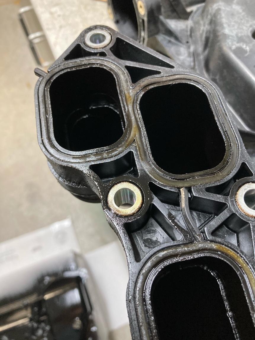

Update. I just removed the plenum. The gasket was hard an compressed and soaked in oil. I’m shocked that there is so much oil in the lower intake runners. The original pcv valve was still in the truck (222k miles)and when I removed it, it was hardly moving. I replaced that last month. Hopefully that reduces oil consumption.
Here is a picture of the plenum seal and the oil which was outside the seal area.

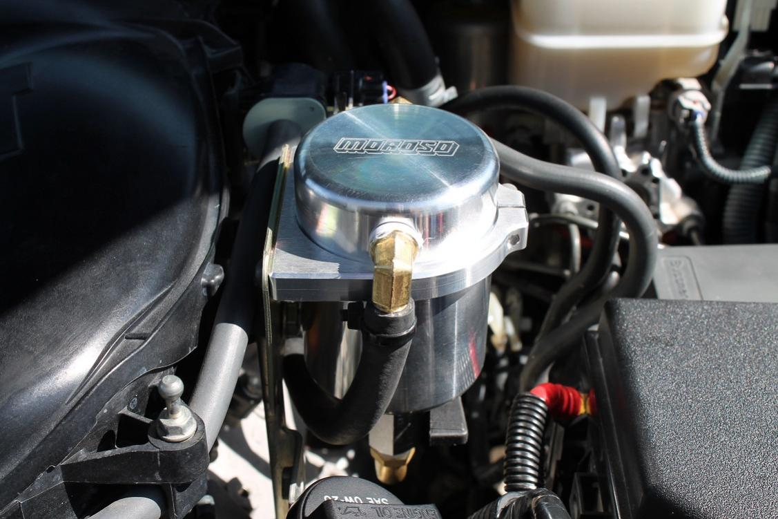

I went way over kill on my 5th gen. The Moroso name adds 5 hp right?
It does a good job and adds a little bit of bling, but stupid expensive for what it is.
