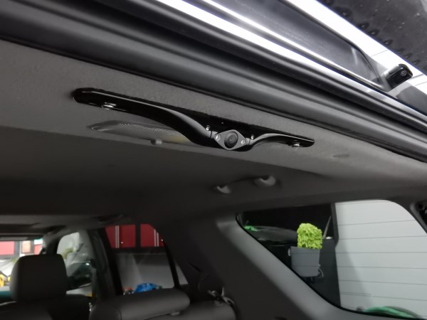

I opted for the license plate style camera and unconventionally mounted it inside the truck on the roof by the rear light. No weather issues to worry about. No silicone needed.
The benefit is that I have a higher angle of view looking down and it never ever gets dirty. if the window is covered with dirt or snow, I simply lower the window and inch to get a clear view.
Note: you have to reverse the camera in the mount as the picture will obviously be in reverse and the swivel allows for easy adjustment.

Do you have a hitch that you use and can you see it in the camera? Just curious. I think you have a great idea going here.
