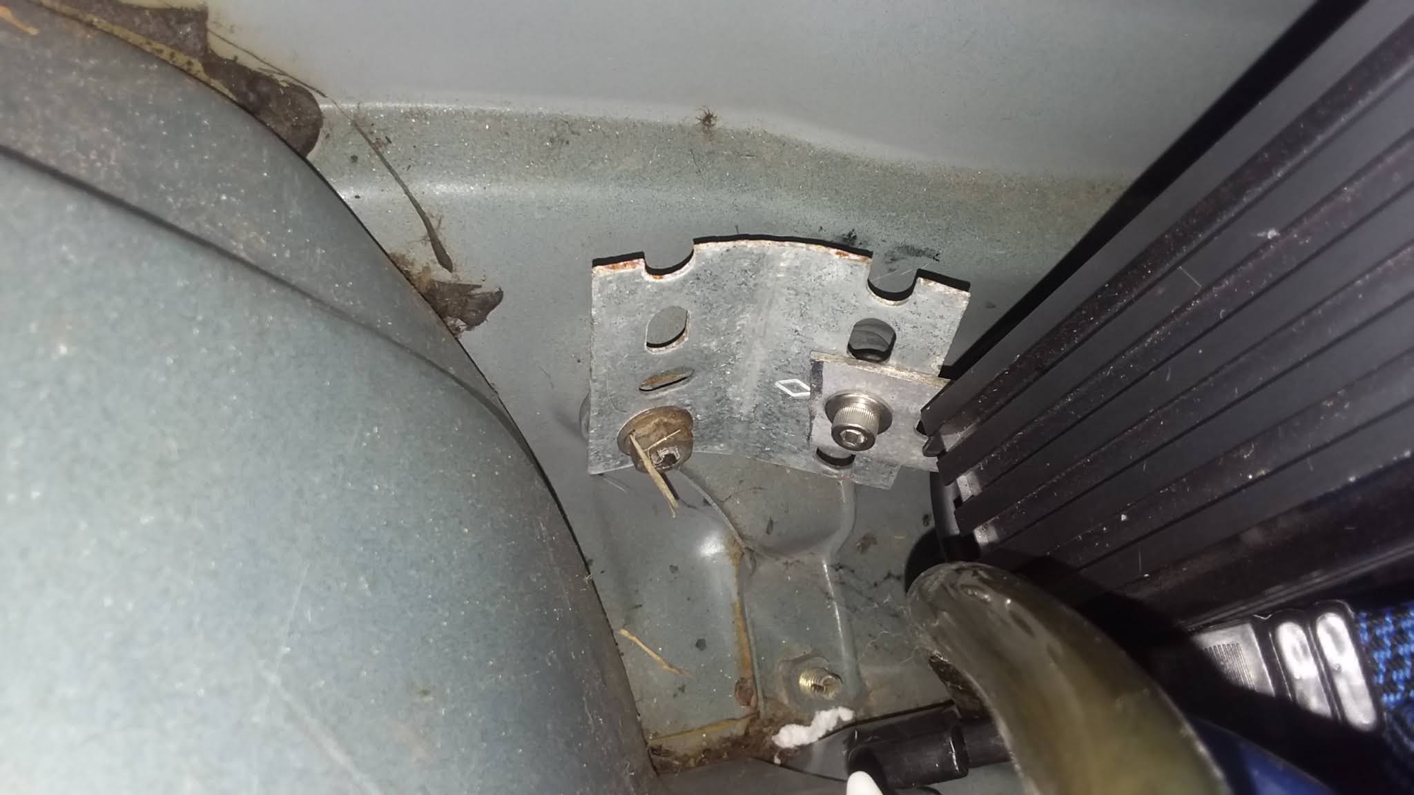

I went and looked at my truck just to be sure. I have actually removed the storage compartment for my 4 channel amp, that is now blown. But you can see the gold nut going through the bracket I added for the amplifier. There is a 2nd one hiding behind the bracket I added there.

Thanks for the pictures and for the info, I'm going to go in there today and replace the old broken spinner and get it replaced. Thanks everyone.
Update:
Took the rear interior panel off yesterday and part of the interior bracket with the nut welded in place had rusted and broken off and just spinning in place. Took care of it with a dremel and replace with new nut,bolt, and washers. Also decided to clean and treat with rust converter and rubberized undercoating. Then I followed up with some sound deadener I had left since somehow I missed that area. All good to go now.
