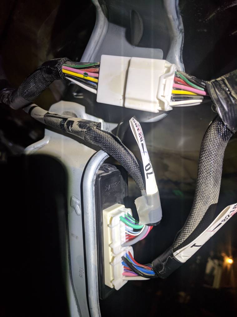

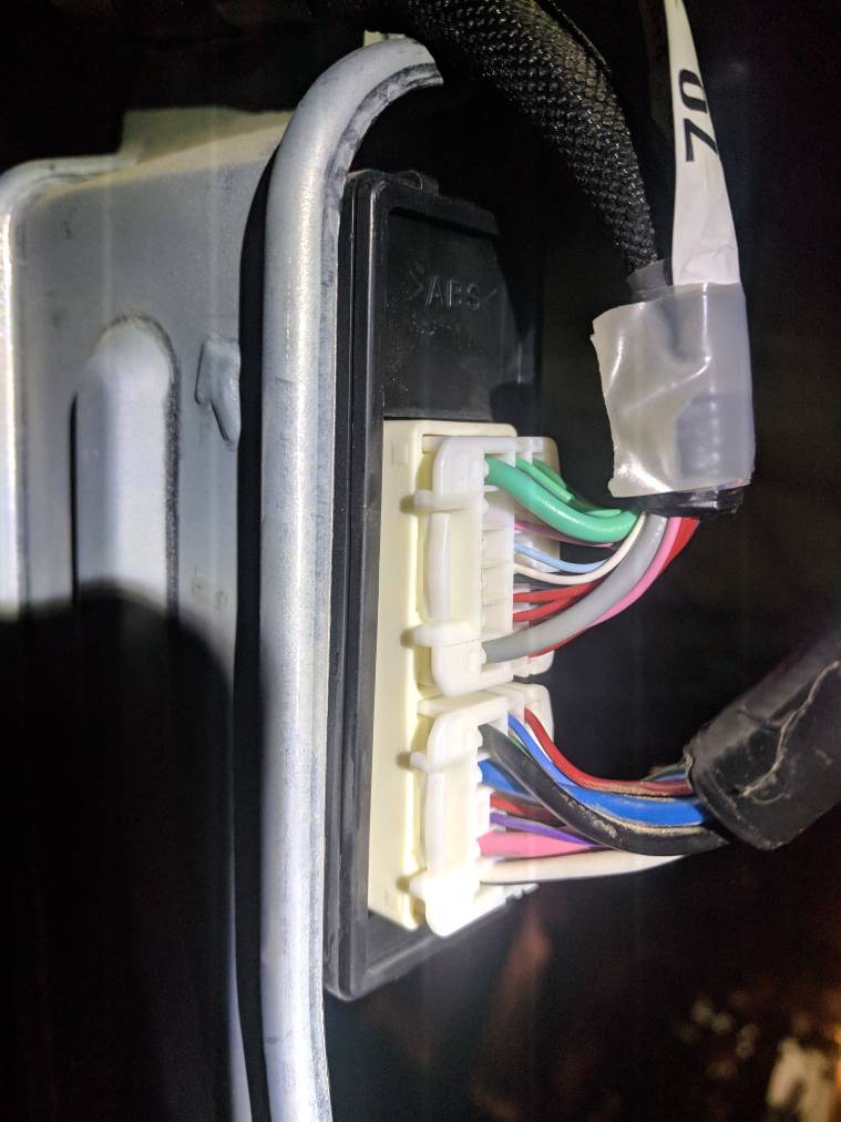

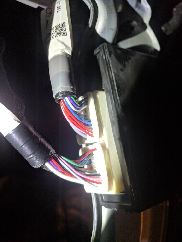

Thank you for the write-up and for all of the comments. It made this mod a breeze.
I noticed that most of the photos' hosting has expired, so I took a few photos during the process. I uploaded them to an Imgur album so hopefully they'll be around for a while. Cheers!
<blockquote class="imgur-embed-pub" lang="en" data-id="a/UanqIOy" ><a href="//imgur.com/a/UanqIOy">4Runner Interior Lift Gate Release</a></blockquote><script async src="//s.imgur.com/min/embed.js" charset="utf-8"></script>
Wire colors
It should be noted that on the 4th gen there is a light green and red wire AND a green and red wire. The GREEN AND RED worked for me and what is shown being spliced into in one of the pictures.
I was getting so frustrated trying to get light green to work!
