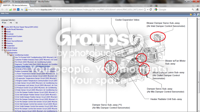

If it sounds like a pump it may also be a bad servo motor. There are three on that side and one on the driver side. I would try unplugging the bottom one on the passenger side, just remove that plastic cover under the glove box and you should see the plug. That one control the air mix for auto climate.
servo.png~original
