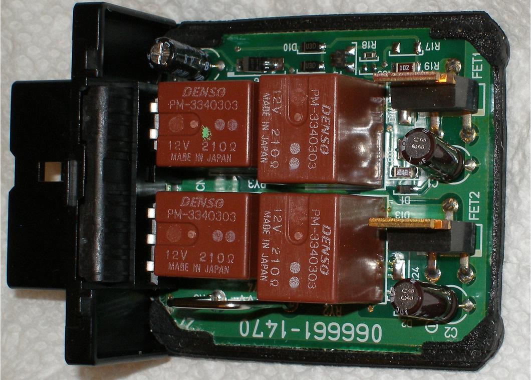

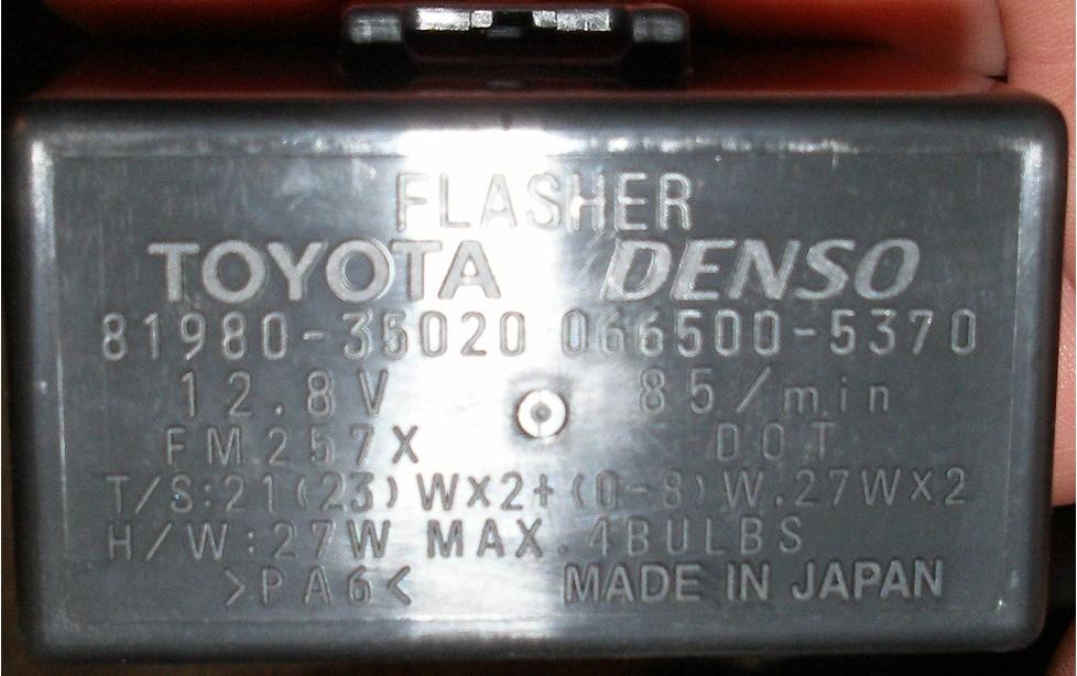

Relays draw minimal current, and can be "flashed". After all, our flasher units have 4 relays in them (I assume one per corner). It also says on the case "27 watts - 4 bulbs".
DRL flasher unit internals

The outer case

So I am like 95 percent sure that I figured out what the problem is. I was using the stock bulb with a super bright 26W standard 1156 bulb up top. I know for a fact that the DRL flasher is only rated for 4 bulbs @ 27 or something watts each. So having 4 bulbs up front, plus 2 bulbs in the rear is probably pulling too much current for the flasher/relay, causing it to overheat or overload, and shut itself down.
The reason you no longer experienced this problem is because you probably swapped to more energy efficient LED bulbs that BOTH pulled similar wattages to the single standard bulb.
