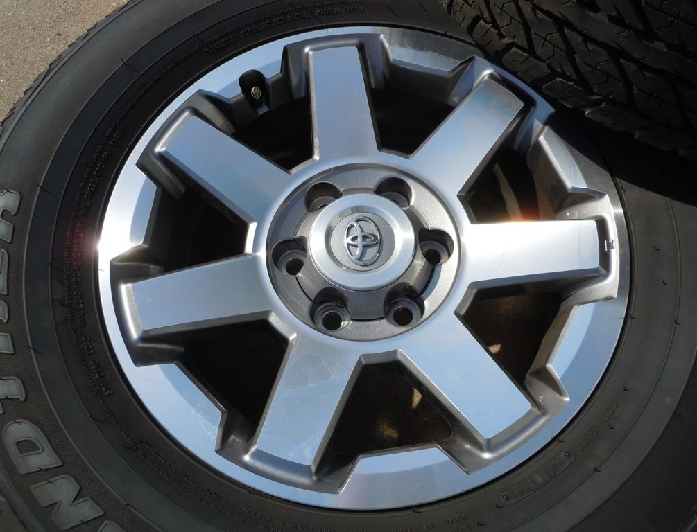

Hi All,
I purchased a used 2011 4Runner LE back in October and discovered this forum a couple of weeks ago. I've been lurking around and reading a bunch of threads and found a wealth of information. Thanks!
My 4Runner is currently stock, but you have inspired me to start working on some mods. My first mod is to change out the 20" wheels. I've read all the wheel threads I could find, and I think I'm suffering from analysis paralysis.
I found a deal on a set of new 2014 TE wheels with tires (all OEM), and I just want to double check that these wheels/tires will fit with no rubbing issues. With wider tires and wider rims, I need some expert advice.
I've listed the specs below:
Limited: OEM 20" wheels offset is +12
7 inch wide rim with a 4.5" backspace
Trail Edition: OEM 17" wheels offset is +15
7.5 inch wide rim with a 4.875" backspace
Any and all comments/opinions will be appreciated. Looking forward to more mods.
Sure...they fit. Here's a thread / poll where the LE wheels were swapped for TE wheels
http://www.toyota-4runner.org/5th-g...trail-wheels-poll-info-tire-wheel-weight.html
