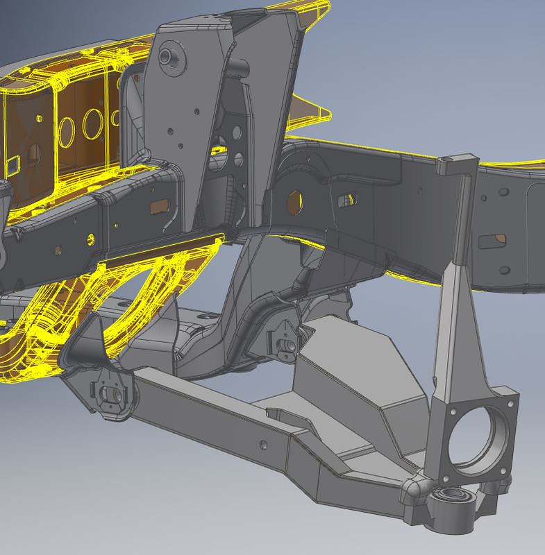

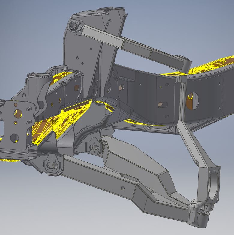

But as far as good news I think I'll take some measurements and start designing a better LT kit for my truck this winter. I'll coin it MZLT, (my initials lmao). Similar to RCLT, but I don't know about needing a full fabricated spindle; double shear steering and gusseting the stock spindle should be enough for me. Unless I can get more ground clearance or need to change the steering arm geometry for a LC200 steering rack.
I'll design it using 3D CAD, my full time job, and have it all laser cut at a local fab shop and I'll mig weld it. Trying to design it for maximum ground clearance, push the tire forward +2", +3.5" length, minimal bump steer and camber change throughout the travel, and max strength within reason. Wish me luck, it should be a fun learning process.

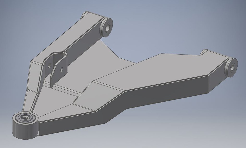

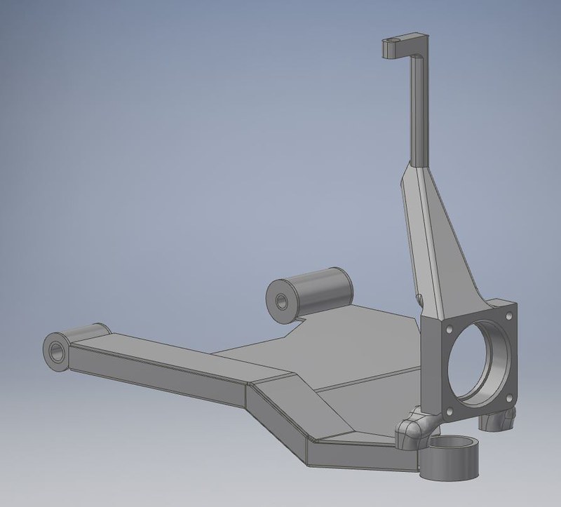

More rough sketching.

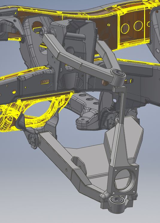

Still need to add shock mounts, finish the backside, add internal gusseting that slots into the top and bottom plates, and clean up bushing/uniball mounting.

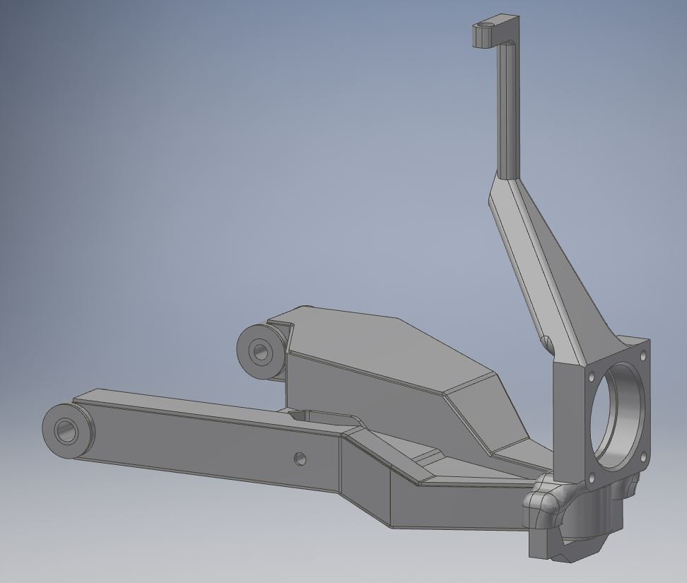

And UCA.

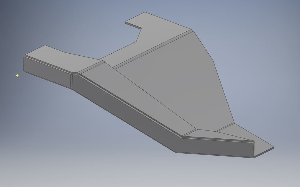

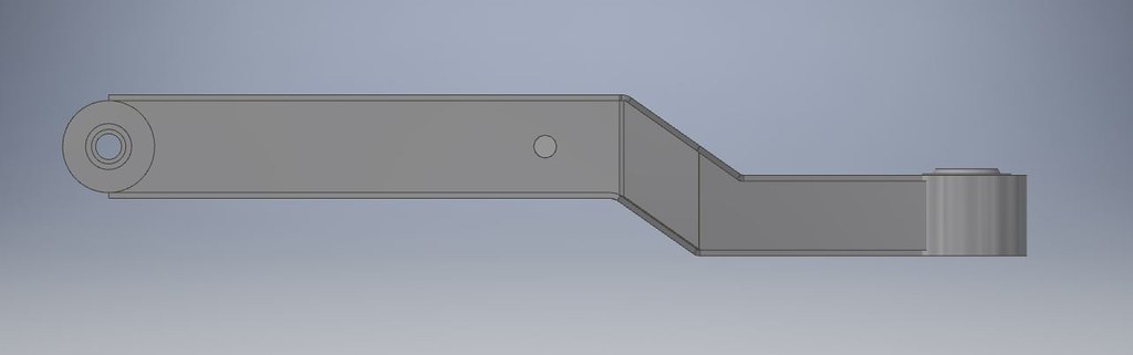

I'm at a design crossroad with my LCA. Should I make the lower edge a welded joint or a bend in the sheet metal? According to this Camburg video, a broke edge eliminates the chance of a weld cracking from hitting a rock. There are actually 4 good options:
-Inside corner joint. Where the lower plate overshoots the vertical plate 1/8"-1/4" and that lip gets welded. Like Total Chaos arms.
-Outside corner joint. The lower plate and horizontal plate meet together and get welded. Like most other aftermarket arms.
-Outside corner joint w/ doubler. Same as outside corner joint but with an added plate that wraps around the edge to protect it. The weld will have to lie flush for this to work well without a gap.
-Broke (bent) sheet. No weld
I think I might try to tig weld these arms, we'll see once I get more weld practice in.
#3 IMO.
If the weld isn't flat, grind it till it is.
That is awesome progress on the design man, kudos.
The couple of different DYI LT designs I've seen (many of which seemed to get some pretty decent hard use out of) all went with a welded joint. If you have a good, hot, penetrating weld, you're not going to break it. Plenty of other weak points to give first. The simplicity of a welded joint vs going bent sheetmetal wins for me hands down.
On a side note, I am still undecided whether I want to go solid axle or LT up front.. but in the process I have acquired a front end frame cad model (basically bought it second hand from a guy who did his own design as well for $40 bucks, he paid 100 so I figured it was reasonable) shoot me a PM if you're interested and I can get it over to you if you need to mock your design up using it. I haven't done much with it yet but does seem fairly reasonably accurate and he built his entire LT kit around it so must be close at least.
Looks like your using Solidworks, or am I wrong? Really interested to see how this is going to turn out for you. Absolutely LOVE dyi projects.
I'm just thinking over time, dragging that weld or lip over rocks might lead to wear or possibly a crack that propagates. I've seen a raptor arm constructed this way and that Camburg arm. I figure I have plenty of time to design whatever I want and plenty of time to practice welding that I should do it the best way possible.
I havent even mentioned using chromoly vs a36. You see both used in aftermarket arms.
I'm using inventor at work on lunch breaks. Fusion360 I think is enough different that I didnt try drawing this at home.
Definitely valid points. If it were my build I would just skin/skid the arms and send it. But I guess it also depends on the intended use. If you plan on being able to use the arm fairly often to slide over rocks it could be reasonable to fear it wearing down the weld and cracking. However, with a weld and regular inspection, you could always knock it down some and reweld, whereas if it were not that way and you slid it a few time and started eating away its no longer the weld you're chewing up.
I agree that the material decision is probably more of a biggie to settle on considering the pros/cons of each.

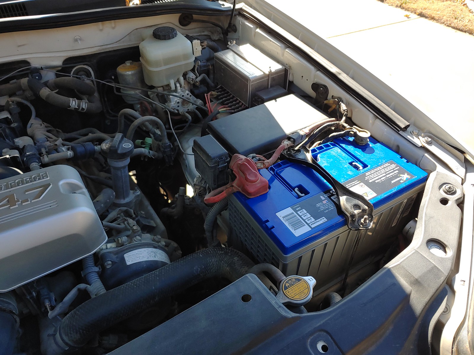

Been limping the 4Runner along the past couple winters with a questionable Northstar battery. A couple weeks ago it wouldn't even turn over after a hint of cold weather. Nobody in town carries Northstar/Odyssey batteries except for one place that didn't have any in inventory the correct size.
Did some looking and drove 1.5 hrs away to pick up a X2Power 27f, rebranded Northstar but with a 5 year warranty, and cheaper. Didn't want to order it online I wasn't sure how the warranty stuff worked going that route. Stock plastic battery tray is getting squished....
X2s are good batteries. I have one of the starting batts in the 4th gen, and 2 in the 5th gen, one starting and one deep cycle for the house battery.
Just have to keep them topped off with a charger every couple weeks when not being used. They don't like to sit. I put a cheap solar panel on the 5th gen to help with charging. Seems to work well.
Also bought the alternator voltage boosters to accommodate the higher charging requirements of the AGM.
I've beat up so many batteries over the years, I wanted to try to have more reliability in these two rigs.
