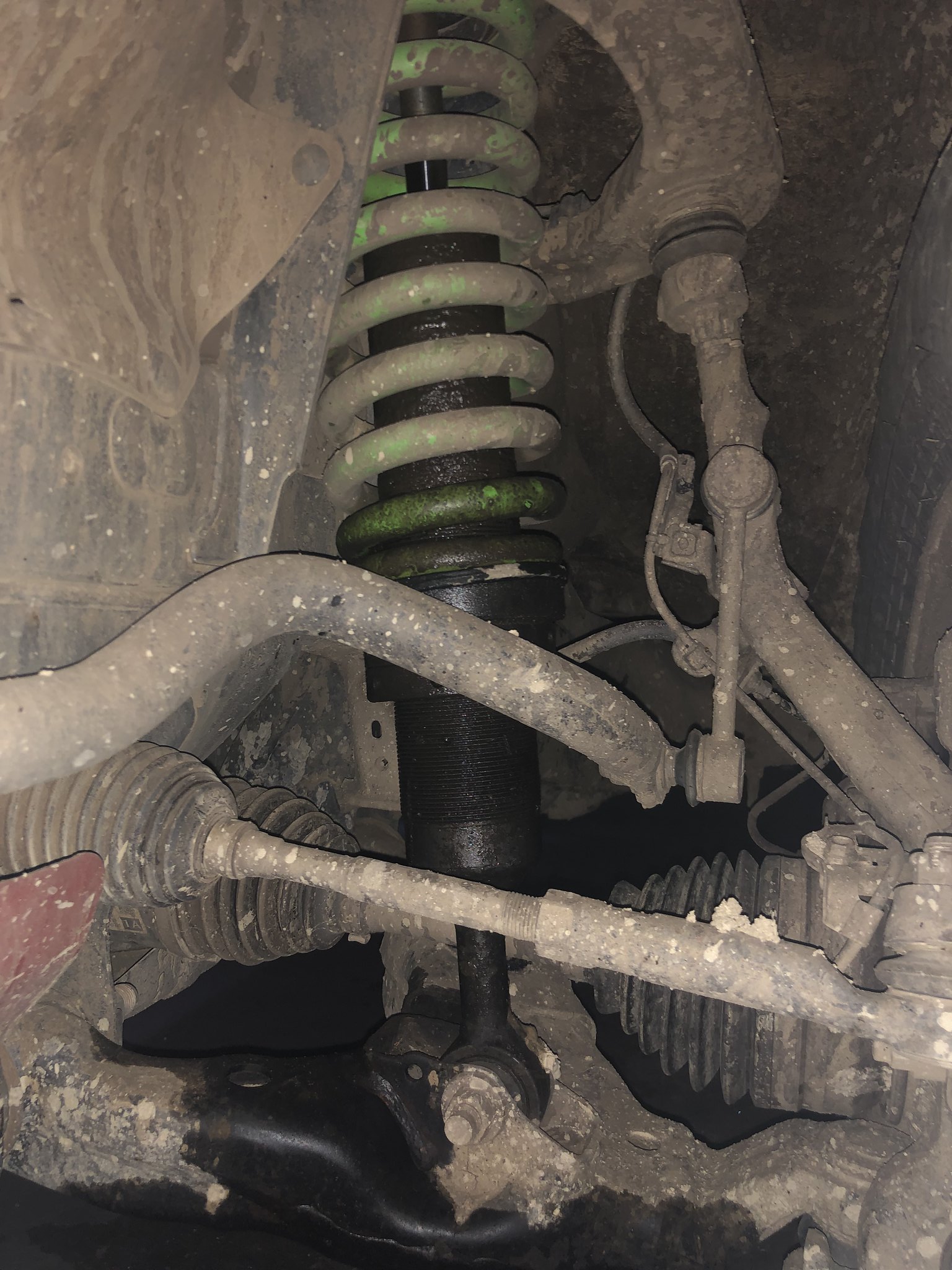

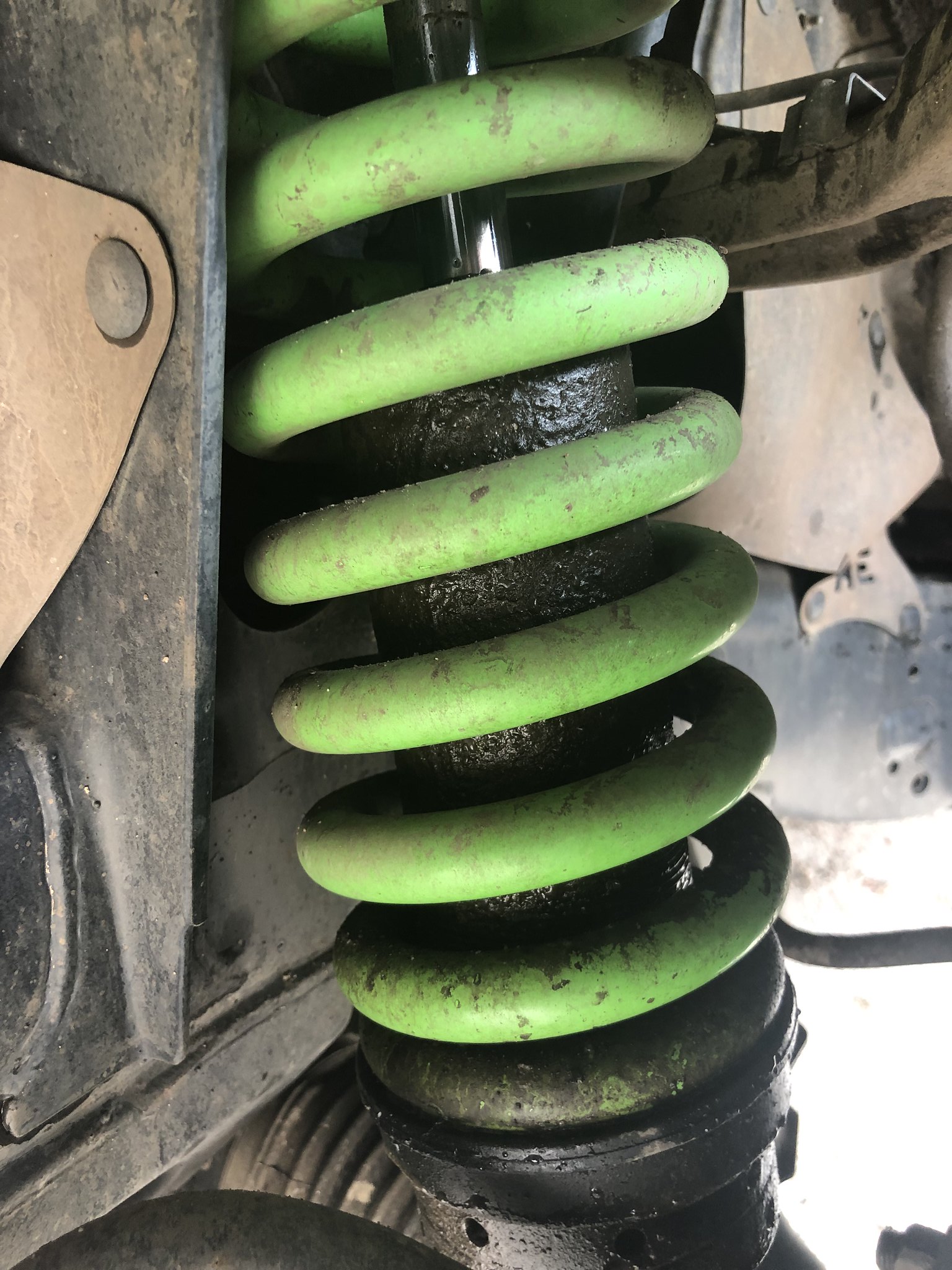

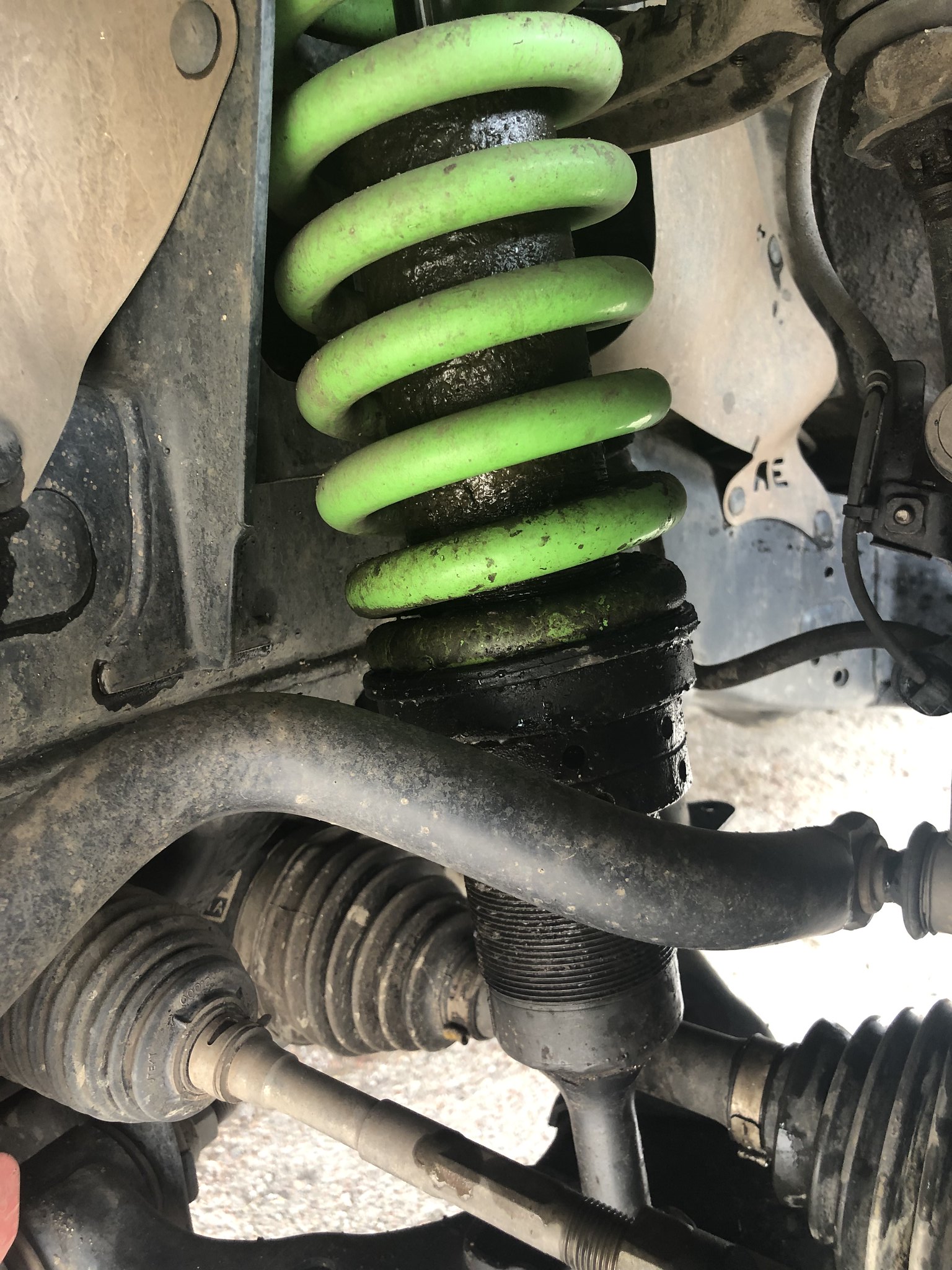

Just got back from doing a 1k mile camping trip and noticed that my LCA was black when it should have been covered in mud. I also noticed the shock body was also black and looked to be covered in grease. I emailed Ironman yesterday(Sunday) and they got back to me today. They asked for pictures, which I provided and they immediately stated they would be sending me a new strut. No idea when or where the shock started leaking, but I can say the ride quality never diminished with the oil leaking. Basically this is what the email stated "we'll get a replacement strut (45710FE) sent your way soon! Your Foam Cell Pro should be fine driving on until you get it replaced... one of the benefits of having foam." I am pretty happy with Ironmans Customer Service. They were easy to deal with for sure.

Cleaned it up a little bit for better pictures

How many miles total on that suspension so far? That’s great customer service.
Without looking at my records...15-16K miles. I was a little bit nervous after hearing about Bilstein and Toytec deny warranty claims. They didn't ask about off-roading or anything. Just sent a picture of the strut body and they approved it within an hour or so. Got the shipping notice this morning.
