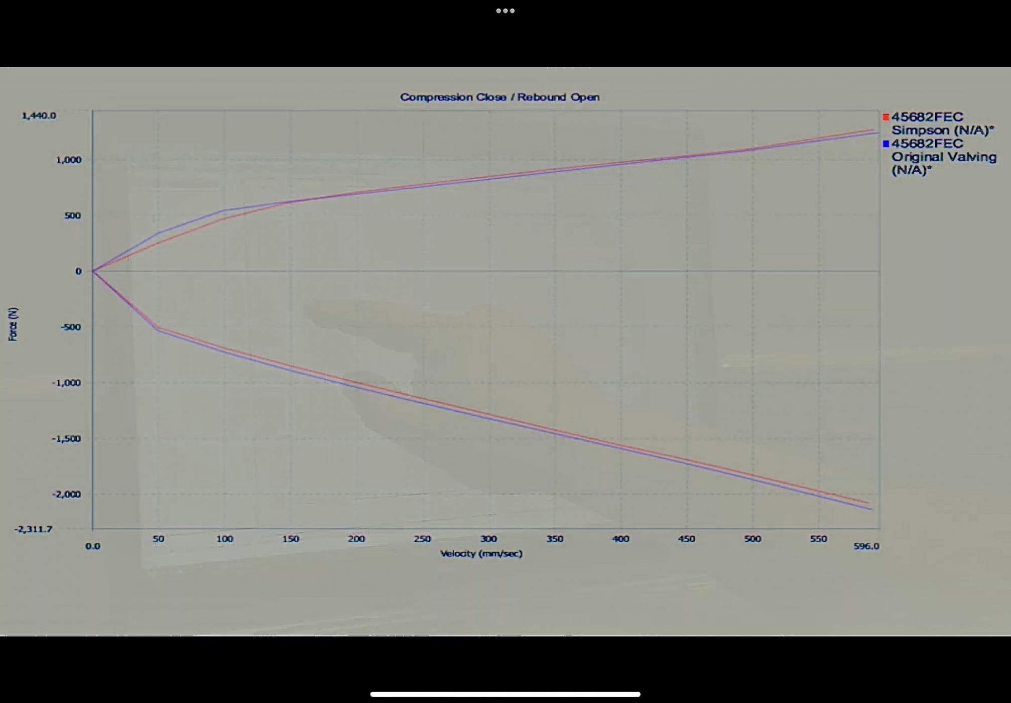

Anyone know the profile of the valving in these? Progressive, Linear or Digressive?
Since they are not pressurized I expect the valving can be changed to your preferred profile.

From a manufacturer YouTube. My guess it is a linear valving. It was showing how the shock performance changed after a run through Australia Simpson Desert.
