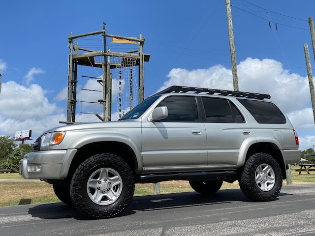

Ironman suspension. 70K miles
Love this Australian product. 70K miles and counting
