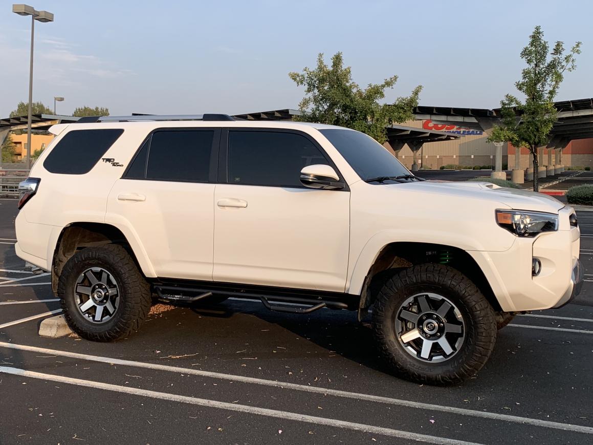

Ironman Foam Cell Pro
Where did yours end up settling?
Also, did you buy their adjustment tool or buy a spanner wrench? I chose the latter.
Here were my numbers:
Stock/Day Of/Final
DF: 19.5"/23.5"/22.5"
DR: 21”/24 1/8"/24"
PF: 19.5"/23.5"/22.5"
PR: 21"/24 3/8"/24.25"
I haven't bought either one. We thought the Dobinson one might fit and didn't. But I haven't had to make any adjustments.
Stock/Day Of/Final
DR: 21”/24 1/8"/24"
Wow- four inches in the front right after the lift. Between the lift and my Gobi rack I'm starting to get worried that I may not be able to get my 4runner out of the garage after the lift. I can always air down the tires but I need to get out there with a tape measure to see where I'm at.
Let me know if it fits. To lower my 4Runner I adjusted my springs over the weekend with the Ironman tool. I did have to use a pipe wrench for leverage as the tool is too short.
I wish the tool would have a square 1/2" hole for a breaker bar instead of 10mm and 11mm hex holes...
So the 8mm peg on the wrench I bought is too large. I will be exchanging this for one that is 6-7mm.
Look for a wrench that has a square 1/2" hole to get a min 20" breaking bar to use it for leverage.
And I've been looking for a solution to use the hex holes with a hex bit socket and a breaking bar for leverage. Using a heavy pipe wrench for leverage sucks.
I received my hex sockets. I thought the socket size is measured on the hex side not diagonal... 14mm and 9/16" is too small. Measuring with a school ruler, I get 20mm and 21mm diagonal.
It settled to 3" all around. Definitely sits tall.

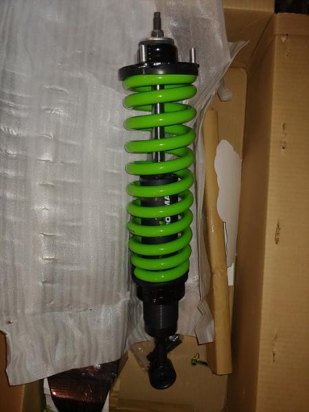

So I received my lift today and upon inspection I noticed a couple things that worry me..(I opted for pre built coil overs)
First was the coil labeled “driver side” was actually set lower than the one for “passenger “. Opposite of what they should be to offset driver side lean. It could be that they mixed up labeling the boxes. But I am not about to take my suspension apart to find out it is wrong. Secondly the coil for the “passenger” assembly is seated significantly further from the perch than the “driver” set. It’s about 0.6 inches off as where the “driver” side is lined up snug. Is that acceptable/safe?
Where that coil sits is perfectly safe and acceptable, it’s got that taper to sit reasonably level at the bottom, and yours is flush. Looks great.
As for the driver vs passenger, don’t forget, these are built in Australia, where they drive on the left. Reverse for USA install. **They do mention this in one of their videos.**
First was the coil labeled “driver side” was actually set lower than the one for “passenger “. Opposite of what they should be to offset driver side lean. It could be that they mixed up labeling the boxes. [...] Is that acceptable/safe?
On the driver side (the coilover from the right), I would be concerned with the first coil touching the top edge of the end of the coil (looks like there is probably only 1-2mm space. If they touch that could destroy the paint and allow rust to get a hold on the coil...

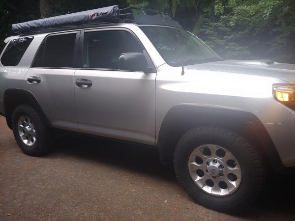

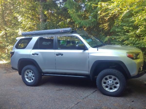

Ironman install completed....
Before:
After:

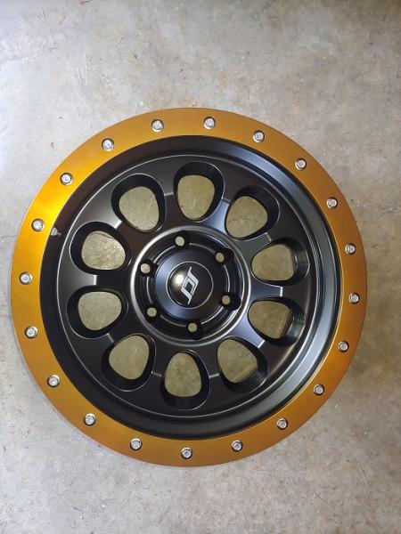

Man those 265/70's look tiny.... Off to Discount tire to have the 285/70 Coopers on my new SCS wheels mounted.
FYI.. The install was almost drama free...... I was tired and F@*'d up on the last bolt of the install. I cross threaded the KDSS cam shaft looking bracket so I had bunch of fun extracting the snapped bolt and re-taping it and then finding a bolt that matched.
