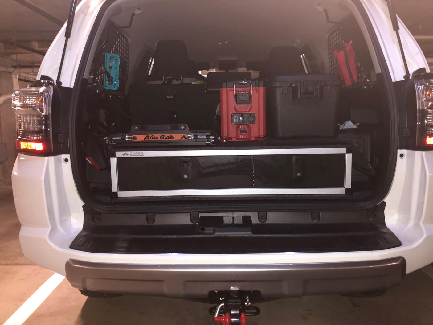

I built mine externally and made it portable so that it could be used outside of the vehicle with solar charging to keep it topped up. Used a LiFePO4 from Battleborn, and a Milwaukee Packout tool box as you can get aluminum mounts for it which I have permanently installed in the back. The packout latches on and can be removed and carried. The only thing that lives externally to it is the DC-DC charger which is permanently mounted in the vehicle since I don't have a need to take the entire setup and use it on another vehicle. I like this much better than the second G-34 AGM under the hood because those kits can be quite expensive, and you a fairly small aux battery. I didn't use cheap components but the portability alone is worth it and I can just remove everything and store it when not in need.

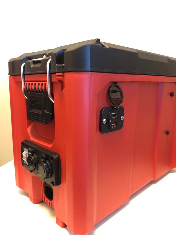

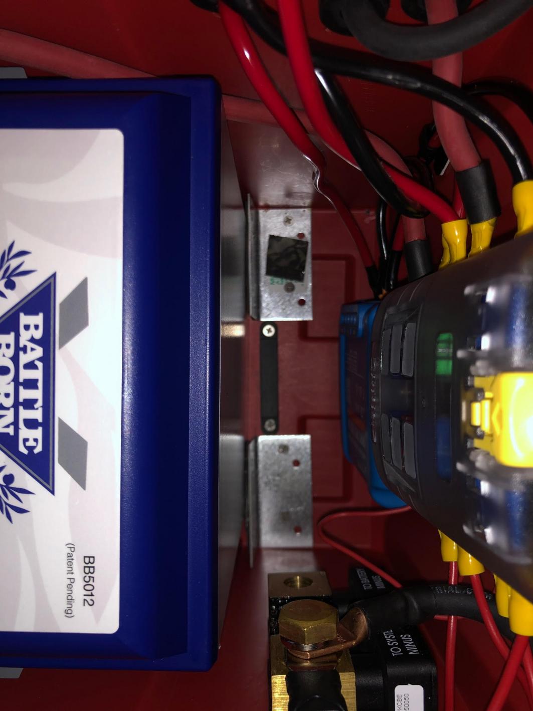

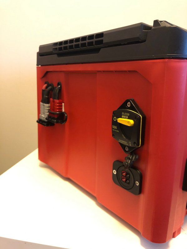

Yes sure. Some additional pictures o of the box and the mounting system.
The parts that I used:
1) Battleborn 50Ah LiFePO4 Battery
2) Renogy DC-DC (20A) Charger which lives outside of the vehicle (it has user selectable voltage which allows me to get exactly 14.6 into the BB)
3) Blue Sea 6 circuit fuse block
4) Blue Sea terminal fuse (40A)
5) Eaton 50A Circuit Breaker (panel)
6) Victron Smart Shunt 500A (Bluetooth only - no panel)
7) Victron MPPT (10A)
8) SB50 Anderson connections - Red for solar which plugs into MPPT (uses 10 AWG cables) and Gray (uses 8 AWG cables) that can accept the DC-DC charge or can be used for any other power need that requires higher current
9) Panel mounted Powerwerx PanelPole that accepts two Powerpole connections. I use one for my N. Luna fridge, and the other is permanently connected to my Noco Genius 10A
10) A Blue sea panel (USB and Cig port)
11) A Powerwerx supplied panel mount for USB type C
12) 10 AWG, 8AWG, and 12 AWG cables and connectors as required
13) Fuses sized for the application and wire size chosen - The BB has a 60A max continuous BMS and I also use a 40A terminal fuse. The DC-DC (20A) has a 30A fuse at its power source (a blue-sea panel that I have mounted in the tire-removal kit compartment)
14) I used ferrule connectors for all connections going in to / coming out of the MPPT and copper terminals for everything else

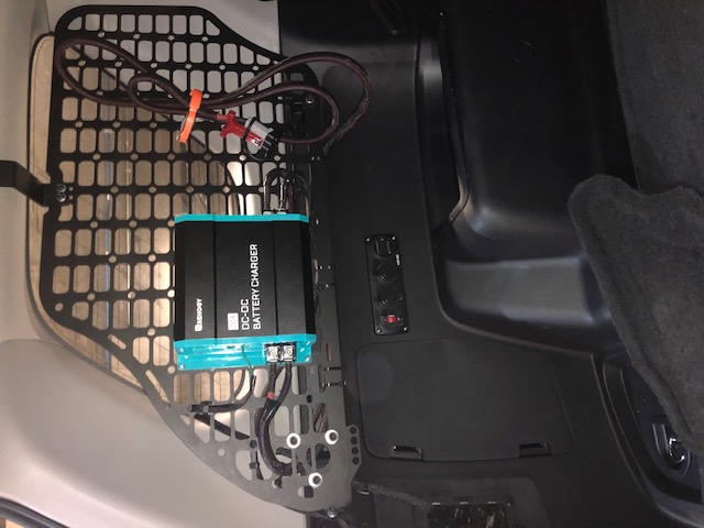

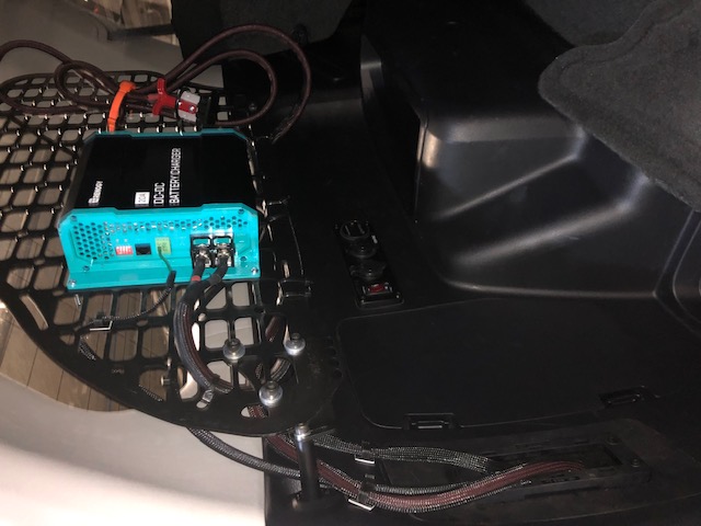

Everything with the exception of the Renogy DC-DC is mounted in the box. I had plans to mount a DC-Dc inside the box, and the box can actually accommodate a Victron DC-DC inside (a friend over at Expedition portal who worked with me to do a similar build went that route) but I chose to go with the cheaper Renogy option and mount it outside - It has worked great over the last 10 or so months. The red plate is what you can order for the Packout boxes (Milwaukee sells it in plastic but quite a few folks on IG or Facebook make these in aluminum or steel). I have mine mounted in the back on top of my drawer system. The battery is held together a few ways. I put Velcro at the bottom corners so that it adheres to the box. I then used brackets that you can see to hold it in place so that it doesn't move around. I also use a stra to secure it in place and between these three, it hasn't moved one bit in both day-day use in the back of the truck, or when off-road. The box latches shut, and it and the connection to the plate is strong enough that I have no problems storing stuff on top of and around it and securing it with a strap (the box is built very well and if anything is a bit of an overkill in terms of its size and strength).
