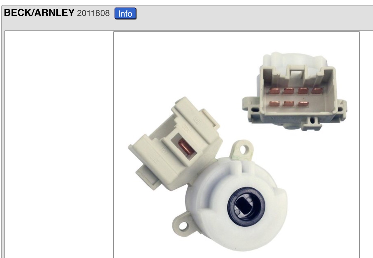

I replaced the contacts and that didn't solve my clicking issue.
1) Had the starter tested after the rebuild at Oreillys and the person said it passed twice
2) Tested starter relay by using one from a working vehicle but that didn't help.
3) used a different battery from another working vehicle and that didn't help.
Could it be my starter switch? Thanks.

Thank you all for the advice / help. Found the culprit. It was a bad connection from the positive battery cable. It was all corroded by the terminal connection. Previously my son changed the terminal post and I never bothered to check the wires connected to it. I assumed he cleaned up all that area thoroughly. After inspecting it and cleaning the wires of all the corrosion, the Runner started right up with one turn of the key.

No worries, after replacing the starter contacts and verifying that they were still good, I was tempted to buy the ignition switch. But glad I checked the wires / connection. Saved me $$$$.
