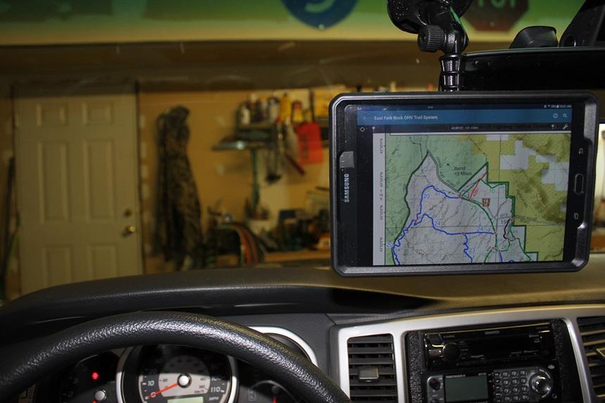

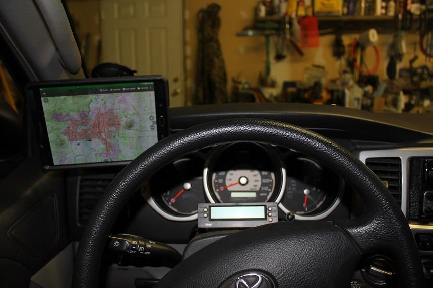

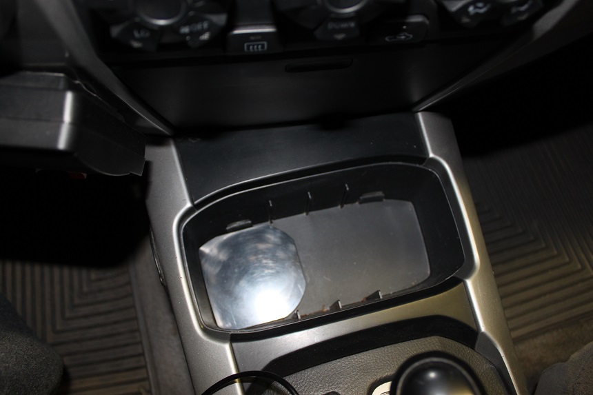

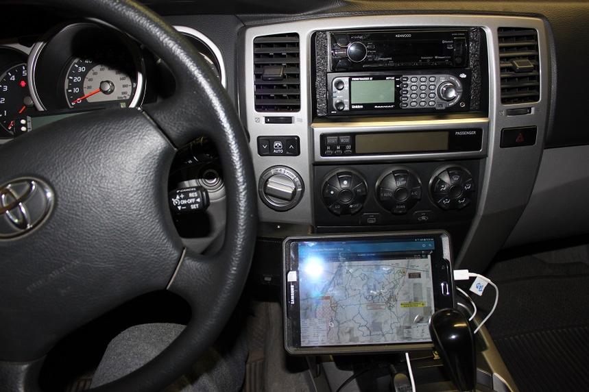

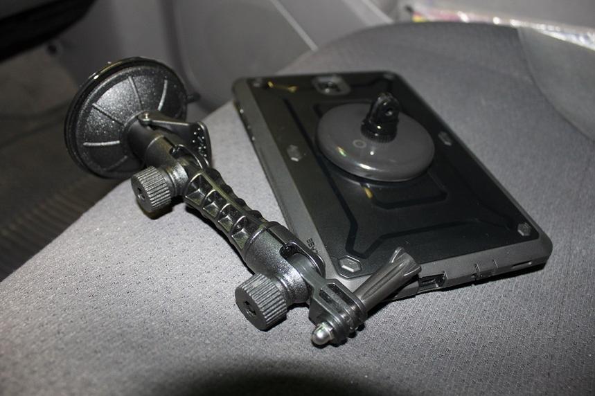

Just for fun.
For my Galaxy Tab s2 8"
I couldn't find a car mount I liked...on the cheap.
I bought a Supcase and Arkon suction cup mount.
Poured a 'puck' with a bolt embedded in it. (liquid 2 part plastic/standard camera sized mount bolt)
Also makes it easier to hold on to.
3M double sided tape to the Supcase.
Can stick it any where you like.
I stuck a flat plastic piece in the cup holder.
