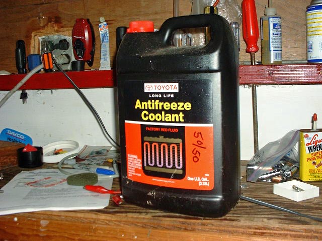

Is this the Red stuff you are talking about? I have drained and replaced my radiator four times with this stuff. Twice at 30,000 miles and twice at 60,000 miles.
Yes, that's the stuff. Toyota recommends leaving it in there for 100,000 miles! You don't need to change it every 30,000 miles!

I just looked in my 2003 Passport to Performance book, it is the scheduled maintenance guide that comes with the vehicle; and it states that coolant should be replaced at 30,000 miles intervals. Mine was filled with Factory Red Long Life from the factory.
I buy a gallon of the Factory Red Long Life and then cut it with distilled water from the grocery store. Once I do this I write 50/50 on the gallon so that I do not get confused in the future. The pn# is 00272-1LLAC-01
The price is $19.29/gallon
