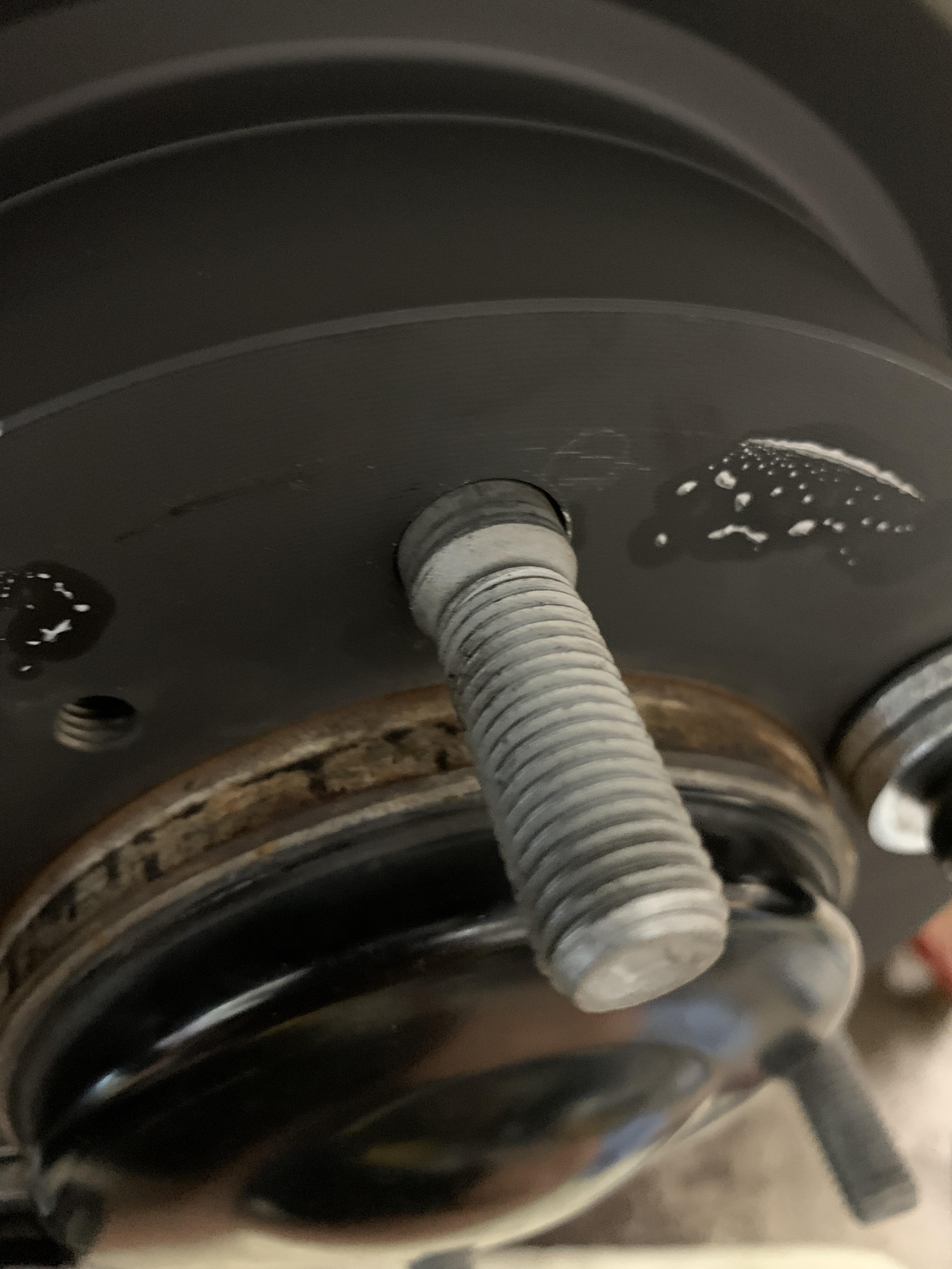

Is the lug nut thread engagement sufficient??
ragin_cajun
Mounting up some Icon Alloy's that are hub centric and purchased the lug style that is recommended by Icon. Went with Gorilla 21133BC 12mmx1.5 - 1.36" length - non ET
To me this thread engagement seems short. There are certainly some valid concerns running ET and Icon specifically says not to. Should I be concerned about this?

I hear ya, I've been reading and searching. Not trying to be the guy that asks a question with a super obvious answer. Every thread has contradicting information and turns into an ET vs non-ET debate. I'm asking on here, as I know others here are running Icon's.
Lug nuts are engaged for 6 full rotations, that's just not enough. Based on what I can measure with a caliper I'm getting about 10mm of engagement.

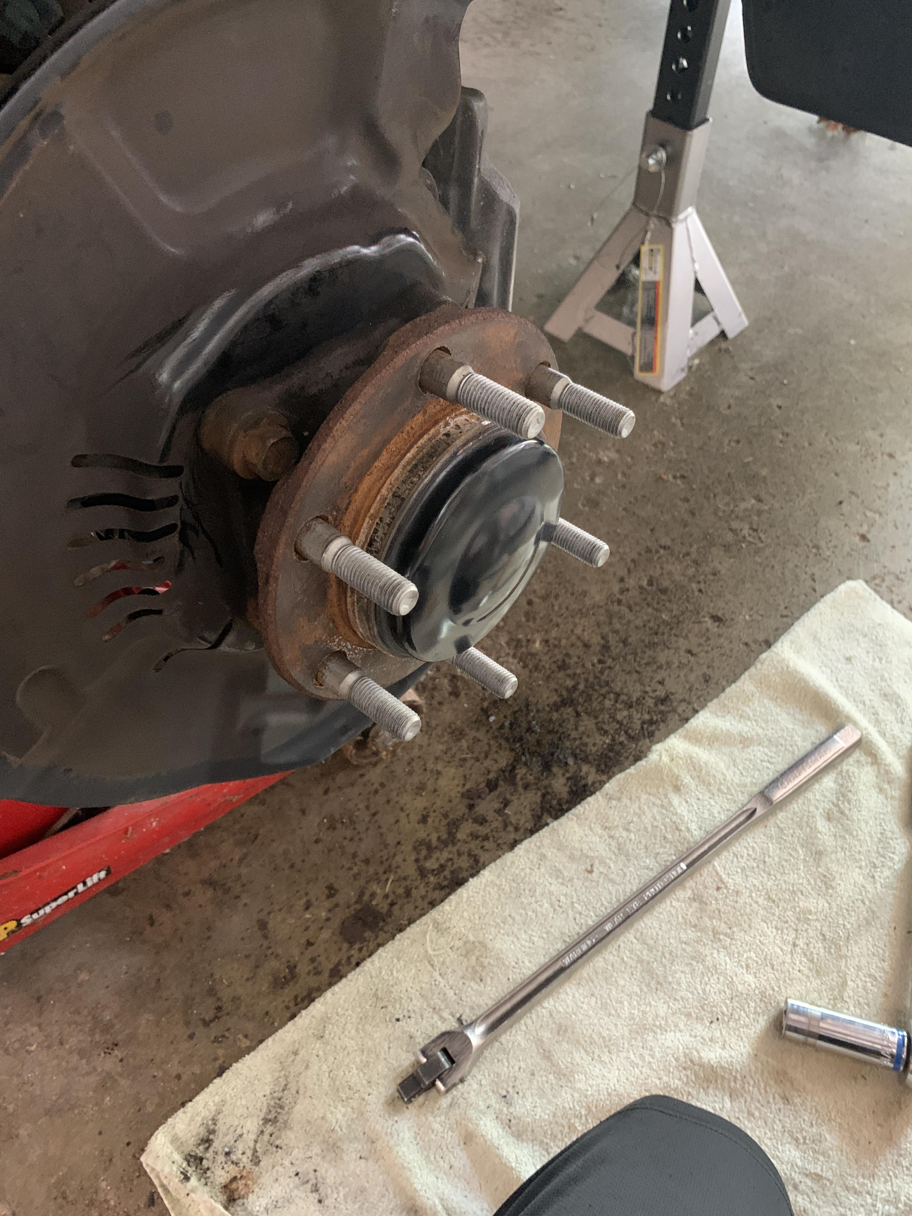

6 rotations sounds a bit short. I had to swap out my lugs when I bought my wheels. It was easy to swap but a pain because the lugs you can buy are too long so had to cut them down first. I forget the aftermarket name but they are high quality for racing and supposed to be for a Lexus. So, at least I was able to get rid of the cheap easy to break Toyota lugs. All that is for the front. The rear had enough engagement so I did not swap those, plus with the rear it is tricky to get the lugs pressed in and out.

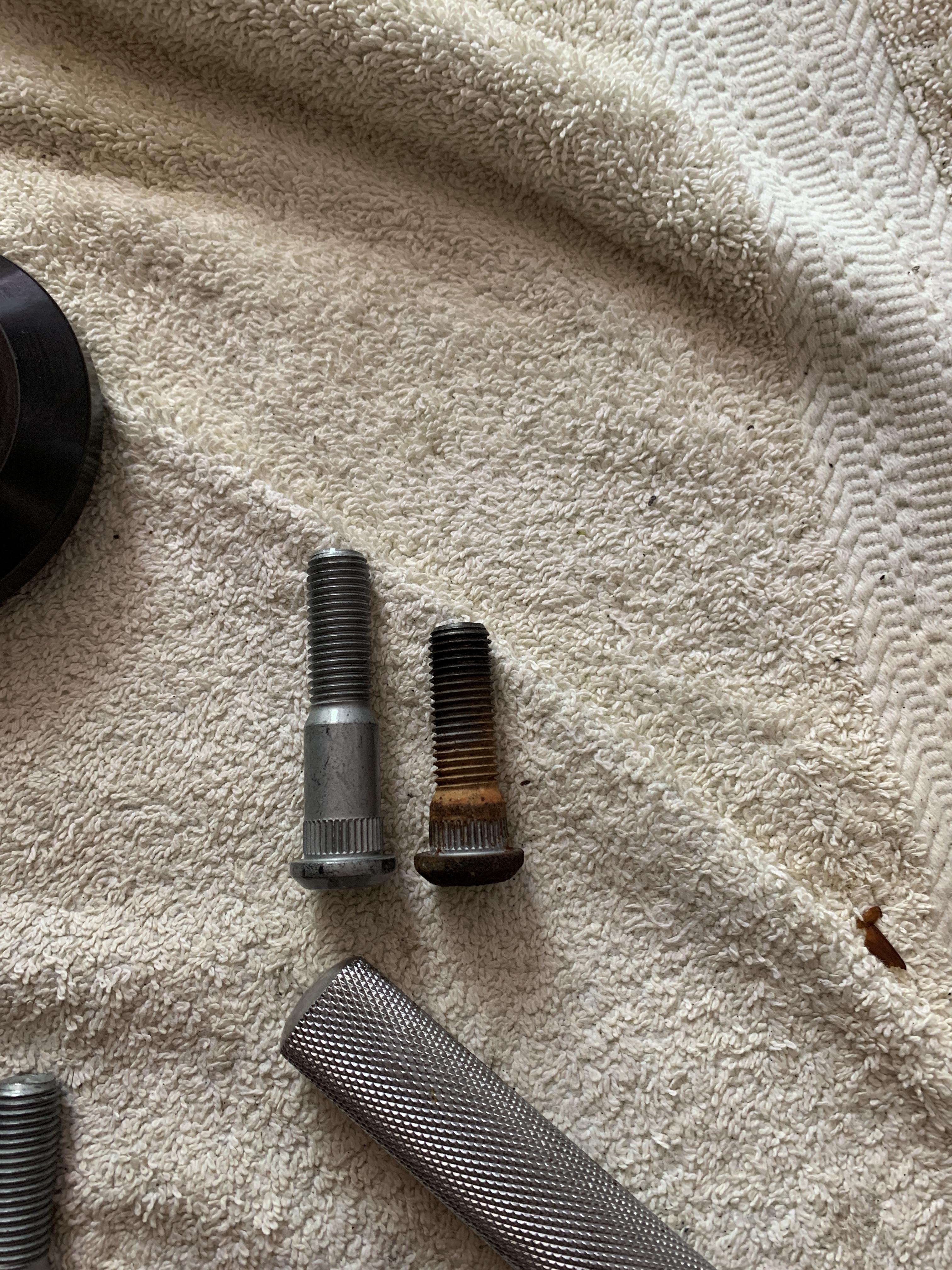

The front studs are too short for use with aftermarket wheels, IMHO. You can replace them with the longer studs for the rear axle.
For proper engagement on aftermarket wheels I would replace with longer studs. I believe the rear 4runner studs are a little longer or do what I did and replace with Matrix studs from the 2008 AWD model. I believe they are 55mm in length. Same size as ours just longer. It doesn’t take long to change out studs on our front end.
