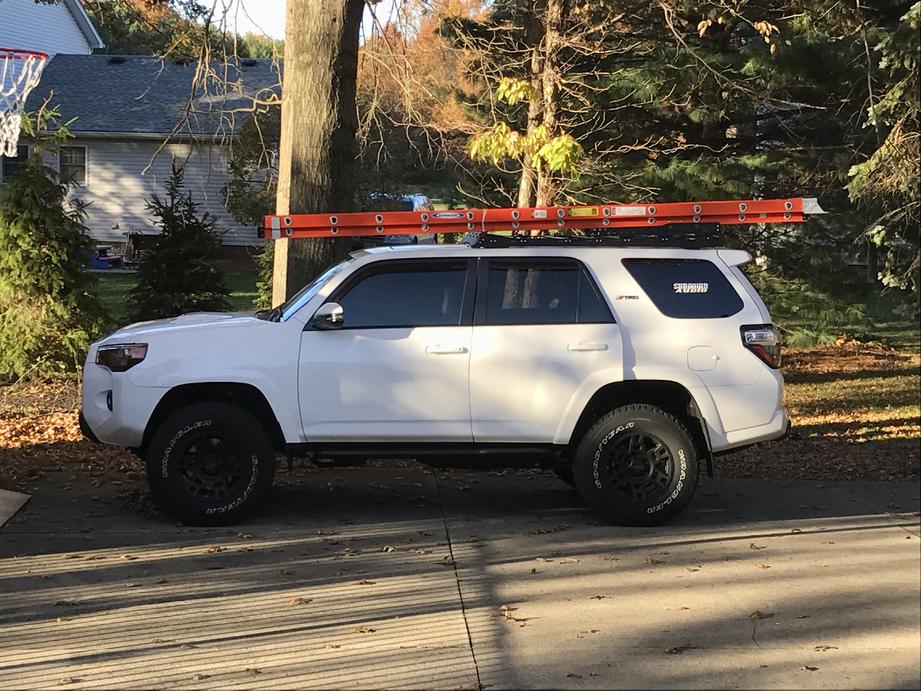

Front is set at 1.75". I want to keep about 1" of rake so 1.5" in the back should be perfect. Here it is with 1.75" in front and 10mm OME spacer on rear springs
Looks great! Looking forward to see the updated pics with SAW. I'll be setting the front at 1.75 as well since I want to keep the rake. Install will have to wait a bit though due to newborn and in-laws will be in town.

I am running the billy's at 2.5" and have the OME 895e on the rear. although the pic does not do it justice I feel the rake is factory or more...I would love to get it back to level.
My original mod set up was billy's at 1.75 and stock in the rear but the OEM springs sucked for loading anything of substantial weight. After reading several reviews and searching the forum, I decided that the 895e would net me the least amount of lift in the rear, while giving me the stiffer coil. I moved my fronts up to the highest setting and added the Old Man Emu coils. I am still ass up.
