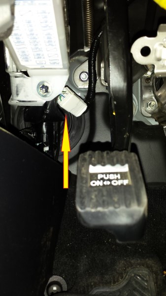

Even easier if you order the Toyota specific harness/adapter with your brake controller. Just plugs directly into the Toyota trailer wiring receptacle, up in there to the left of the parking brake pedal. Other end plugs into the controller. I didn't use the Toyota supplied pigtail at all - just plug and play!
Here's a pic...........

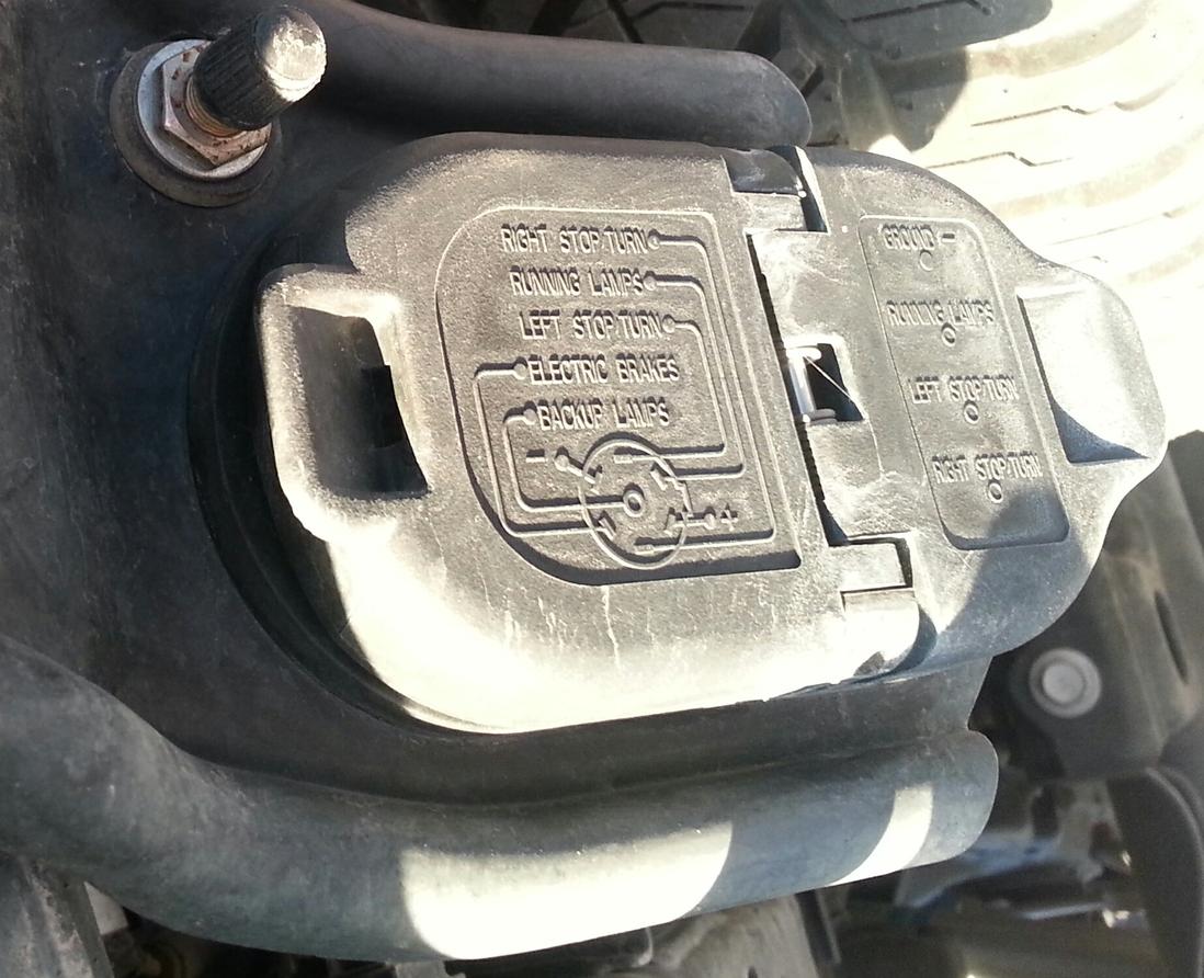

And if you need info for the other end ---

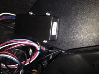

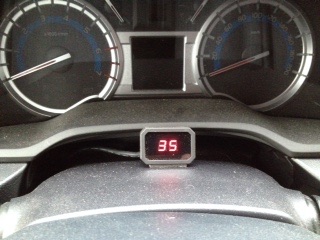

Finding a place for the controller where it will be easily accessible, yet not in the way, is a bit of a challenge. I chose the Hopkins InSight Flex Mount for that reason.

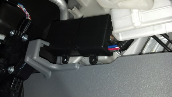

The main unit is mounted out of the way, and out of sight, up on the wall just above and in front of the emergency brake pedal.

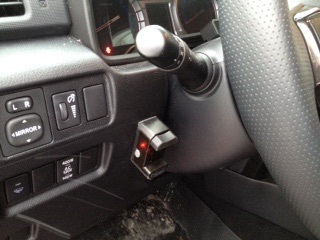

The hand control is just to the left of the steering column, on the dash. Easy to reach while driving, but not in any danger of getting hit by a knee.

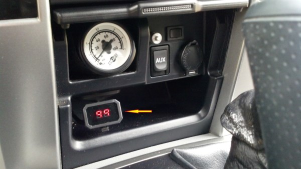

The info screen is on top of the steering column, just below the dash instruments. Easy to see, without really taking your eyes off the road much.
You don't even notice the modules when you are in the car. All wires passed easily through the gap for the steering column - no drilling or cutting required.
Clean install!

[MENTION=113792]Raven[/MENTION],
I call your control box...........
and raise with a display and manual slide control....lol
Sounds cool, barryhiram, but I tried the links and got "invalid attachment" notification .....
Edit: OK, images came through on second attempt.
I do like your install - both slider and info. display screen in convenient locations.

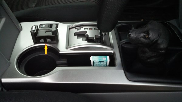

I did not have to do any cutting, drilling, or removal of center console, and I still get to use my almost useless little cubbyhole for other stuff - so, I guess I am calling your bluff, and raising you three packs of bubble gum and a used toothpick!
