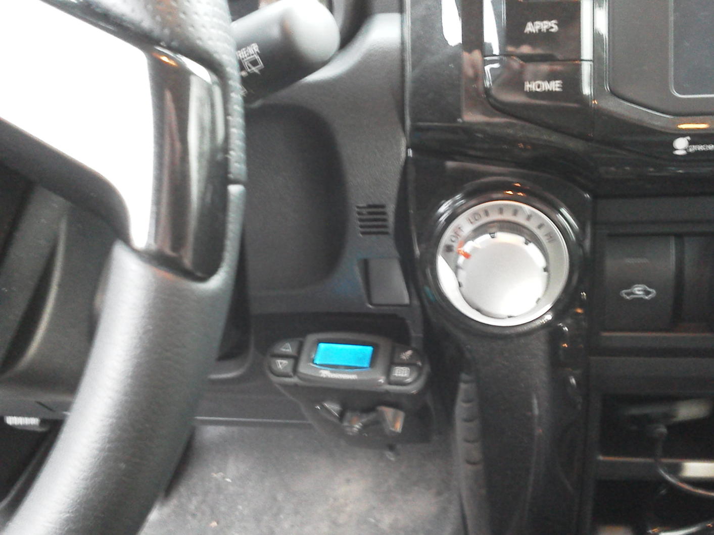

What brand did you buy, the Tekonsha P2 and P3 do not have to be mounted level and can mounted with Velcro just about anywhere.
A Big Thanks to [MENTION=87461]badhabits[/MENTION] for the Velcro idea. It worked perfectly:thumb:

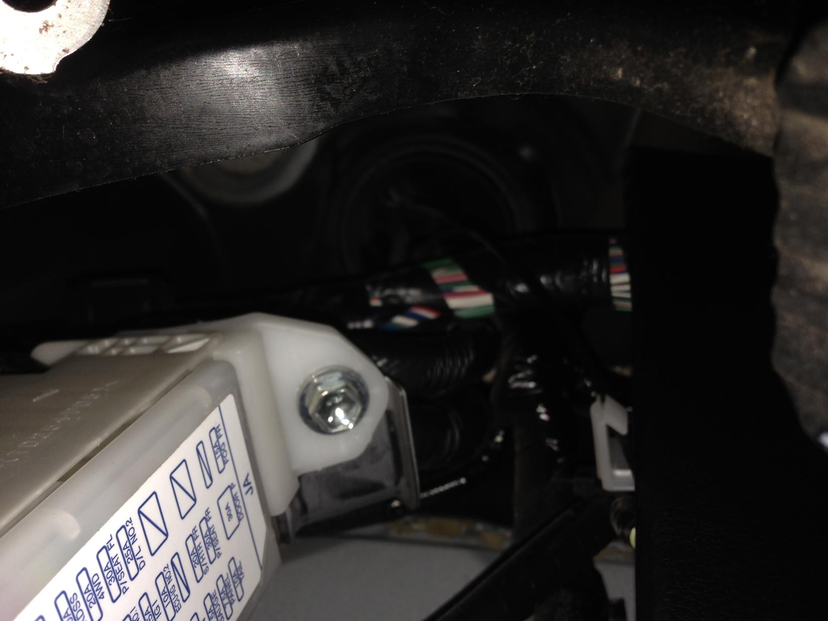

It's an old post but I can't seem to find the plug either. I have the plugs in the bumper for the lights but no wiring for the brake. I bought my 4Runner used and it didn't come with the pigtail thing but I thought I'd at least have the stuff under the dash. Any thoughts? Hopefully my pictures worked.

Plug should be taped to main harness behind BCM pictured, just follow harness upward and it should be there.
No need to purchase pigtail from Toyota, generally brake controller manufactures offer adapters that are plug & play. Here's one example for 2010-2013 4Runners from Hopkins........
