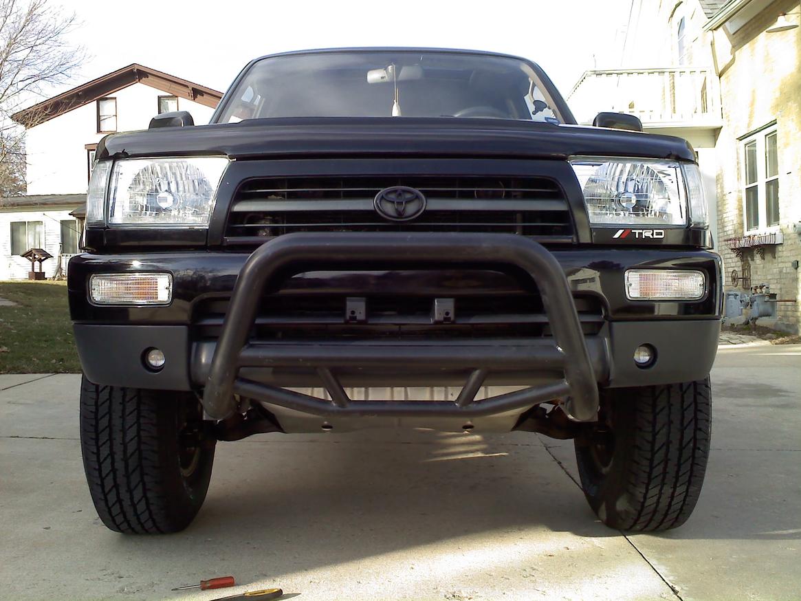

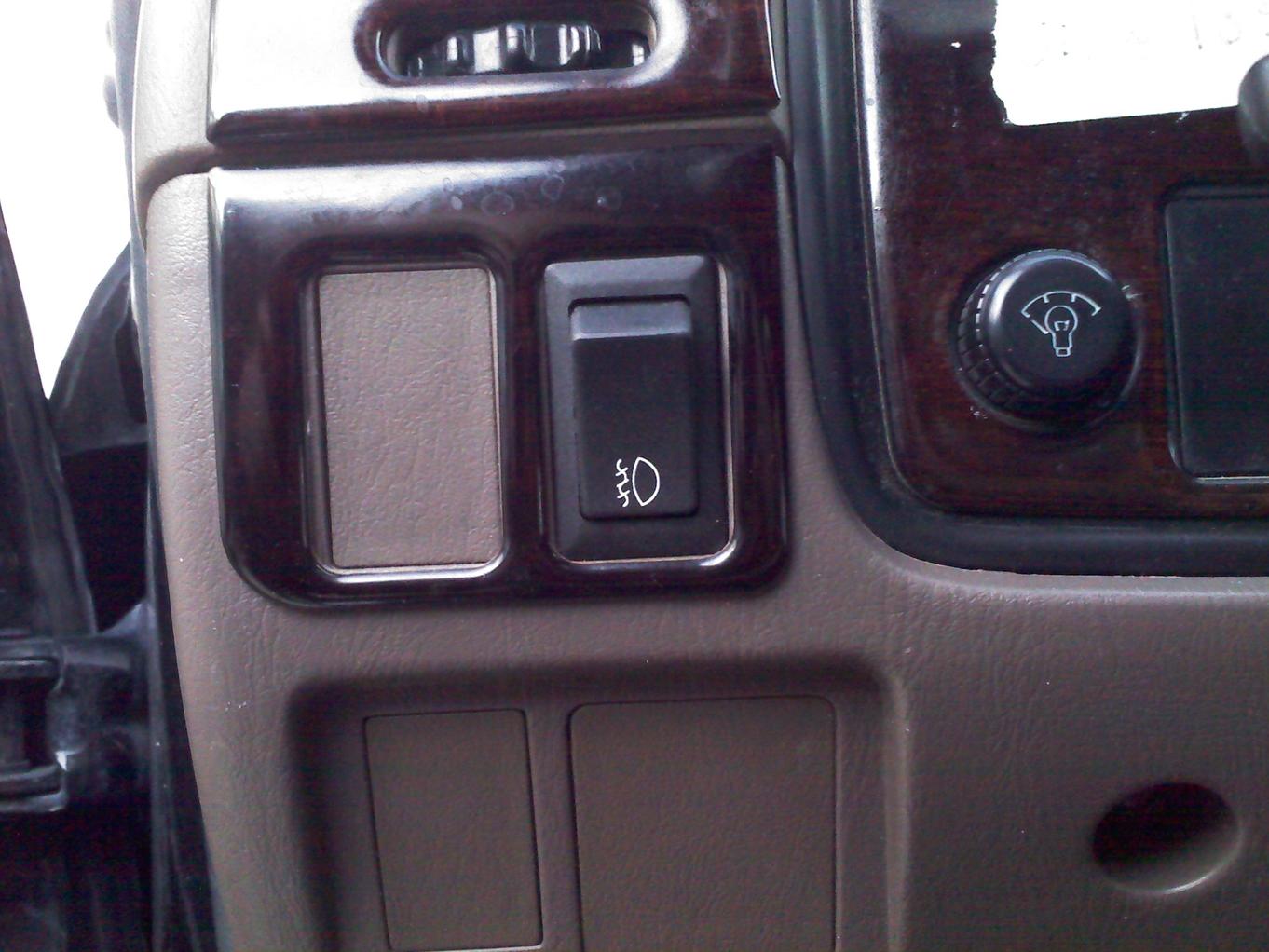

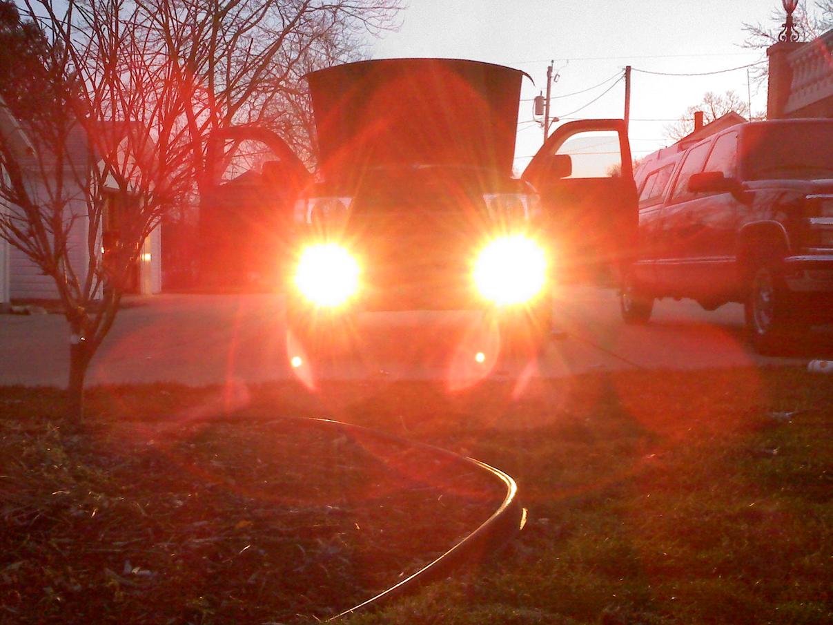

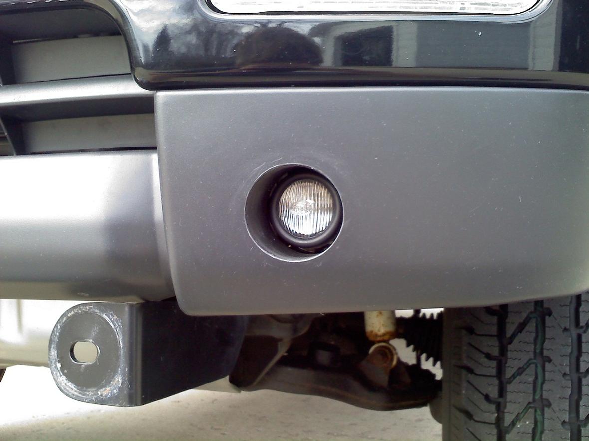

This past weekend I custom installed Hella Micro DEs into my 98 bumper valance. I just wired them to the ignition. I had absolutely zero experience with lighting/wiring. But with some instruction and once I found the right wire it was pretty easy. I can turn my fogs on anytime at the flip of the switch. When the truck is on or off, headlights on or off, high or low beam. Any combo. I love it! I know this doesnt really apply to you guys with 99 to 02 runners. Just wanted to share my excitement about my new fog lights!
The switch
Custom holes/brackets/etc . . .
Fog lights on without headlights on. Vehicle turned off
