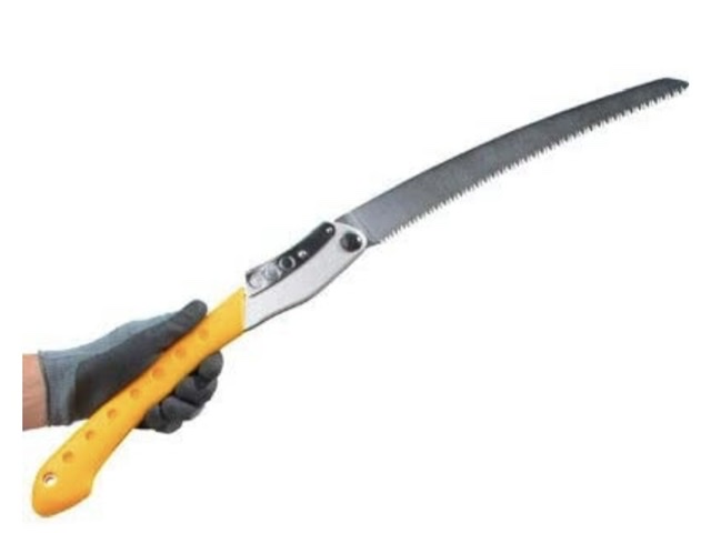

You’d be better off with a Silky hand saw. I have a small one for trimming, but they have large ones for serious cutting. They are sold on Amazon. But check out their website and read reviews to see which model to get. There are different configurations of blades and teeth size.
Silky Professional BIGBOY 2000 Folding Saw XL Teeth Silky Professional BIGBOY 2000 Folding Saw XL Teeth - Hand Pole Saws - Amazon.com
Folding Straight Hand Saws

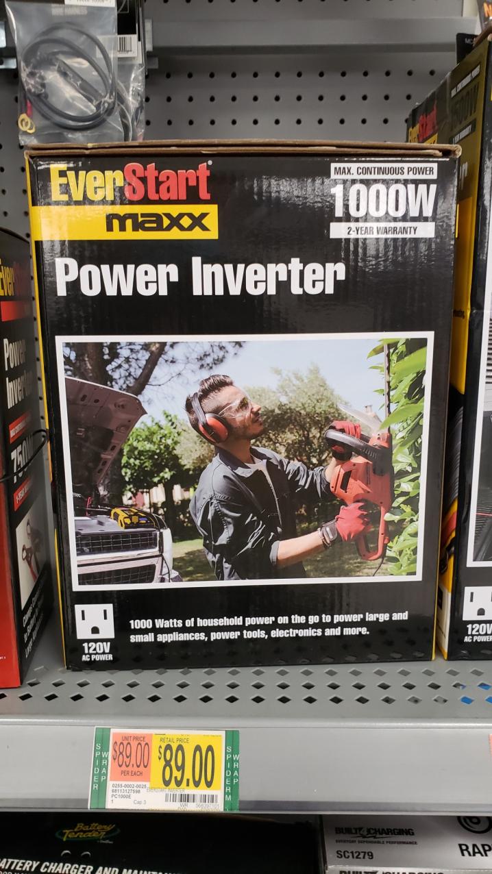

Saw this at Walmart today...not sure how safe it would be...would need to do some power calculations and wire ampacity checks.
But the power inverter shows a hedge trimmer I think. Wonder how much more an electric chainsaw would be.
I would go with a lithium battery powered chain saw with a quick charger off an properly rated inverter.
