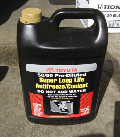

Im wondering if Toyota sells the pre Mix 50/50 coolant blend or do they only sell the concentrated 100 proof Red Stuff.
I saw a gallon jug at the toyota dealership near me that said 50/50 on the outside. I'm assuming it was a 50/50 mix of red.
The Super Long Life (pink) says 50/50 Pre-diluted--was this it? The pink is NOT a 50/50 mix of red, they are different technologies.
So we have to buy 3 gallons of the pink, I was originally going to buy 2 gallons of the Red and 4 quarts of distilled water. Now I can avoid buying the distilled. I called 1 dealer and said he only carried 100 proof Red. I have to call a few more Toy dealers.
