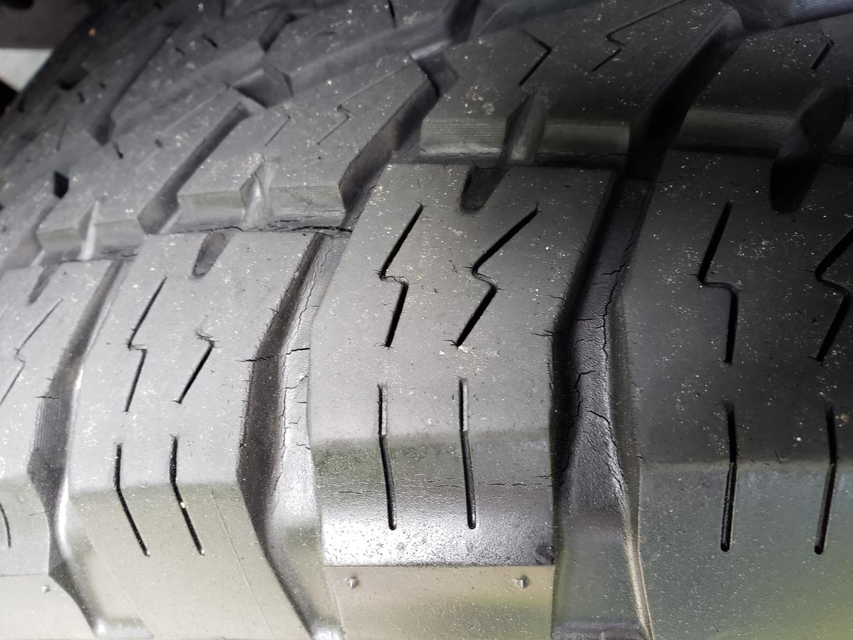

Are the cracks between the tread blocks dry rot? These are Nitto TG with 50k miles. Thanks.
I know you said they have 50k, but how old are they? There should be a date on the side wall.
They are from 2009, according to the sidewall. Got them in 2010. I'm planning on getting Duratracs before winter, just hoping these can hold out a while.
2009?!?
I think it's time for some new shoes. Almost ten years can be a long time for the life of a tire. Generally speaking, six to ten years is getting a bit old and should be inspected at pretty regular intervals. Let's put it this way, think about a blowout at highway speeds in heavy traffic, (worst case scenario). And while those may appear to be surface or superficial cracks, you are only getting further and further away from its production date. If you need to, you might wait till October for Discount Tire Direct's eBay sale. $100 off for every $400 spent. Depending on selection, you could save $200 on a set of four tires.

Thanks guys. Going with the Duratracs. Haven't driven the T4r much except in the snow these last few years.
