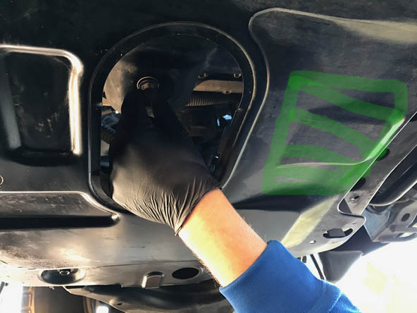

Is this the front jack point
2003-2009 4runner.
Area marked in green.
Do I just put the jack DIRECTLY OVER THIS GREEN AREA IN THE PIC?
WOuldnt this dent that metal piece?
I've seen the PDF for jack points for 2004 4runner...I am assuming this is what they are referring to.
The jack enters from the front of the truck, correct?

Green area is wrong. nowhere back there is correct spot. Your jack placement is on the back of front plate and it has circular area that signifies that.
