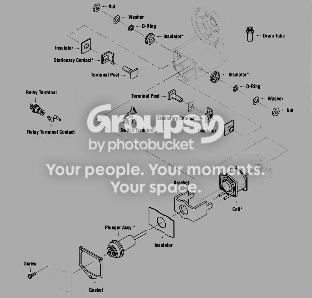

starter breakdown image
I also have used this thread to fix my starter-- thanks. Im adding 2 pictures that will be helpful to other people who have to do this .
OSGR_Exploded_view.jpg~original
Part numbers are
-Starter solenoid rebuild parts-
28235-54380 Plunger magnet switch
28226-54340 Kit starter repair
28226-72010 Starter kit
from here.....:hatsoff:
