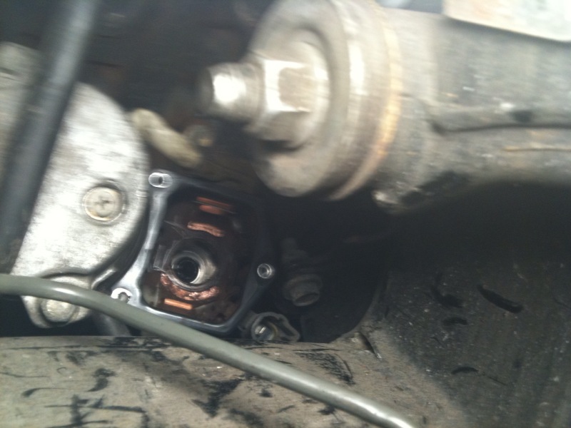

After unbolting the starter bolts (use 2 long extensions 6" or more with 1/2 drive/and the largest ratchet you have with swivel, remove the trans stick, unbolt the brakeline), you can twist the started around to face the passenger side wheel well. This lets you remove the 3 bolts on the solenoid cover:

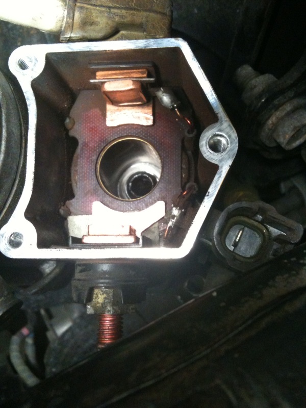

With cap off. The bottom contact is the one that wears out and the one that everyone is replacing:

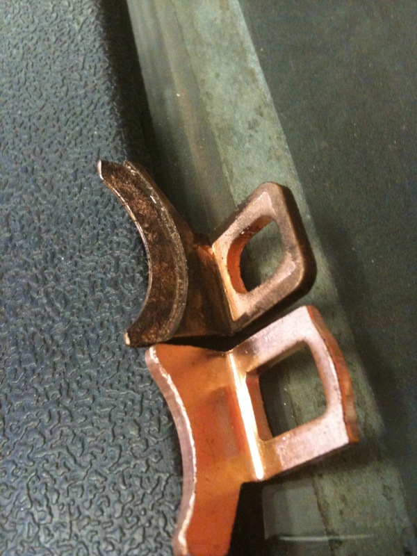

I only replaced the bad contact, as the other was barely worn. Comparo of old and new contact. Crazy how much the plunger dug into it over time:

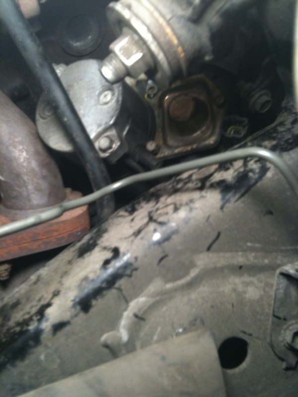

Next, I put some brake cleaner on a rag and wiped out the inside and installed the new contact, on bottom in photo:
After two hours, this is what I was left with:
