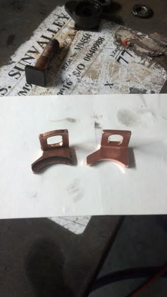

I replaced only the lower contact as the other did not have a groove dug into it. I only removed the one terminal and replaced it just as it came out.

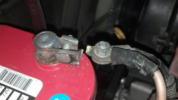

After putting it all back together, i reconnected the battery and a few seconds later WHAM! Smoke sparks and arcs, I disconnected the ground and saw that the pos terminal blew off.
Did I miss an insulator? Did it ground into the starter and fry the terminal? I had inspected it prior to all of this and did not see any obvious damage. Do I need to pull the whole starter apart again? Or just get a new battery terminal and try again?
No extra parts were left over, and I only had one round insulator with a tab coming off of it, on the contact that I replaced. Please any help would be appreciated, i only have tomorrow until im back on duty and cant work on it again until next week.
Edited to add: I used the Victory Lap ND-34SOL Solenoid Repair Kit off of Amazon, it did not come with any insulators or anything else. I also used the new plunger.
Got it fixed! The square insulator fell out and landed on top of the suspension arm. I pulled the skid plate and pulled the starter completely out the bottom. MUCH easier than trying to work on it inside the truck. Thanks guys!

At 165k, I installed the Amazon kit (2 contacts + plunger) as PM while recently doing my clutch. Really, only one of the two contacts was seriously worn. From all reports, this is typical. I saw nothing in the other parts that made me nervous and I had plenty of time to go get them if they had. Save your $26.
