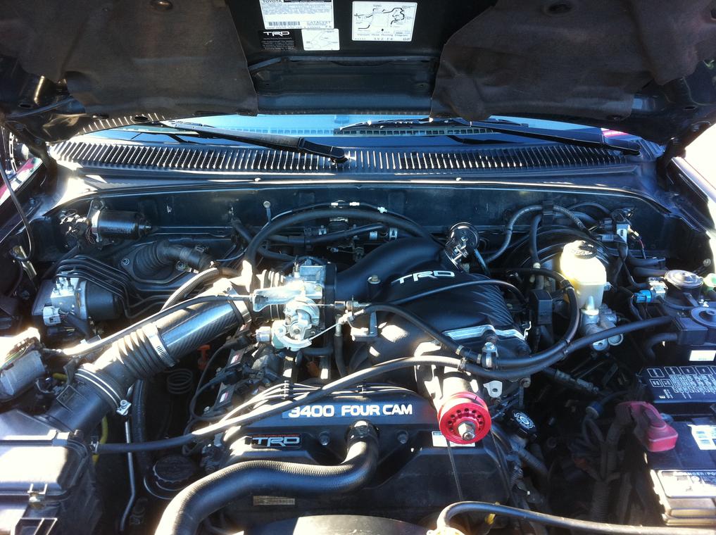

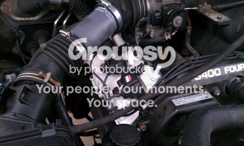

I used a 3" piece of pipe that a buddy had laying around. Then I wrapped it in a "carbon fiber" sticker that I got at Vato Zone!

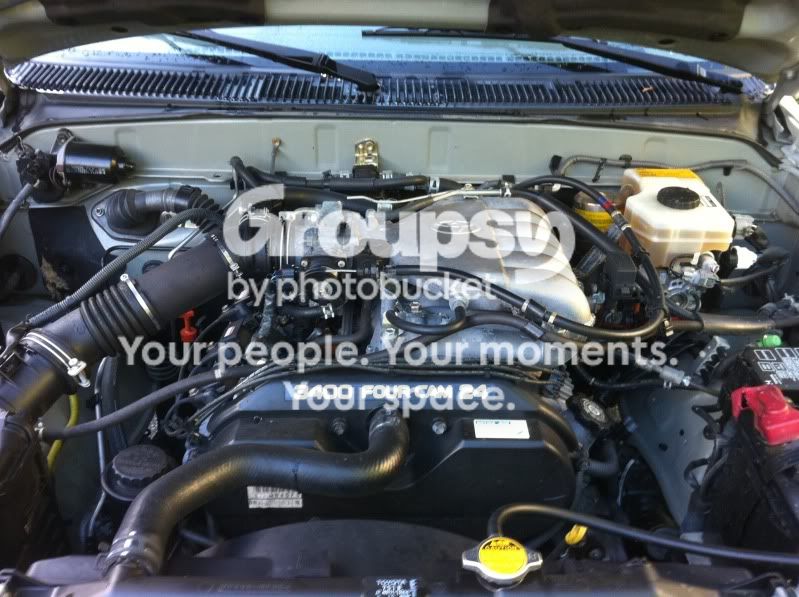

I just had a local pipe company cut a piece of 2.75" OD tube to 5.5" and then painted it with high heat paint. I actually threw the old stock piece back in recently, so if you want the pipe, you can have it.
photo3.jpg~original
Those look really clean guys!
Hepar, that's really kind of you to offer....but I'm thinking shipping would be a pain....I can get some tubing for next to nothing...so mainly looking for some examples.

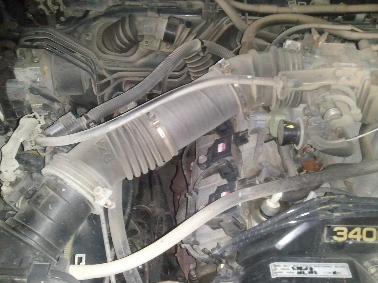

I used a piece of boat exhaust hose instead of a pipe, fit perfectly!
Wow, my engine bay is really dirty from a recent desert trip...

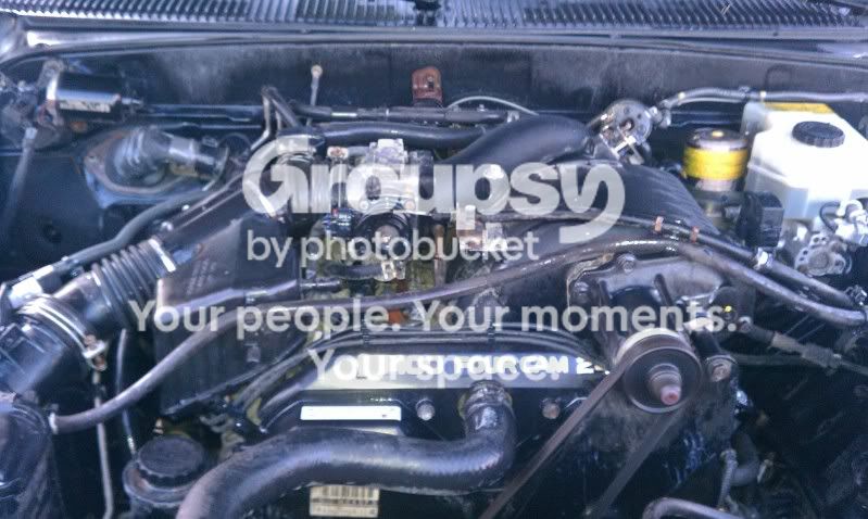

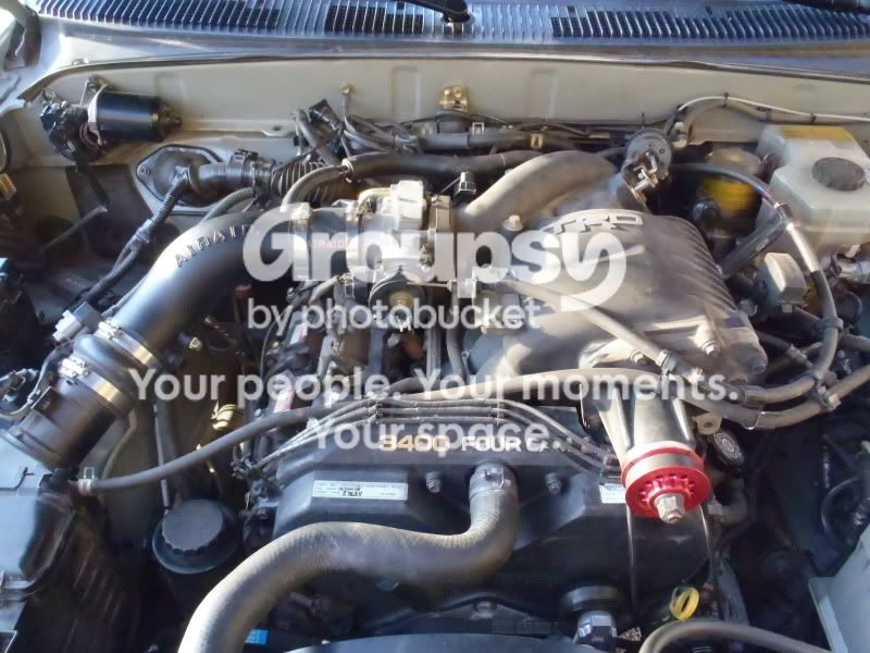

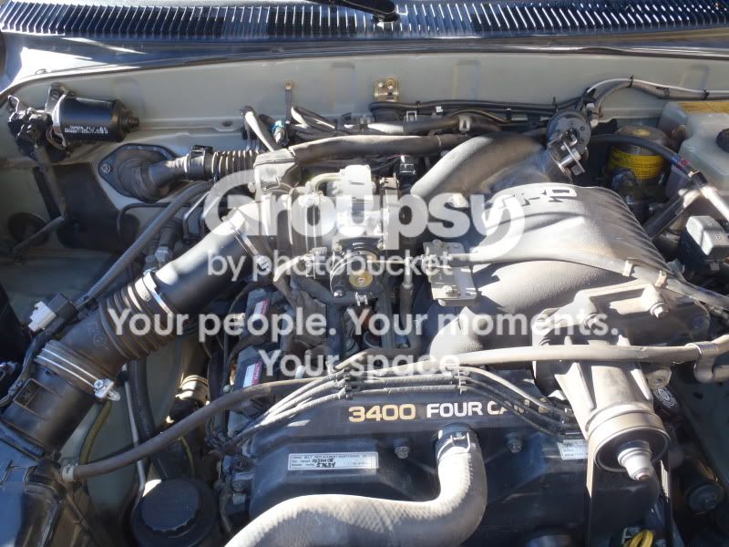

I noticed that all the pictures so far are of late model trucks, so I figured I'd throw this picture in as well.. The ISR mod on my '97 w/the early model intake tube.
695a950c.jpg~original
ff3d6071.jpg~original
And of course the late model ISR mod, when it was installed on the '01
f2bd7497.jpg~original
And the best ISR mod of all!!!
0d9365be.jpg~original
