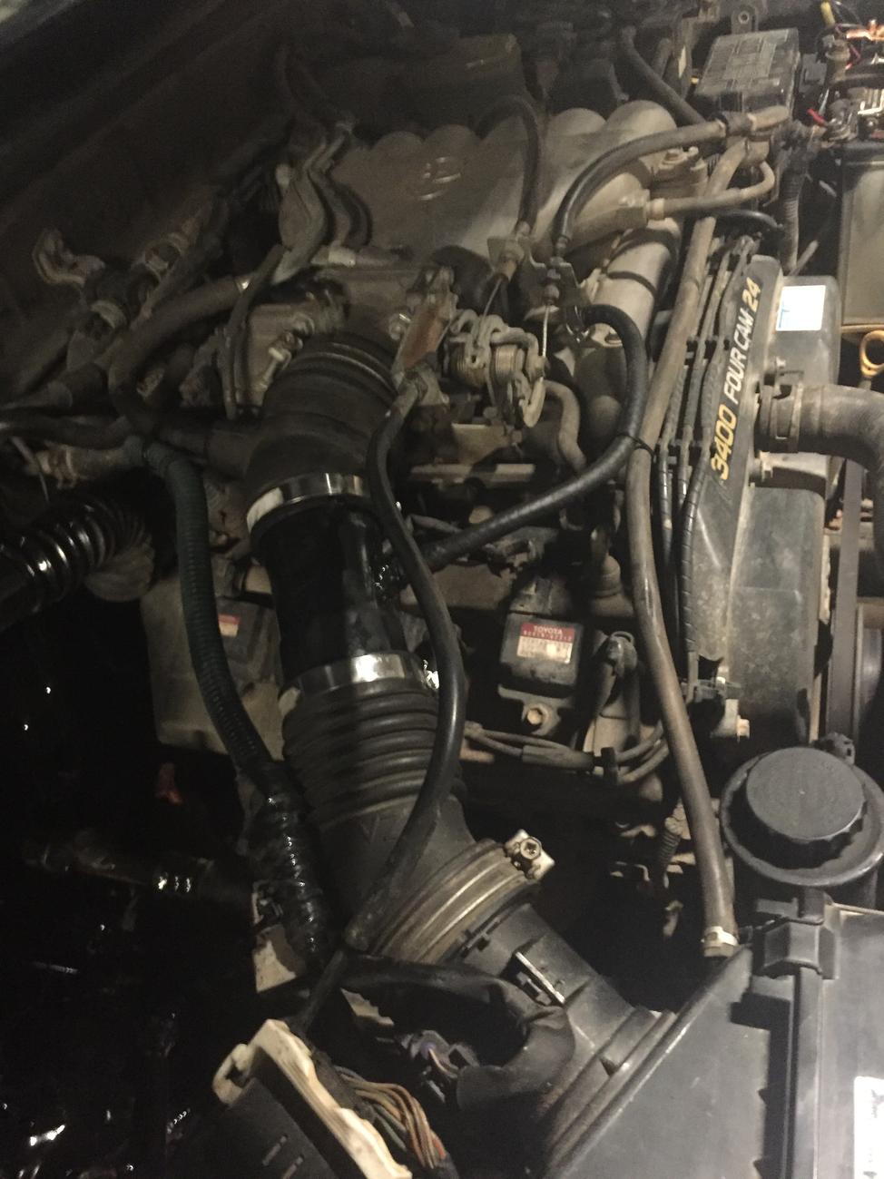

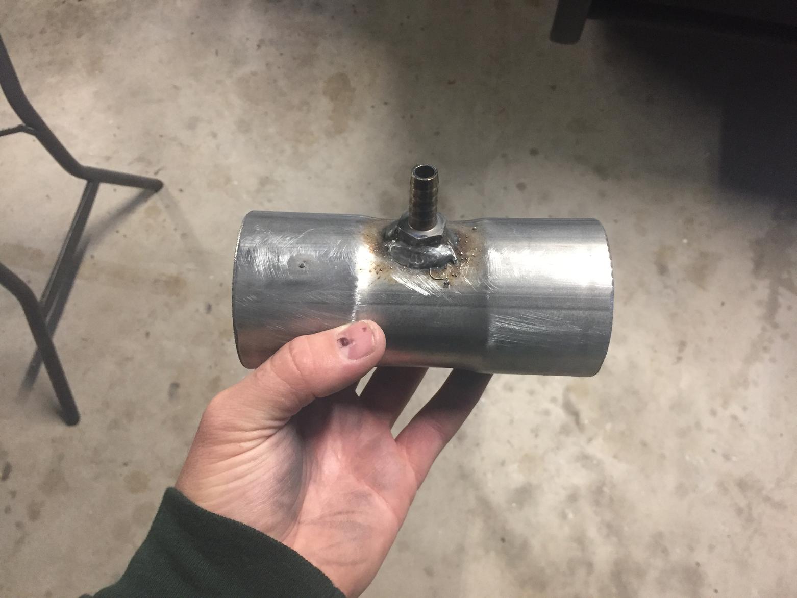

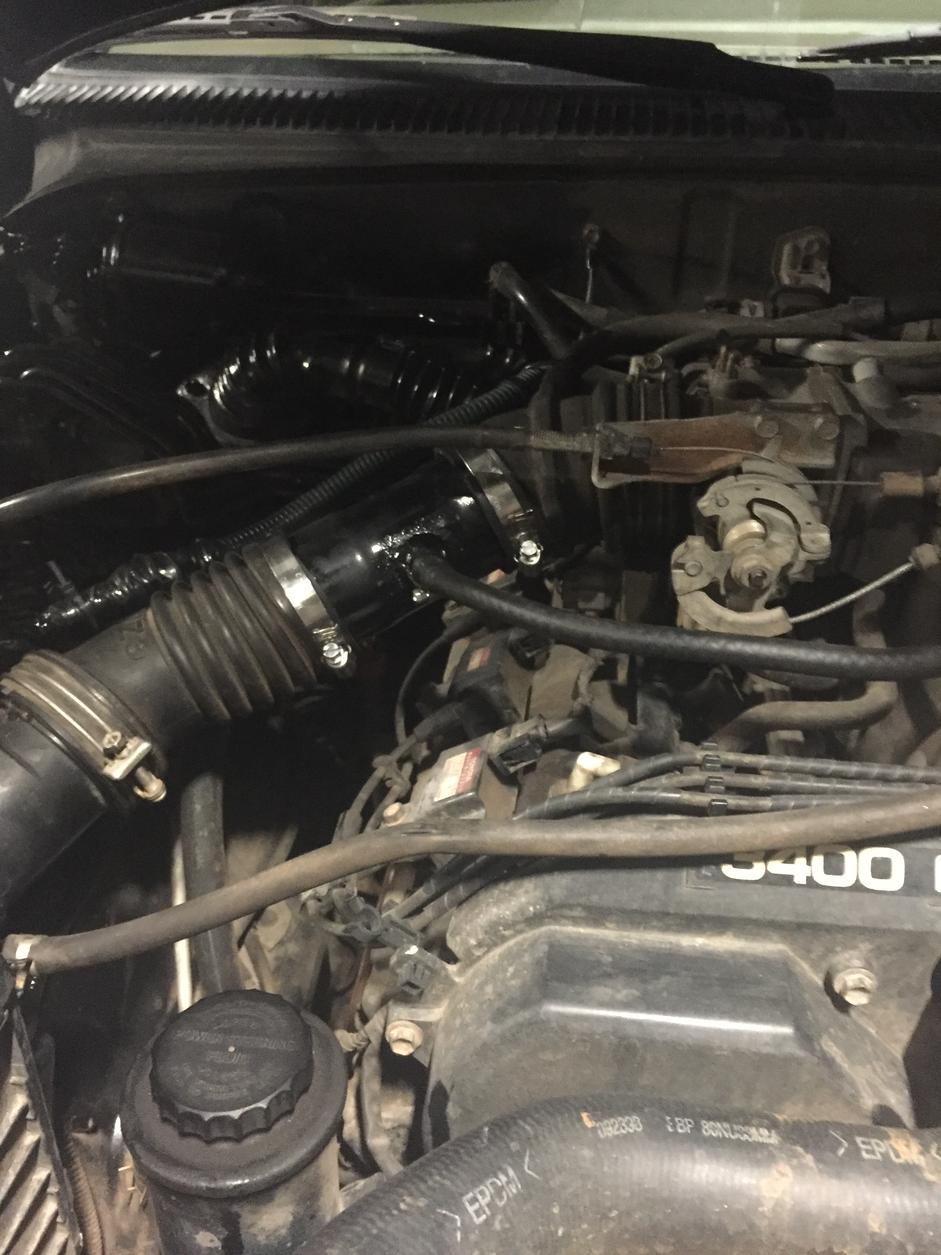

I went to a local muffler shop and had them take a 2.5" pipe and bend it out to 2.625" and weld a nipple on there for the fuel regulator hose. I painted it with some black paint made for high heat.

Thought I'd resurrect this thread with a quick observation I had.'
I did this mod a year or so ago, used an aluminum tube with the same length & diameter of the stock tube. I drilled a hole and welded a bung so I could tap in with that hose that connects to this tube (I don't know what that hose is).
Anyway, I've been chasing a "running rich" condition per my OBD readings. I was seeing LTFT up to -17% fuel trims at idle and up to -10% while at speed, but my STFT was near zero while driving, but would show up to -15% at idle. I replaced my O2 sensors (which were old anyway), and got no significant change on my readings.
Last week I had to do smog (I live in CA) and I failed visual due to having a "modified intake." So I went back home and swapped over the OEM intake tube with the ISR, passed smog, and now my fuel trim readings all look normal. I'm seeing +-5% LTFT and +-2% STFT.
So I take this to mean that my MAF was getting improper readings due to the different air flow pattern past the MAF. While my ODB app was showing a rich condition, I suspect the sensors were getting bad data and I was actually running lean for all that time.
I'm curious if anyone else has experienced this, or if all your fuel trim readings seem normal even with the modified intake. If you are seeing normal fuel trim numbers, what spec tubing are you using? And how did you plum that hose that connects to the intake?
The vacuum line that connects to the resonator box halfway up the tube is the 'vacuum' reference for the fuel pressure regulator. In stock form, that is basically a barometric pressure reference (it shouldn't change much with airflow, etc.).
Either that was somehow messed up with the way the bung was welded or there was an airflow leak causing unmetered air to enter the engine. Changes after the MAF shouldn't affect the accuracy of its readings.
