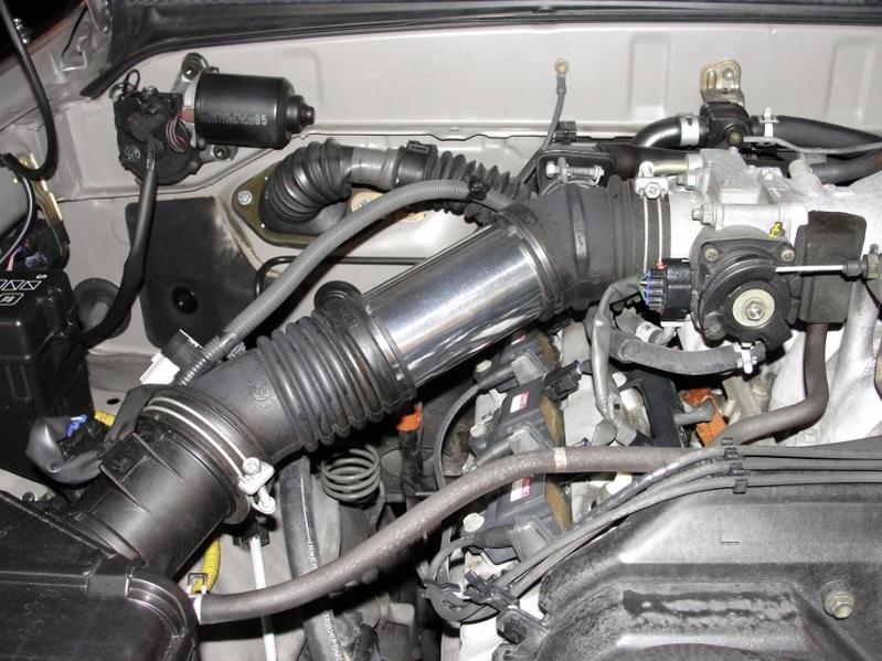

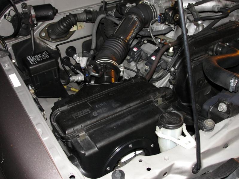

here is a pic of my mods. i changed the isr tube to aluminum from slilcon intakes.
