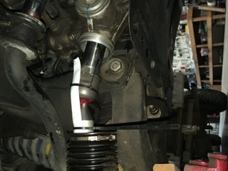

Is the ITRE spring loaded? Meaning is there a spring in there that keeps the ball pushed out against the socket even if there is a bit of wear? Or does the slightest wear make them floppy?
I have a click coming from the drivers ITRE or steering rack area when driving over cobble that chucks the wheels around. Everything is snug and tight when pushing and pulling on the tire (jacked up) as hard as I can, but if I lay down with my head near the ITRE and give the tire a real hard whack with a knee I can head the clack. Just can't decide which is doing it. Might have to pull the ITRE boot off and see if I can see what is going on.
OTREs are new OEM. LBJs are newer OEM. Steering rack guide is new design and torqued per FSM. Rack bushings are Energy suspension.
Thanks.
I don’t believe they are spring loaded, you can always pop the end of the outer out of the ball joint and see if the inner is flopping around, I have some Napa or rock auto inners that’s are still tight after 20k. Could also be your rack bushings causing the issue

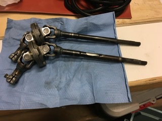

I do have a clack in the intermediate shaft u-joints in the firewall. I suspect this is separate though. Might just have to pull the shaft out to isolate things.
No slip joint to tack weld in a 96. Solid shaft.
That’s interesting, I’d have thought the 96-98 would be the same. Guess it depends when they introduced crash safety items.

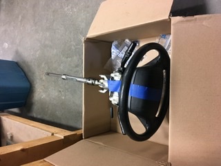

When I shove my wheels it turns the column a bit. Hard to separate column noise/play from TRE’s and rack.
Well, today I dug into it. At least I got to the bottom of it. ITREs are good, no need to think about those. Steering shaft and intermediate shaft good too. It’s in the rack itself. Had to break out the pieces to know for sure.
Play in the rack is very minimal, not noticeable from the steering wheel but that’s where my clack is at. It’s been that way for years now so I’ll continue to run it for now. Maybe someday I’ll think about replacing it. For now it doesn’t leak or have any issues.
Edit: mid 97 was when the non-collapsing steering shaft part number was changed. I assume that’s when the sliding one was introduced.
