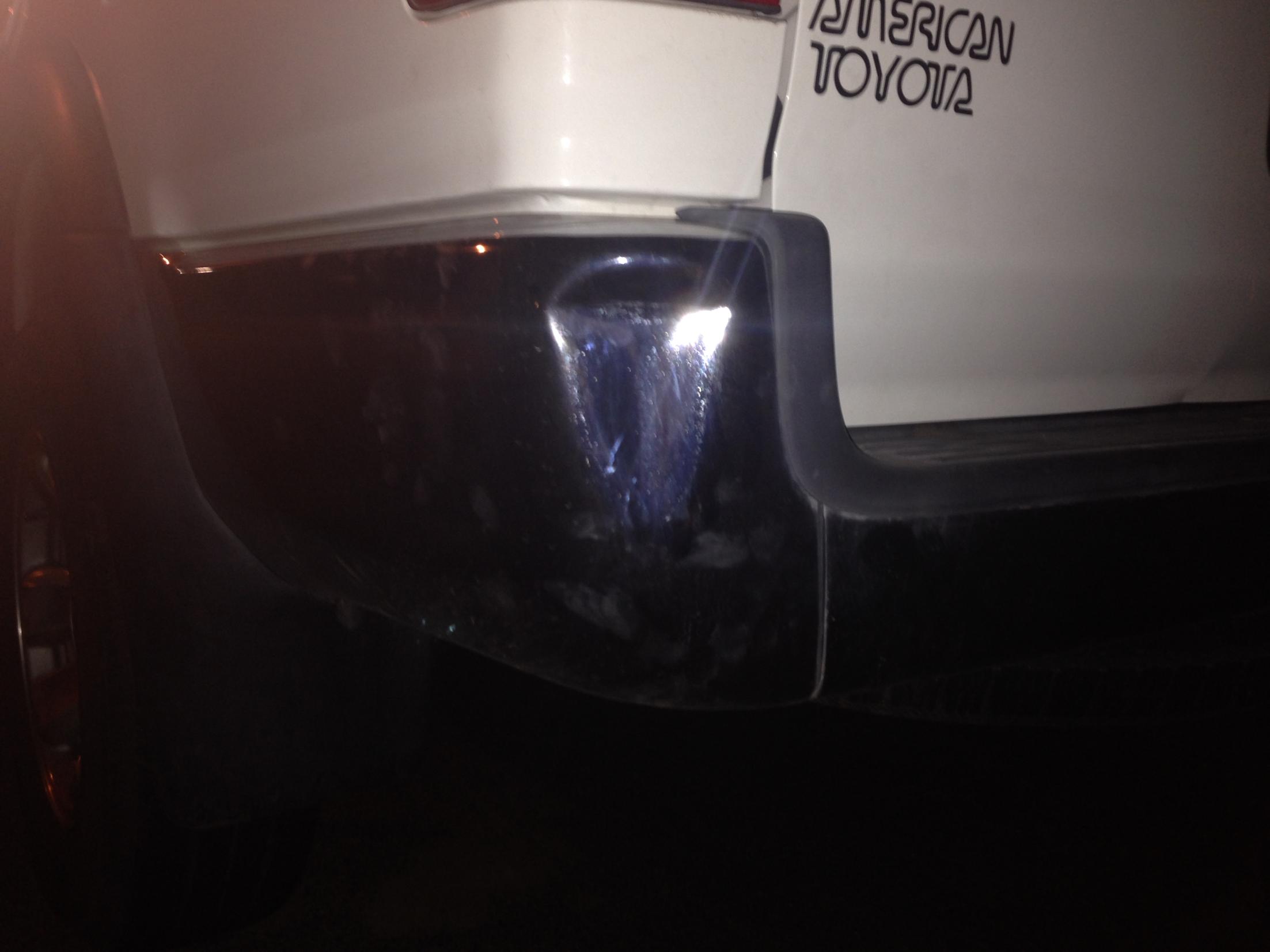

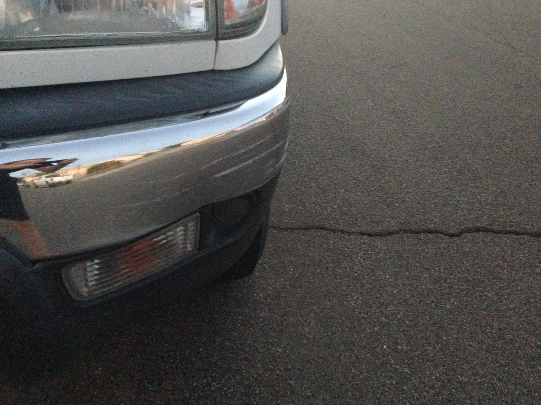

So its that time of year again...we here in the east valley of phoenix Arizona get our lovely winter visitors and its only November and I have already been hit 3 times while my trucks in the parking lot at the grocery store :50cal:
So other than the light bumps in the parking lots and driving 15 under the speed limit I think I might be able to survive the next 4 months...or until I build a plate bumper spikes on all 4 corners :lookout:
but until then I need some help with somehow getting these dents out and while I know the front may forever altered I figured I may be able to get the rear looking at least better. Anyone have experience bashing out dents in our chrome bumpers?
sorry about the dark pic ill take a new one in the morning

ive tried, those bumper are pretty stout. it would be best to take them off then lay the bent part on a bean bag of some sort and smack the back of it with a large hammer. smaller ones will cause little outward dents. dead blow hammers work good.

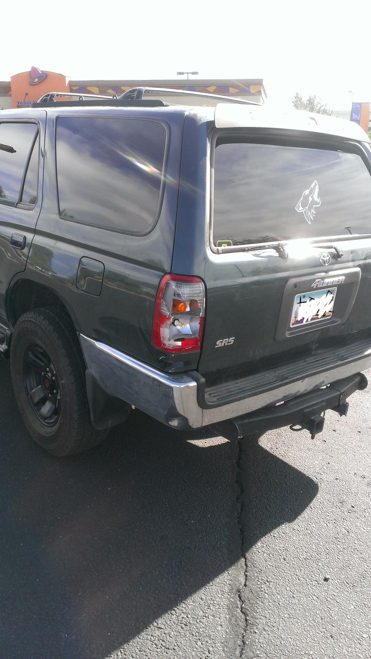

I feel your pain man I had a snowbird smash my truck with her duelly when i ran into fry's for less than five minutes. I'm literally afraid to take my truck out anywhere now.

I'll have to give that a try, I was hoping they would just pop back out but it doesn't seem that's the case :(

I can see the Taco Bell in the back...it must have been at the frys on Idaho because that where ALL three of mine happened, sucks about your taillight! More expensive fix than my dents for sure
haha how'd you know that man you're creeping me out! And Apache Junction is pretty much grey hair central during the winter...
