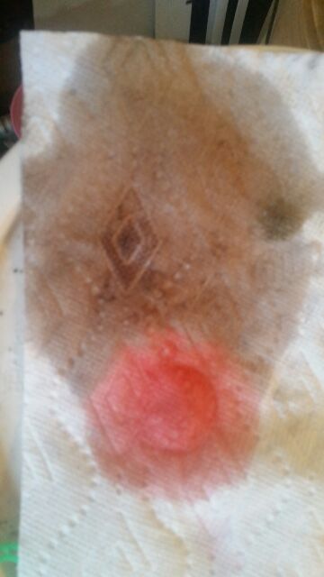

I did a return line fluid exchange yesterday. 198300 miles. I am not sure it had ever been done. At first it was very dark and smelled almost burnt. The reason I think it has never been done? I had to use a impact screwdriver to get the 5mm check plug out. I had the torque convertor shudder.I hope the transmission lasts, but if it does not I will report back. On the top is original fluid, bottom new fluid.
