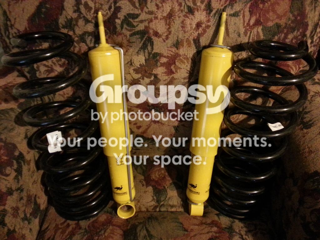

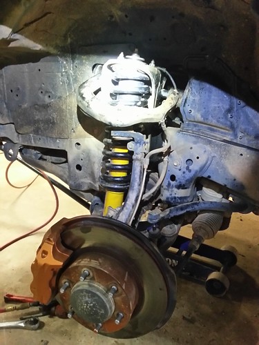

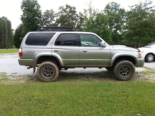

Ome 891's! Just waiting on the front set up (ome 881's) from a friend. Should have it on by next weekend!

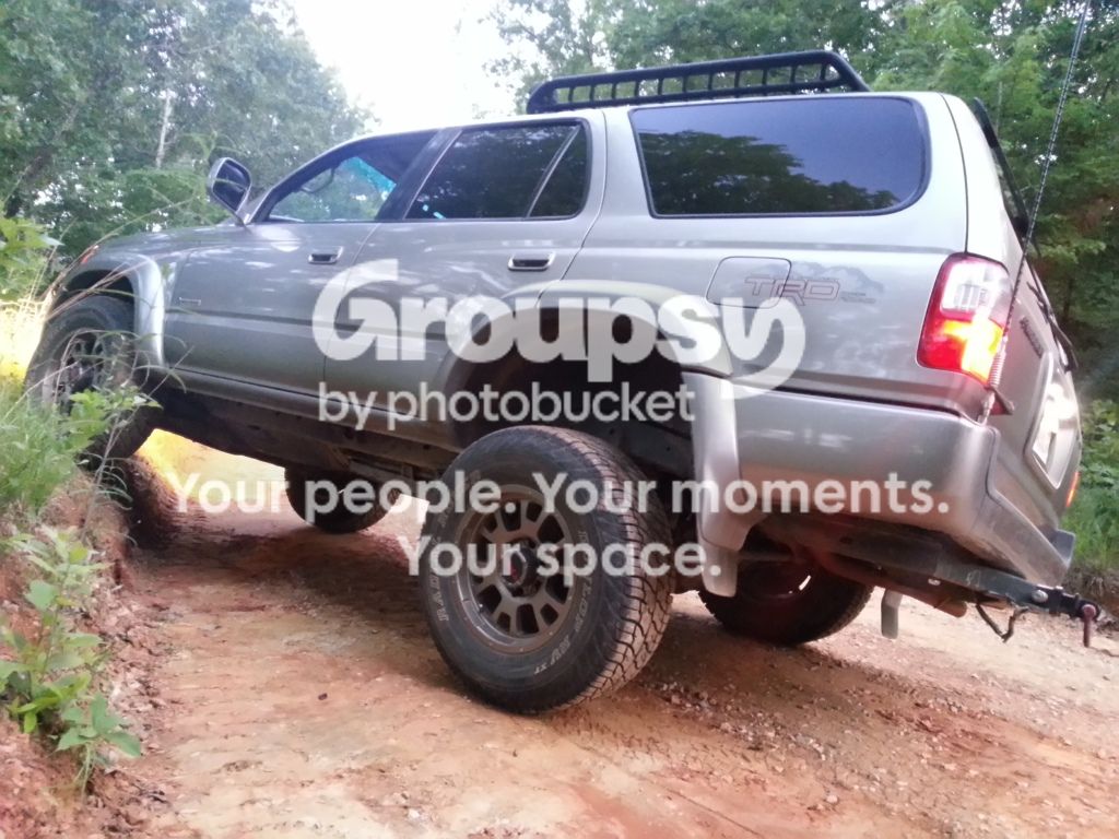

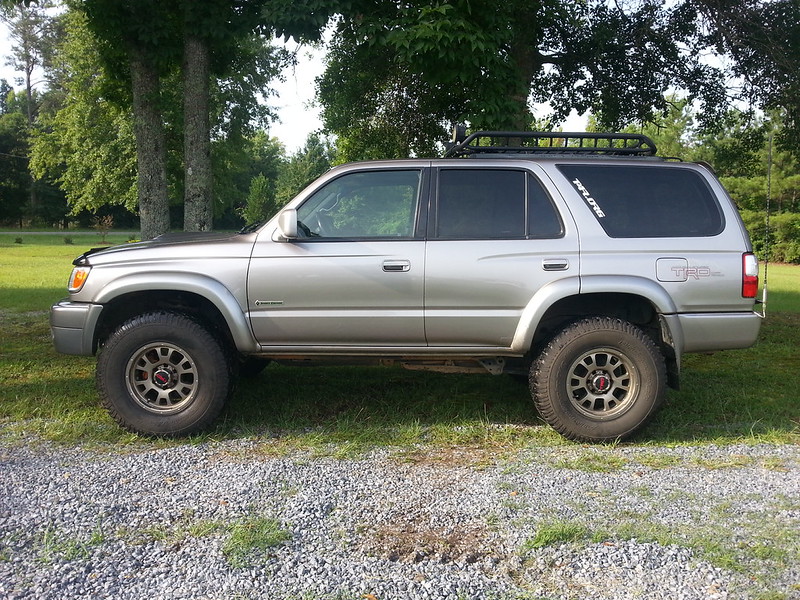

Also decided to disconnect the rear sway bar to see how it flexes and well its a big difference! Level ground measures 20.5" from center of hub to fender, in that pic it was 29.75" and all 4 tires were still on the ground!
20130621_200639_LLS_zpsf7480b16.jpg~original
Nice! Did you notice any difference driving it on road with the sway bar disconnected?
Thanks man! I only drove it a few miles on the highway before reconnecting it, and I honestly couldn't tell a difference. My concern is that if you were ever to make an emergency maneuver you could probably notice it then.... followed by flopping it lol!
