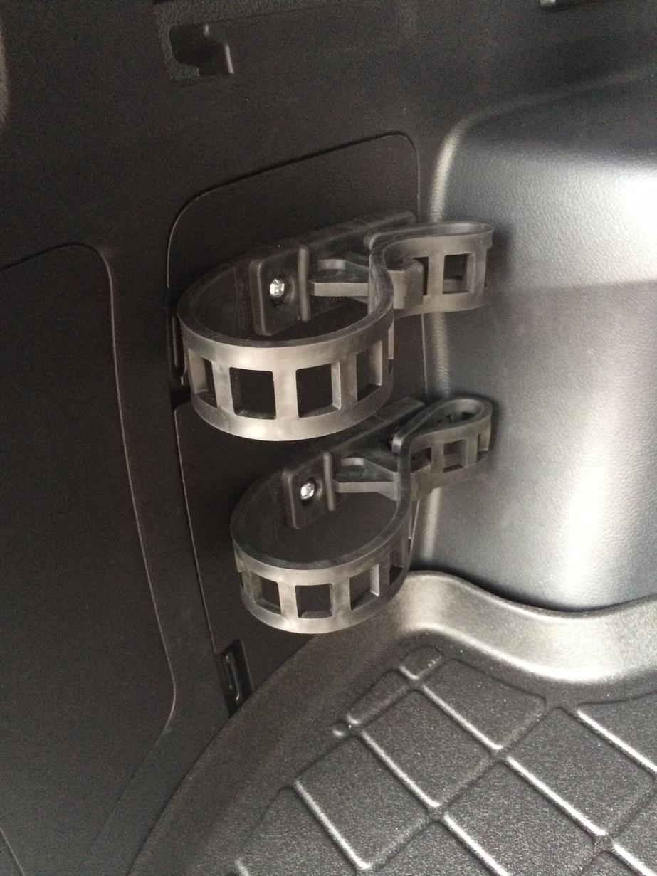

You could say I could have done more homework for my first mod (if you can call it one), and you'd be right, but I'm only 50% disappointed so it could be much worse...

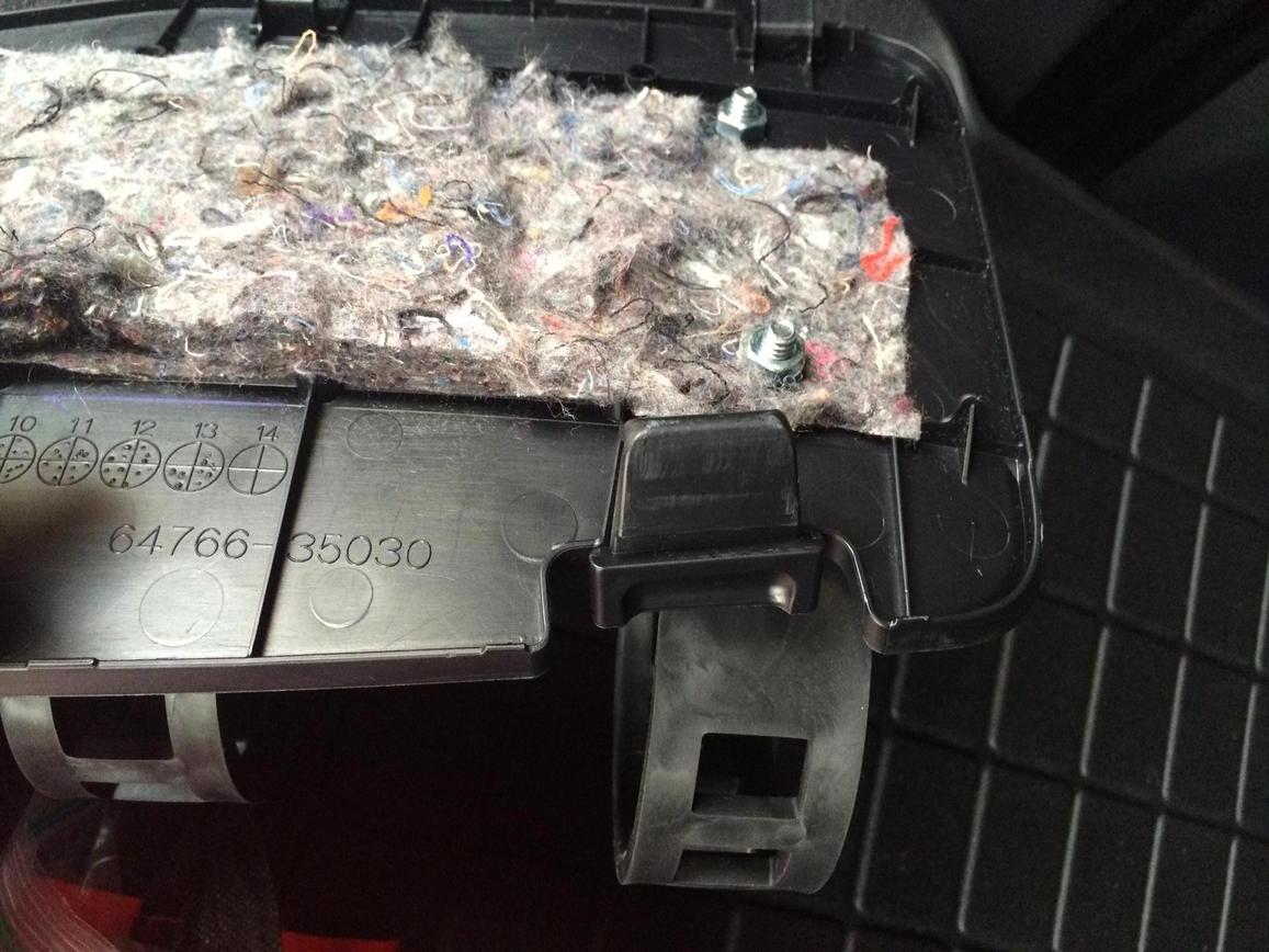

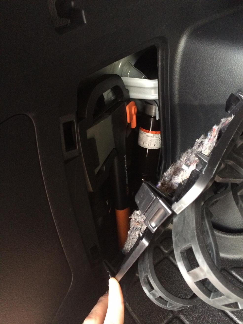

I thought it'd be rad to attach a fire extinguisher somewhere in the back. I saw that [MENTION=51030]joneseyyy[/MENTION] used some Quick Fist clamps, which achieved the look I was going for, so I ordered them. I attached them both to the jack panel, grinned at my work, clamped in the fire extinguisher, and then watched the panel slowly open because the extinguisher was too heavy for the small plastic tabs on the panel.
While it will generally stay in place, I definitely need some help figuring out how to somehow reinforce the tabs or add something like a basic latch that would keep the panel secure.
Thanks in advance for any suggestions!
Mike

I would put some modeling clay or something similar "inside" the "v" of the tabs. This should effectively push the tabs outward for more grab. Start with a little bit and see what kind of effect that gives you. If you want more resistance then just add a little more. You basically need something to "push" the tabs outward so that it holds in the locking position.
And if it doesn't work, you can just remove all of the clay.

Haha, thanks Eddie. Yeah, unfortunately there's not really much space elsewhere that I could find back there since the third row armrests come to the window. And it really looks like a great spot otherwise, so I'm hoping I can keep it there. Some sort of small hinge should do the trick just fine, since it's really not pulling it like crazy or super heavy. I just don't really know what websites might carry something like that. Any suggestions? I could always just go browse my local Home Depot first but wasn't sure if you guys might know of some good sites that sell random stuff like this.

Thanks for the link, hatch heaven on there! Was leaning toward Duc's simple suggestion until the comment about it becoming a projectile in an accident, probably a valid concern even with slightly better tabs.
If you are dead set on that spot, here's what I would do.
With the cover in place over the opening, drill a hole between the clips on the leading edge. Drill through both the cover, and the panel behind it. Remove the cover and place a nutsert in the hole left in the panel (still attached to the truck).
Pop the cover back in place and screw a thumbwheel through the hole in the cover and into the nutsert to secure it.
.....but that's just me:eyebrows:

Thanks Antman, I like the way you've done stuff, so I appreciate the feedback. That looks like a solid idea, although I don't know anything about installing nutserts. Would it be fairly straightforward to get it to stay securely on that rear panel? I also came across this bad boy on the site Eddie gave me...

nutserts are pretty easy to install, they go in pretty much like a pop rivet, just pick up a kit at harbor freight for like 10-20 bucks and it should have the setting gun and plenty of inserts for this project :)
EDIT: This tool, http://www.harborfreight.com/45-piece-threaded-insert-riveter-kit-1210.html
