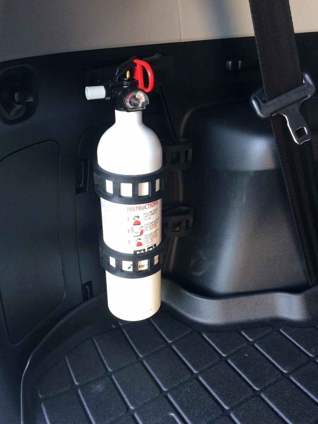

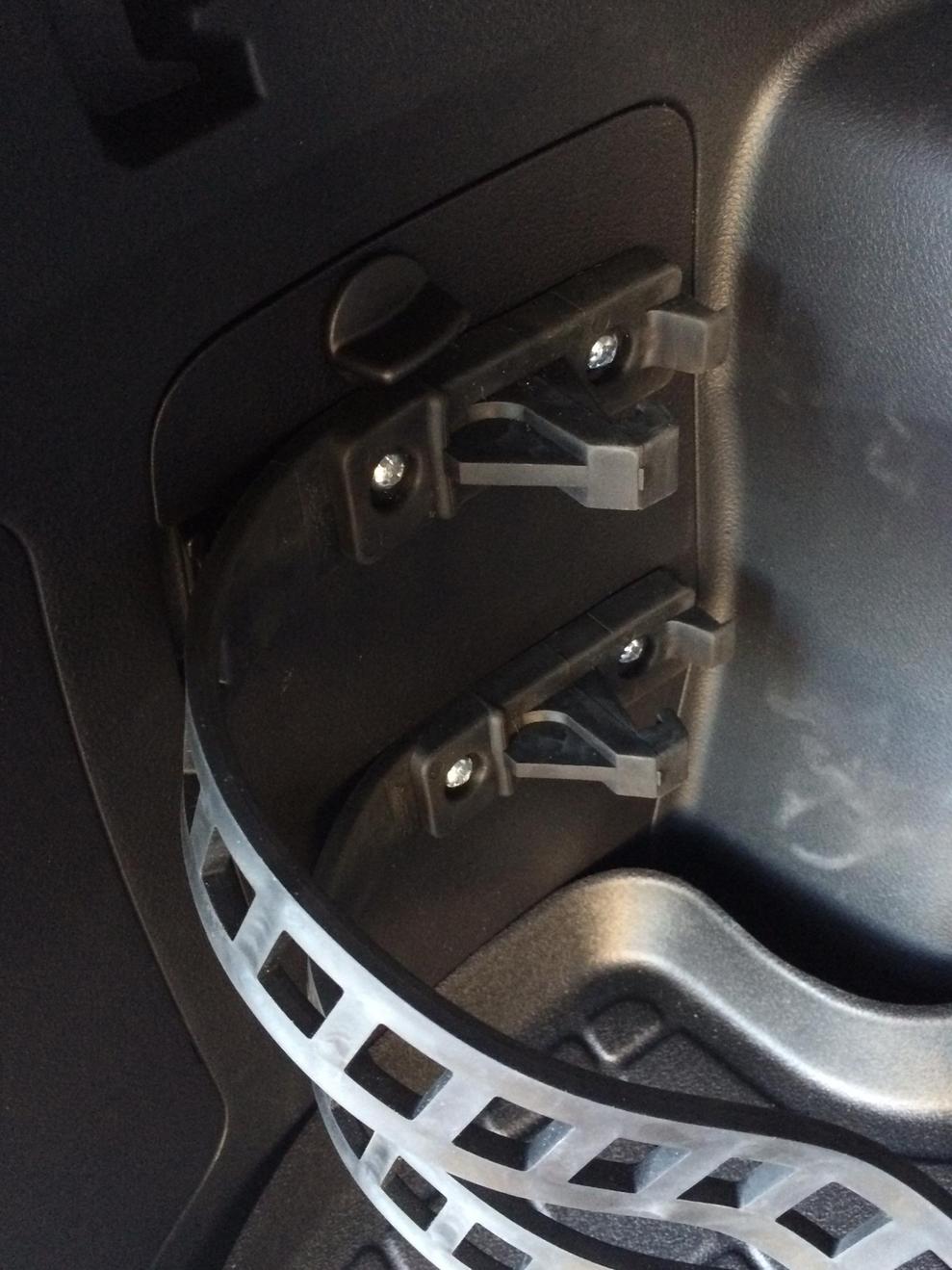

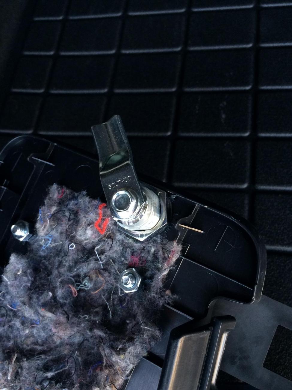

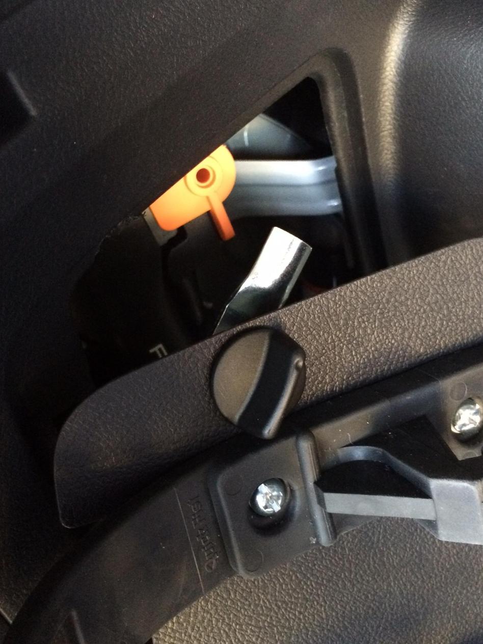

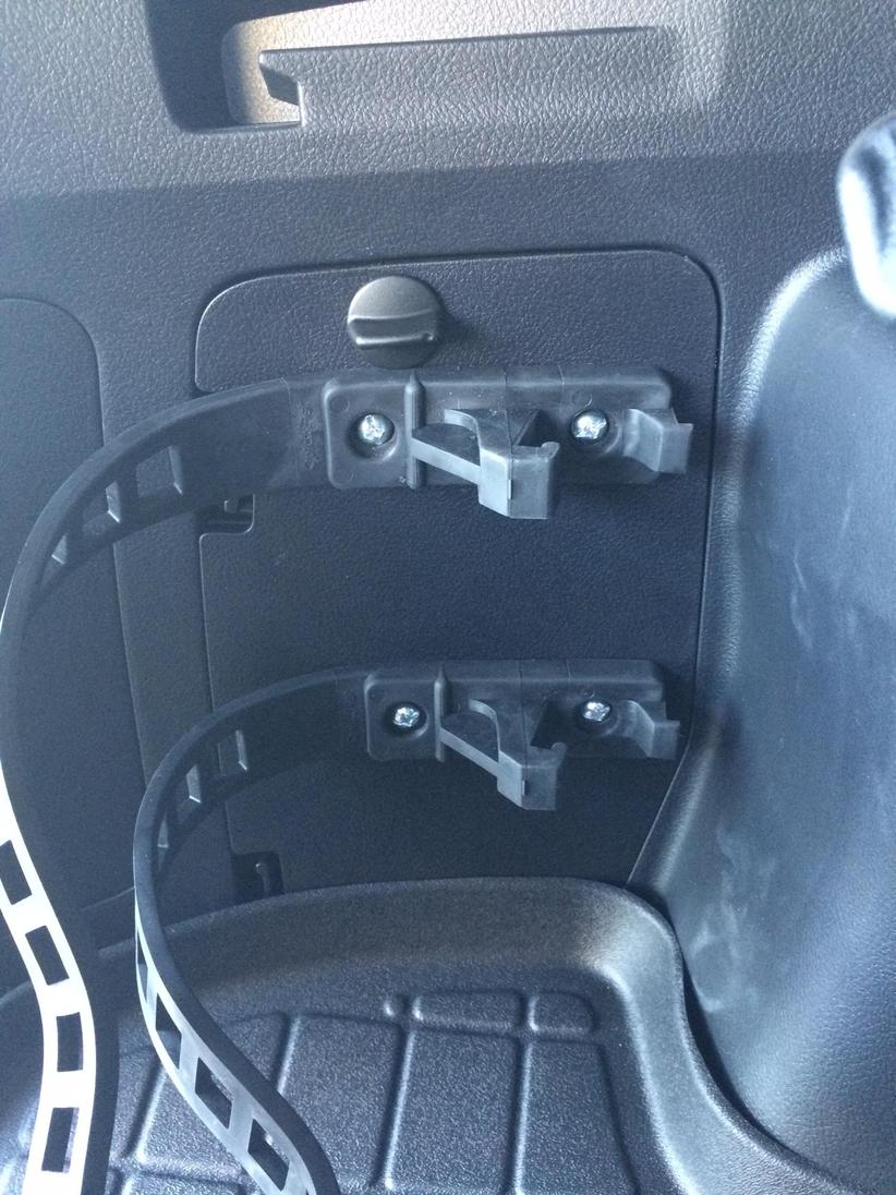

Thanks for the input and ideas [MENTION=85512]eddiebx[/MENTION], [MENTION=65614]Antman[/MENTION], [MENTION=68685]Ducmonsta[/MENTION], and others. I ended up buying a cam latch from McMaster-Carr and installing on the top, which seemed to be where it most needed the support. Seems to be holding the panel in there pretty well so far!

Personally I still wouldn't trust the hatch door to stay put. Could you not as easily mounted at least the top bracket right above the door?
Agreed. Sorry to seem like a worry wart, but when it comes to these types of things you can never be too safe. If you can't figure anything else out, perhaps you can see about running a safety cable that ties through the panel and hooks to that steel bracket behind the hatch door? Leave enough slack so you can open the door and unhook it obviously, lol.
Great idea on that latch though, I will surely steal this for some other things I have in mind!
Somehow I missed these posts. Those are both really good ideas that I'm going to look into, as I still have some concerns myself a couple months later. Let's just say I've mostly been driving without the extinguisher...
