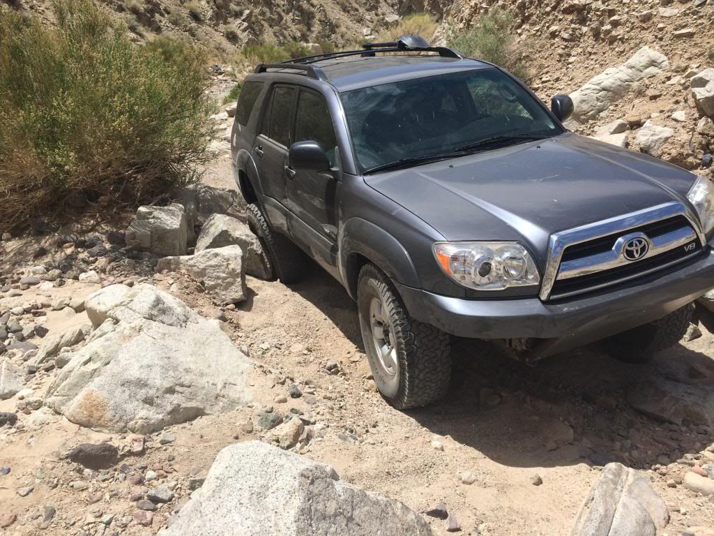

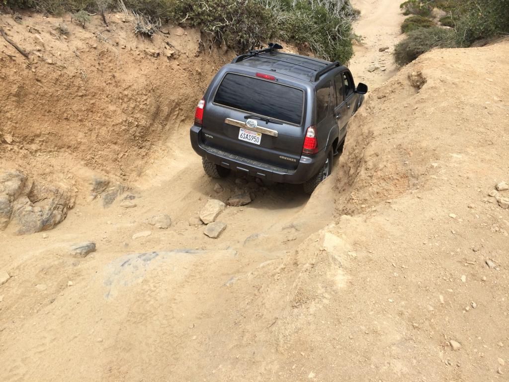

The wife, myself and our 2 month old son went out to Jawbone Canyon for a few days of camping, wheeling and just good times with friends and family. We did not really have an agenda, just relax and hit some trails. After some light wheeing on friday we decided to try out Last Chance Canyon in Red Rock Canyon state park. We opted to try south to north. I had the 4Runner, my brother had his Subaru Forester, my dad had his bone stock Land Rover LR2 and my buddy had his Ford Raptor. Last year my brother and I did this trail from norht to south and is seemed to be right at the limits of our Subarus. This time knowing starting from the south would be more difficult we tried it anyways. Overall the trip went great, so great we do not have many pictures. Having the most clearance I was able to tackle a few difficult spot as the others would have to bypass. After Last Chance Canyon we went to "Burro" Schmitt tunnel and then continued on EP103 up and over then back down to the 14. Sundays adventures brought us into the southern most point of the Sequoia National Forest for a few miles, then we headed home.

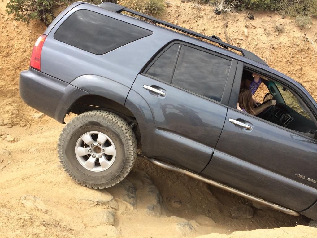

Heres a little spot I could not get through. Passenger rear and driver front were spinning, need locker! And this resulted in some wheel rash along with some trailing arm mount adjusting.

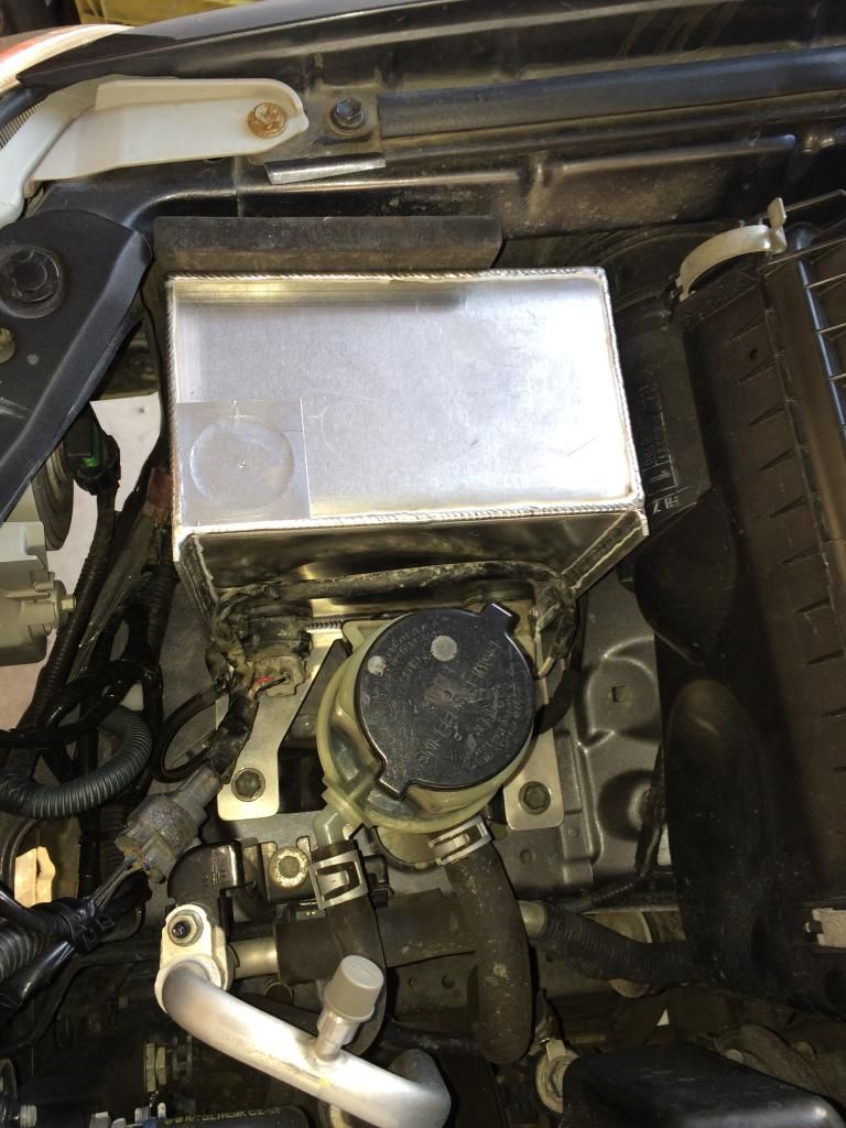

After chopping up the factory front bumper cover and building the front bumper it became apparent that the factory windsheild washer bottle was now out in the open just waiting to be crushed by a rock. Due to the bumper design I do not have much protection under the headlights. I am ok with this. But the washer bottle was a bit of an eye sore.
So the solution was to build a new one to mount behind the passenger headlight up in the apron panel.
Time to fire up the welder and break out some aluminum.
And here is the filler weld on bung and cap. Hoping to weld this on this weekend sometime. I will also drill out the bottom of the cap and counterbore to put in some filter material and secure with a set screw to create a breather.
