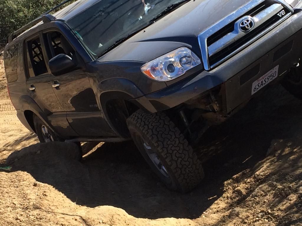

It was time to re-install license plate to the front of the 4Runner. So in true Jackson fashion this involved firing up the welder and bracing the front diff mount......and eventually popped the license plate onto the skid plate.
Stock
Boxed
I also cut windows into the skidplate for more air flow to the radiator.
