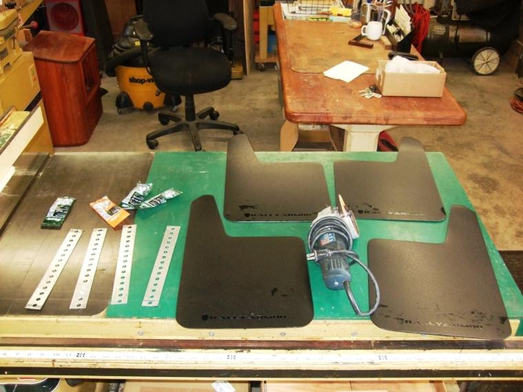

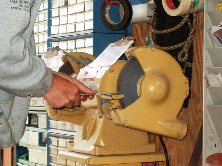

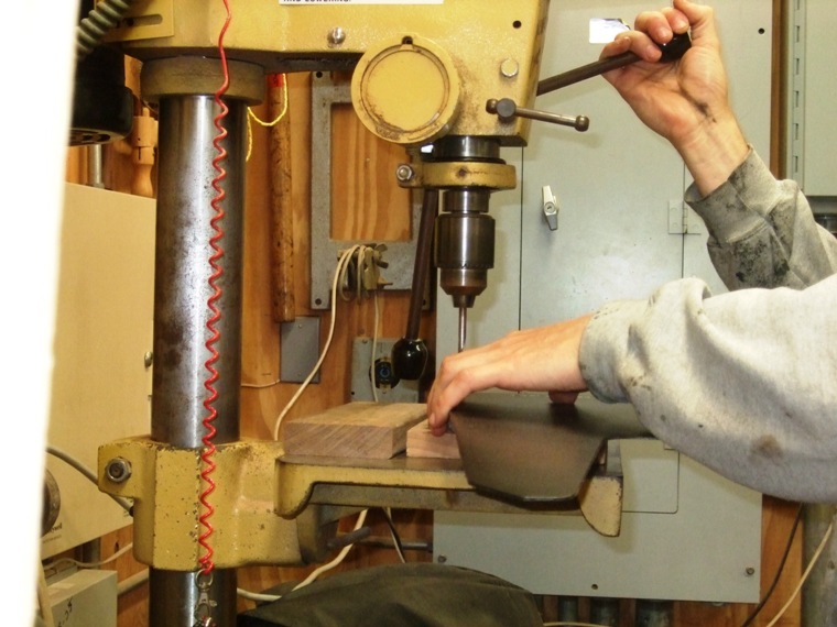

I had free time in the shop today so I worked on modding some Rally Armor mudflaps I picked up recently. I just need to buy cable and a couple of screws to attach the front flaps. Thanks to JC12 for the inspiration! I'll be finished in the next couple of days. I prefer using a drill press whenever I can as it yields straighter, cleaner results. I also used a cutting wheel on my grinder and a grinding wheel to clean up the galvanized steel.

Soo jealous of your shop...
It's a great set up we have for maintaining and working on tallships here in Dana Point. We have every woodworking tool you could ever need and quite a few metal tools as well. My next goal is to get lessons from one of our volunteers who is a master craftsman and a great welder. He told me if I buy a basic set of welding tools, he'll show me the ropes.

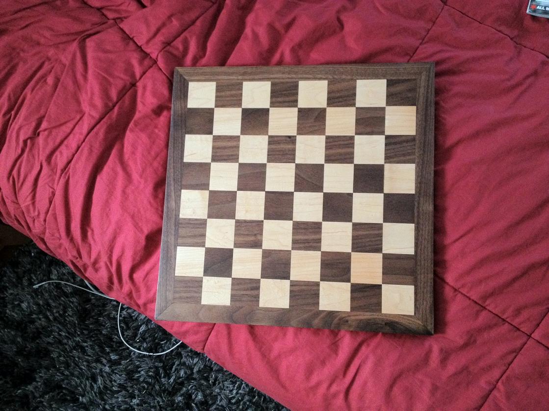

Awesome board 4RunningDaily! Nice clean miter cuts. Looks like you used maple and walnut, though I could be wrong.
Since everybody uses different techniques, I'm curious what process you used?
1) Cut equal lengths and widths of walnut and maple. Did you need to use a planer or joiner?
2) Glue and clamp the lengths together. I use Titebond III cuz it's waterproof and I've never had any problems with my joints failing, though none of my projects are old enough to fail quite frankly.
3) I usually wait overnight before resuming work. Cut across the grain with a table saw. I usually use an 80-tooth blade for cleaner edges. Then flip every other piece and glue and clamp again.
4) Options vary for finishing work, depending on the setup. My shop doesn't have an industrial-grade belt sander that accommodates wide pieces, or a wide power planer, so I rely on a good old bench plane or random orbital sander for finishing work.
5) Some old guys I know hate sanders. They finish their work using only hand planers. Good for them. I'm still working on my technique, but I'll work my way through grits, ranging from 60-400 if necessary.
6) I'll also use a router for edges and to make handles if I'm creating a heavier board.
7) Select finish. I use a mineral oil/beeswax mixture for cutting boards. I've also been experimenting with salad bowl varnish, lacquers, and shellac.
