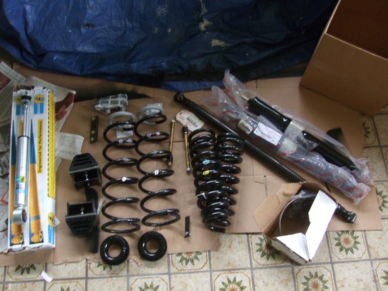

I just bought a used version of this kit and I wanted to ask, in regards to the picture, what are those two pieces visible below the land cruiser springs and also those gold bolts shown.
Hey FrankM23, I'm sorry to sound like a total noob, but I had my shop install my suspension. I know coils and shocks, and some of the other basic parts, but I'm guessing about specifics at this point. I believe the gold bolts are for the front differential drop spacers, though I could be wrong. Perhaps the two pieces under the LC coils are upper shock bushings. I hate to give bad info, and just in case I'm wrong, I'll post a list straight from Sonoran Steel's website. You can call them and talk to Steve as well. He's the owner, and he's very helpful. Also, you can contact Brianemc2, a member who's helped me out a great deal. He runs the same kit and is the guy who helped me decide what kit to buy. All I know is the kit is awesome! My truck feels capable no matter the conditions now. Hope this helps man. Sorry I can't be more certain, but I'm still learning.
(1)-Toyota Progressive TRD Front Coil: Driver/Left Side
(1)-Toyota Progressive TRD Front Coil: Passenger/Right Side
(2)-Toyota Stover Nuts
(2)-Toyota Upper Shock Bushings
(2)-Sonoran Steel Fabrication L.L.C. Custom Polyurethane Top Plate Retainers
(2)-Bilstein 5100 Series Height Adjustable Nickel Plated Heavy Duty Front Shocks
(2)-Sonoran Steel Fabrication L.L.C. Front Differential Drop Spacers
Rear:
(2)-Toyota 80 Series Land Cruiser Coils
(2)-Genuine Toyota Tokico Black Rear Shocks & Supporting Hardware
(1)-Sonoran Steel Fabrication L.L.C. Adjustable Trac/PanHard Bar
(2)-Sonoran Steel Fabrication L.L.C. Extended Bump Stop Adapters with
(2)-Daystar "Competition Style" Bump Stops
(2)-Sonoran Steel Fabrication L.L.C. Rear Sway Bar Adjustment Brackets
(1)-Sonoran Steel Fabrication L.L.C. Braided Stainless Steel Extended Brake Line
(1)-Sonoran Steel Fabrication L.L.C. Parking/Emergency Brake Bracket

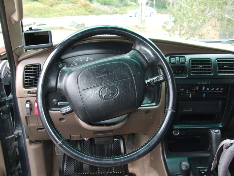

I finally plasti-dipped my emblems. I also installed my Ultra-Gauge, which took 5 minutes and 2 zip-ties. I still need to calibrate it though. I'm also doing the Taco Whip mod in the next 2 or 3 days, so I'll post some pics when I'm done.

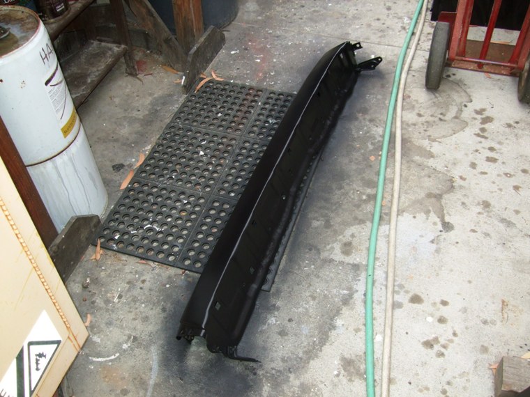

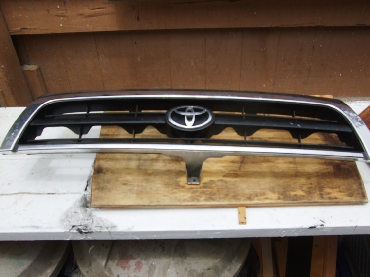

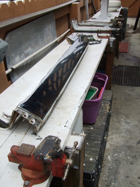

I finally bought my SEM trim paint and primer adhesive from a local body shop here in OC. My plan is to black out my remaining chrome, front and rear bumpers. During the last two days on my breaks from work I decided to clean, sand, and paint my entire chassis/undercarriage, including using high heat primer and paint for my muffler/exhaust pipes. The difference is incredible! I'm letting it dry tonight, and I'll post pics tomorrow.

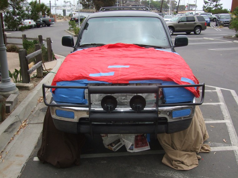

I taped up the seals and joints on my driveshaft. My mechanic friends told me everything else is fair game as long as you use the proper paint on the exhaust pipes, which I did. My SS 1.2 suspension lift and 33" tires really showed some of the rust spots I never noticed when I originally bought the truck 6 weeks ago. Altogether my Runner has now undergone a transformation that I believe will make it last another 10-20 years, depending upon my plans. Pics forthcoming I promise!
This update is pic heavy. First two pics are of my Ultra-Gauge installed.
I decided to paint my front bumper, front grille, rear bumper, rear spoiler, and plastic over the bumper. I used SEM trim black, a paint I stumbled across on COB's thread, and I talked to Brianemc2 about it as well.
The paint is a satin finish that perfectly matches my powder coated wheels. Everybody around my shop has commented that it looks like a professional job. I accidentally threw out the can of adhesive I used as a primer. I bought the supplies from a place called the Paint Store in Laguna Niguel here in OC. The guy knew his business. I cleaned the chrome with soap and water, sanded it with 400 grit wet/dry, then used 2 coats of spray adhesive, followed by 4 coats of SEM. I missed two spots I need to finish up cuz I used all 3 cans I bought. I'll finish it tomorrow. Here are additional pics:

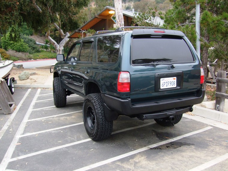

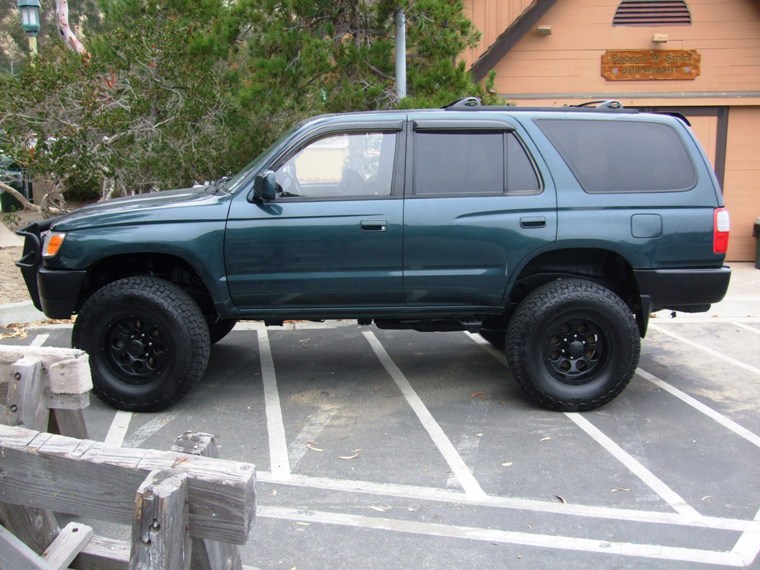

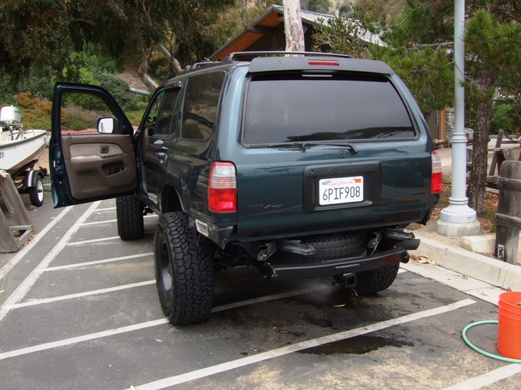

I need to take better pics, but here's my truck as of now:
I'm thrilled with the way the SEM paint turned out. Now we'll just have to see if it's durable, but I've heard excellent reviews! I'll keep you guys posted.

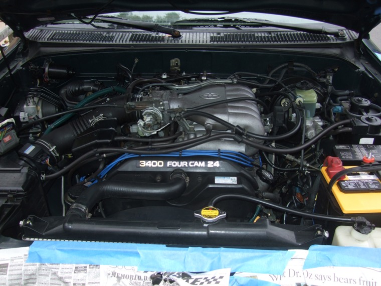

The paint looks great and makes a huge difference. But that engine bay, DAMN! its spotless! Makes me wanna clean mine
Thanks Zachpins! I appreciate the kind words. The bumpers turned out better than I had hoped. I painted them cuz I've had to spend unexpected cash the last 2 months, thus delaying an Outdoor Logic bumper for the foreseeable future.
And this may sound weird, but I've been on a cleaning binge lately, including painting my entire chassis/undercarriage to prevent rust, and cleaning out my engine. I bought the truck almost 2 months ago, so I want all the dirt to be mine, not the PO's. That way I know I earned it. I've actually been looking at the front D-ring mount thread and stumbled across your name. The mod list is endless, so I'm adding those to the wishlist.

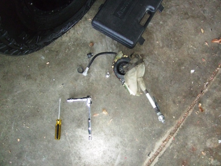

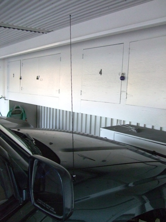

Had an hour of free time last night, so I finally decided to install the Taco Whip Mod. Took about an hour total cuz the PO really mashed up the bezel nut where it connected to the truck. The hardest part was running the antenna to the radio, but it was straightforward enough and I'm pleased with the results.
Here's the old motorized unit:
Here's the new antenna. I snapped a quick photo before I had to run errands:
