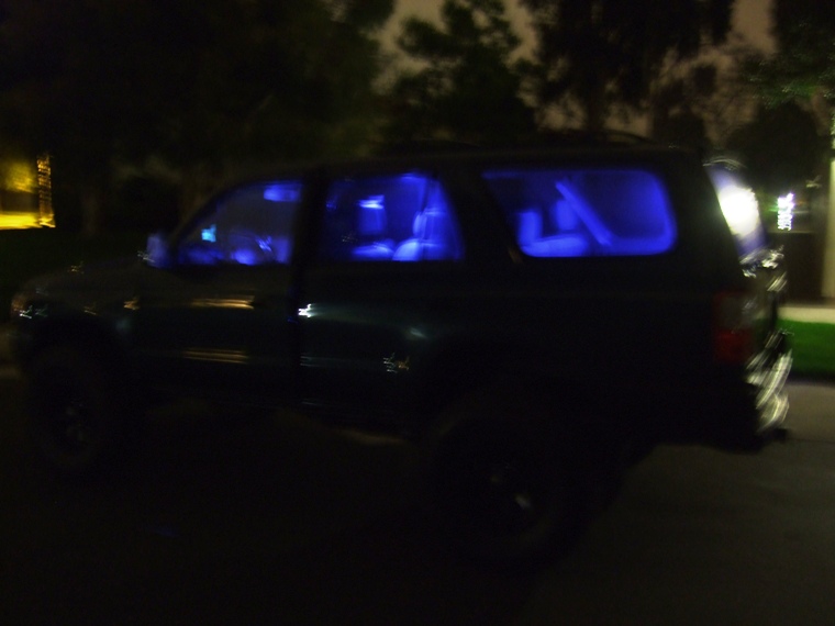

Here's a random pic of the blue LEDs at night:

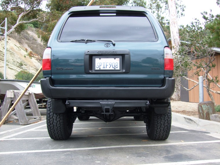

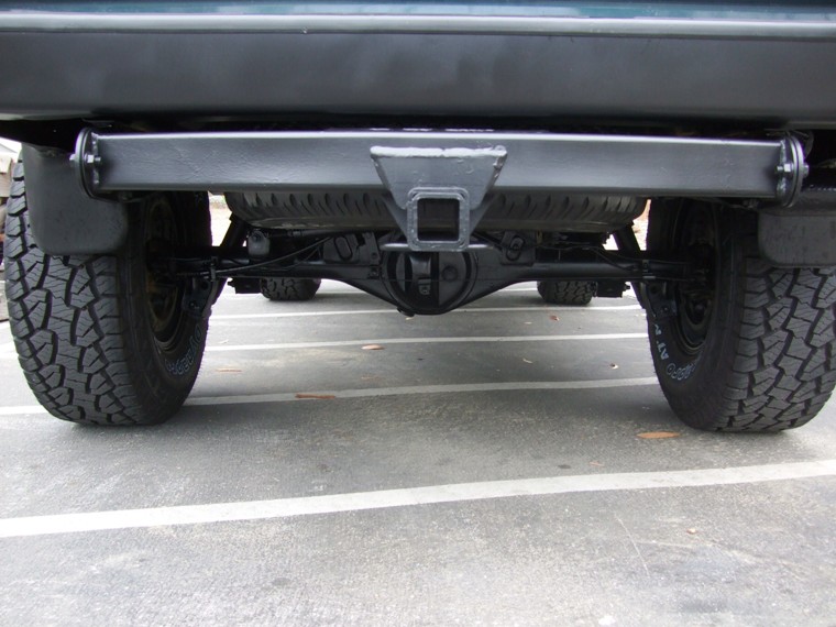

Here are 2 pics of my tow hitch, which I painted with SEM, and some glimpses of my chassis/undercarriage, which I painted with an automotive rust primer, then top coated with Rustoleum:

Did you have much rust on the undercarriage? How did you get it off? if you did sand some rust off, can you recommend a specific tool or product/method for how you did it? I bought an Ohio T4R and it's now in a rust-free (read: very dry) area, so I'd like to get that rust off and paint it with some chassis paint...

Regarding the chassis you can go about cleaning and prepping it several ways, depending on your time/obsessive compulsive behavior. If you have a DIY type car wash in your area, I recommend spraying off all the dirt and grime, then cleaning as best you can with a solution, like Simple Green or soap and water. I don't have a DIY car wash in my area, so I did most of this work by hand, which took about an hour or so. Depending on the severity of your rust, you can work your way through sandpaper. I started with 150, 220, then 400 as a finishing grit and wiped everything as best I could, at least on the chassis itself. I didn't sand the axle or exhaust system or any other mechanical part. That I just cleaned and painted. I figure I'm not going for looks, but trying to contain and prevent any further rust.
When I bought my SEM, I also purchased an automotive type primer the salesguy recommended for my chassis (I'll post pics when I go to my shop and grab the can). I bought a brush-paint application, which I regret in hindsight as it takes forever. I used that as a primer, then decided to spray over it with Rustoleum to hit the spots I missed.
For the exhaust system, from the headers to the pipe, I used Rustoleum high heat primer 2000 degrees, and Rustoleum high heat top coat satin 2000 degrees. Then I painted the exhaust pipe itself with Rustoleum 500 degree semi-gloss, so the pipe better matched my wheels.
I have a few stubborn spots I missed tucked up behind the tow package and spare tire, which I probably need to get rid of at some point anyway. One of the reasons I did such a fastidious job is that my lift and tires showed off some rust and I figured taking care of the chassis was yet another way to show people how much we care about our rigs.

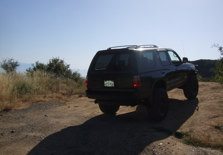

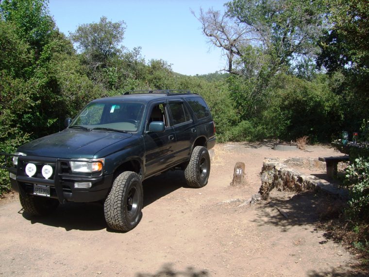

Went up into Cleveland National Forest to camp, hike, and play around on old fire/service/truck roads. Nice to get a bit dirty. I only snapped a few pics, none too crazy.

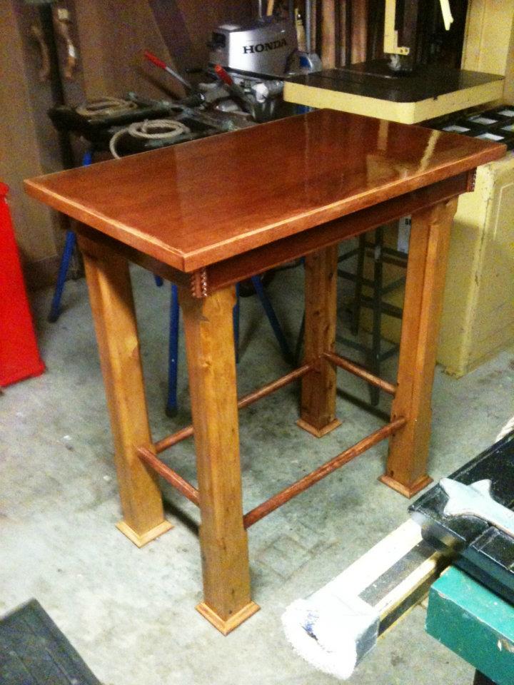

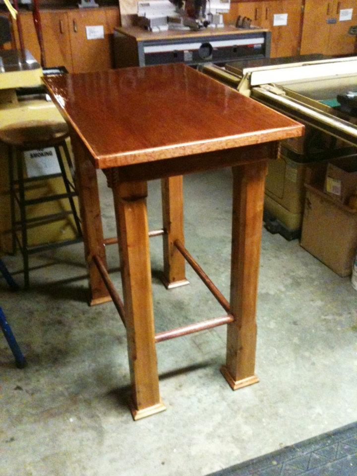

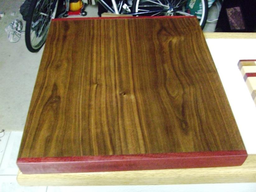

Since I have a few minutes today, I'm posting pics of projects I've recently completed. These help to pay the bills and pay for my truck as well. I work across several mediums and disciplines, though my preference tends to be woodworking.
