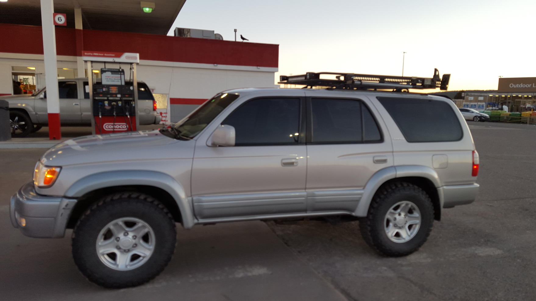

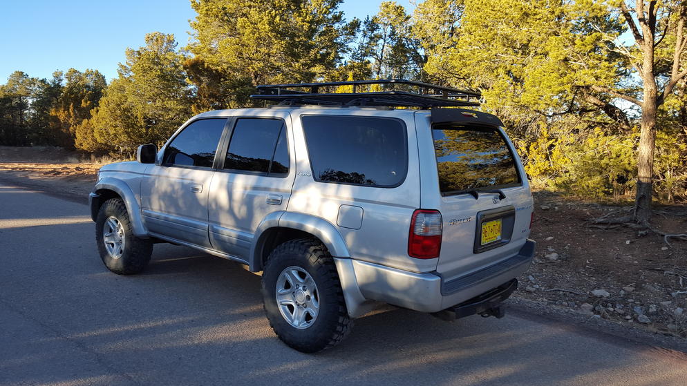

Well guys I pulled off the roof rack and put the new welder to work. Added some supports on the floor of it, a mounting plate/support for the led lights and some cool little flat plate supports in the shape of an hourglass that imo give it some character and function. Already had the 20" lightbar on there but added the two 3" spotters to fill in the ends. Really happy with the way it turned out, is much more sturdier than before, and the best part was I got a little practice for the next project...bumpers, to be continued...

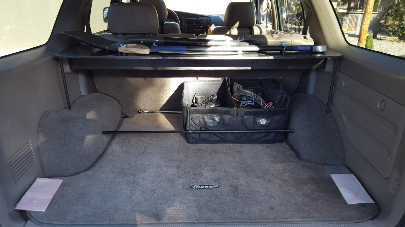

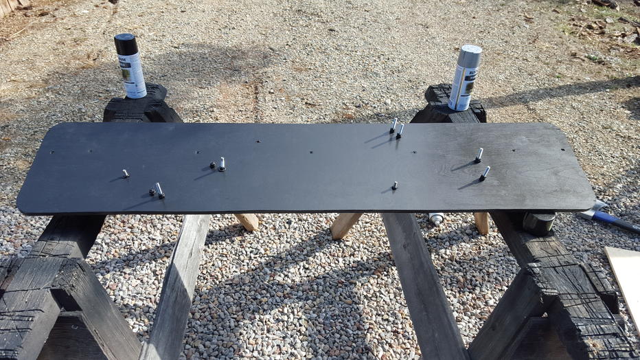

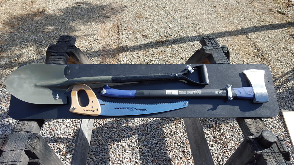

So I went to lowes yesterday and got some supplies to mount a shovel, axe, small saw, and a hi-lift to my roof rack. Well after looking at things I wasn't really sure how I was going to mount all that stuff up there without looking like the beverly hillbillies, lol. So I decided to make this platform that slides into the pockets for the cargo area cover. I am pretty happy with the way it stayed. Was able to mount the shovel, axe, and small saw on it while keeping the bottom open for other items I need to put back there, and I will make some brackets later to mount the hi-lift on the roof rack. Check it out...

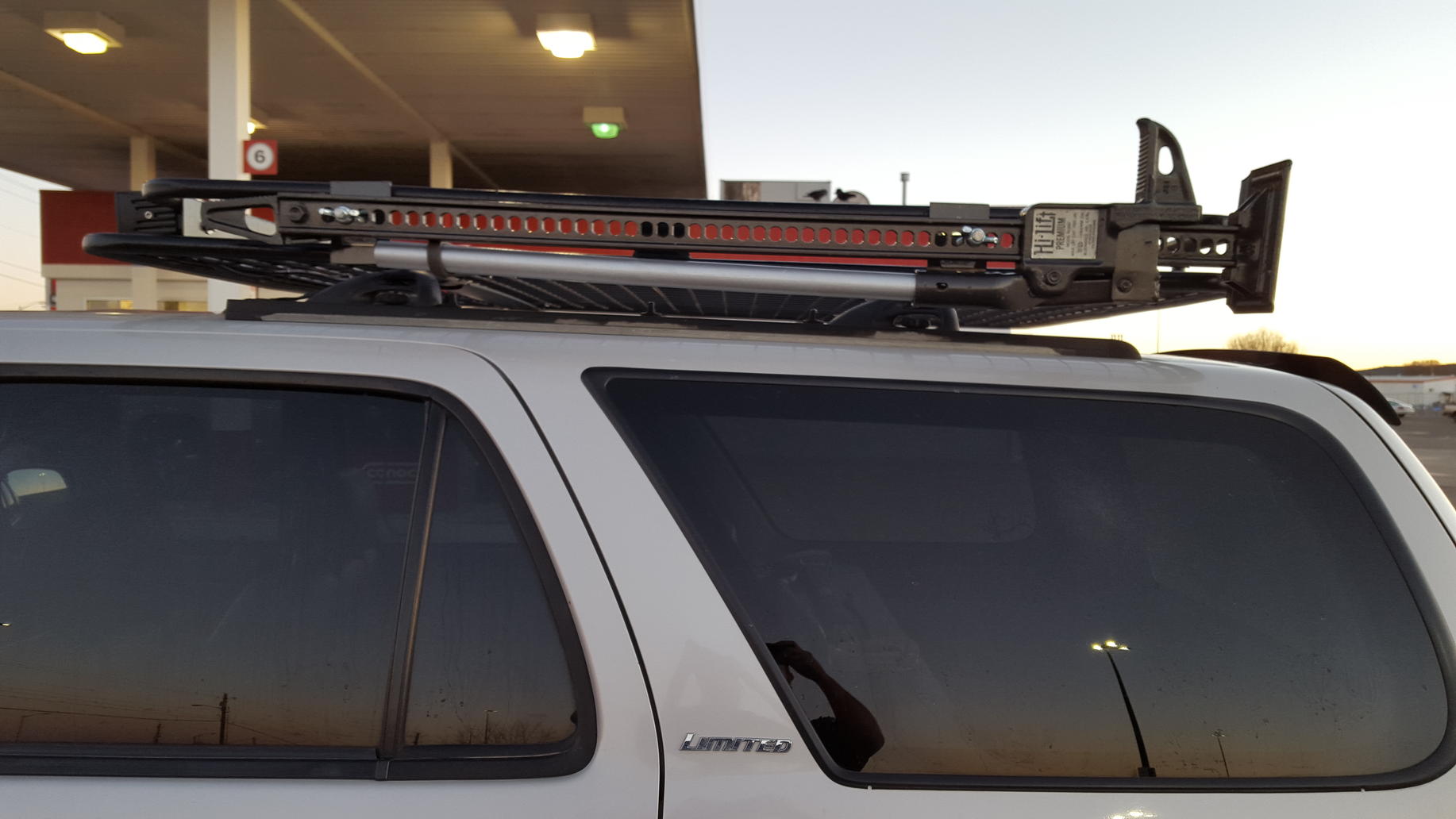

This weekend I fabbed up some mounts for the hi-lift on my roof rack, and gave an old hi-lift my dad gave me a long time ago a facelift. Was happy with the way everything turned out, but once I put that extra weight on there it rattles on the bumps. Its the crossbars that have give, not the rack or brackets, I guess i'll have to remove them cross bars on the oem rack and fab up some brackets to mount it directly to the rails, this things pissing me off already...
