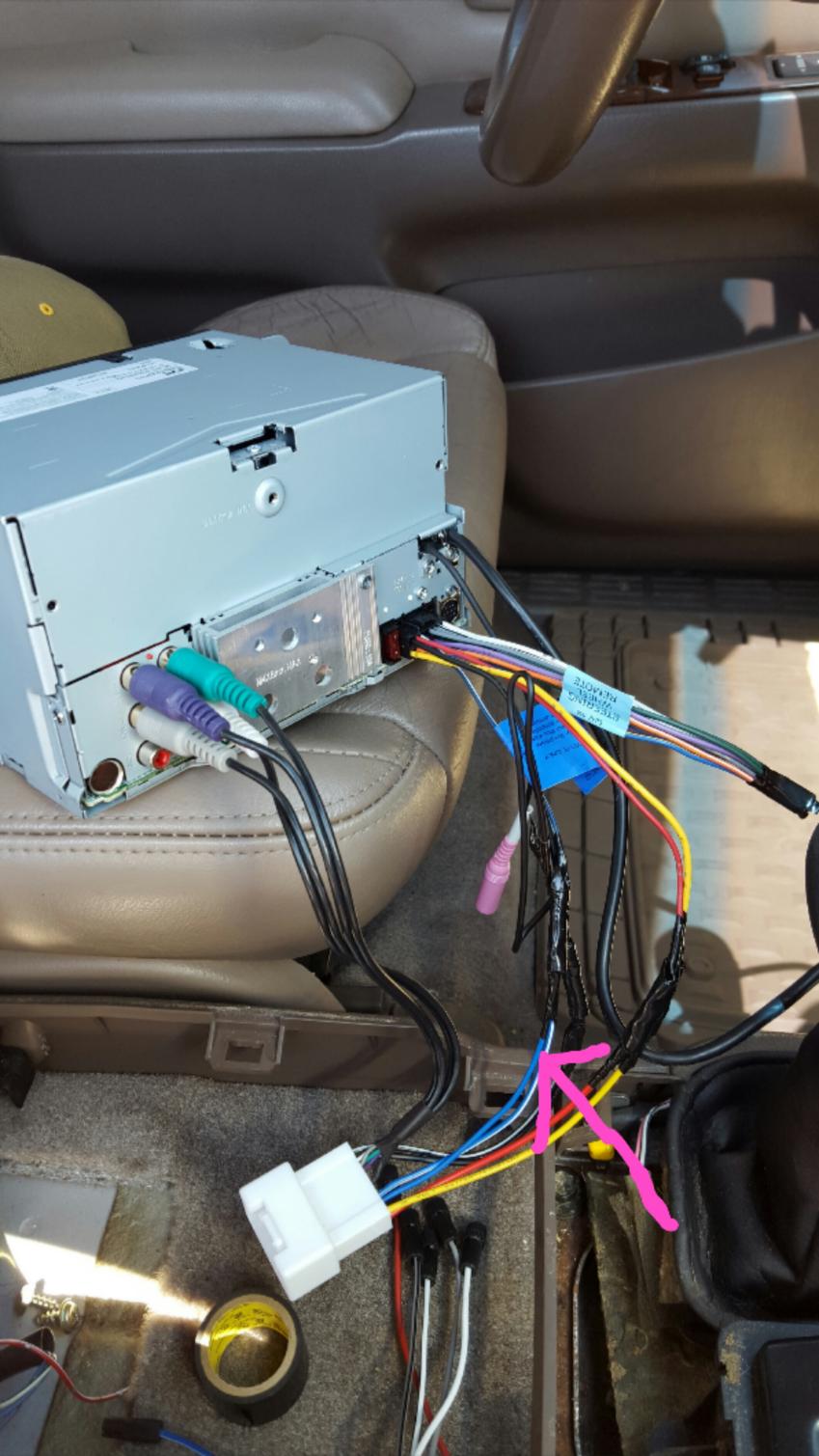

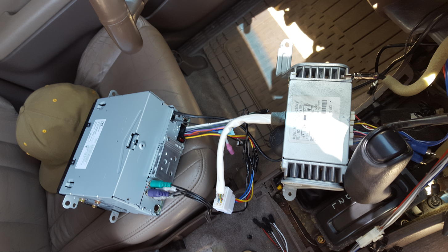

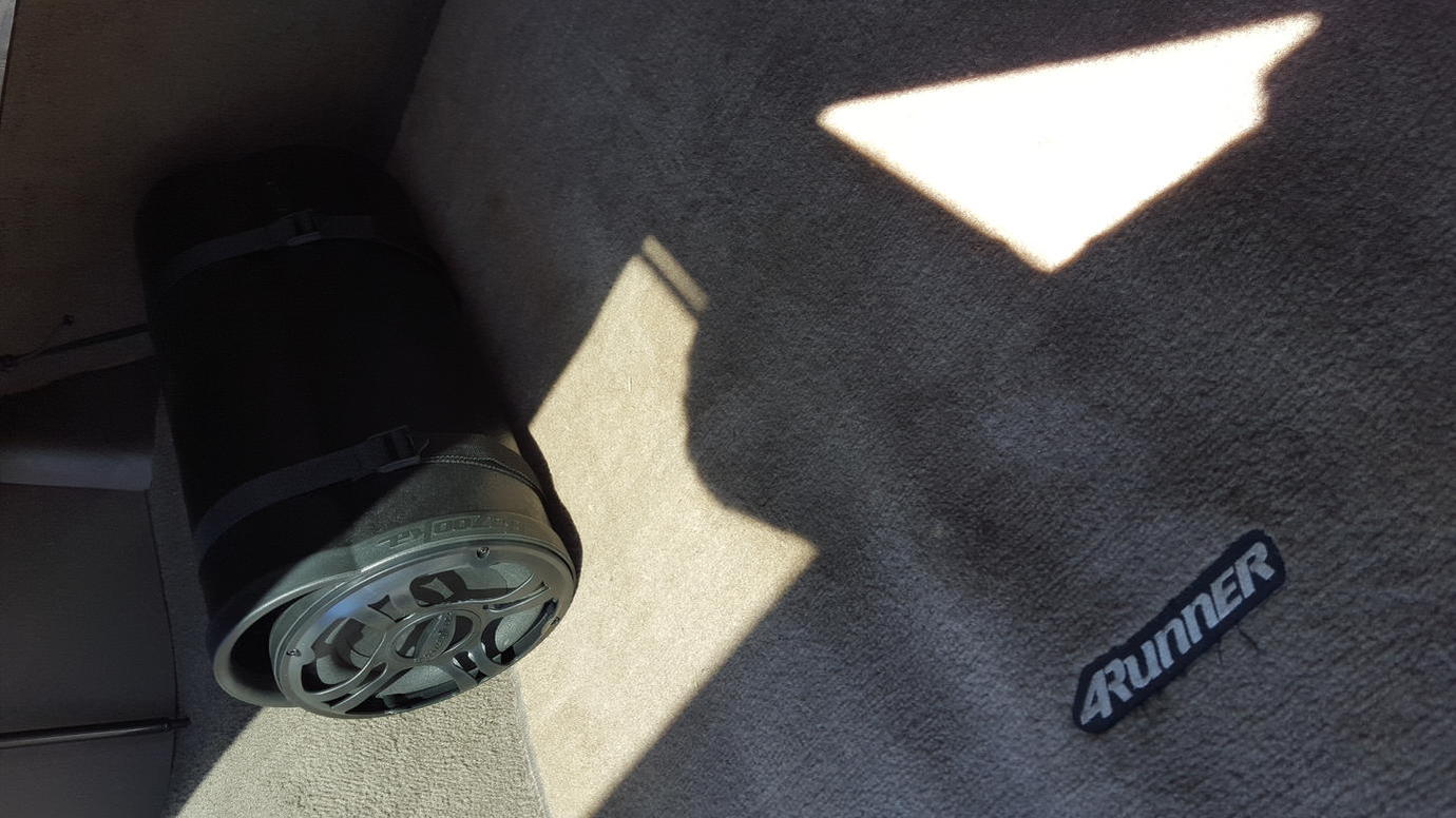

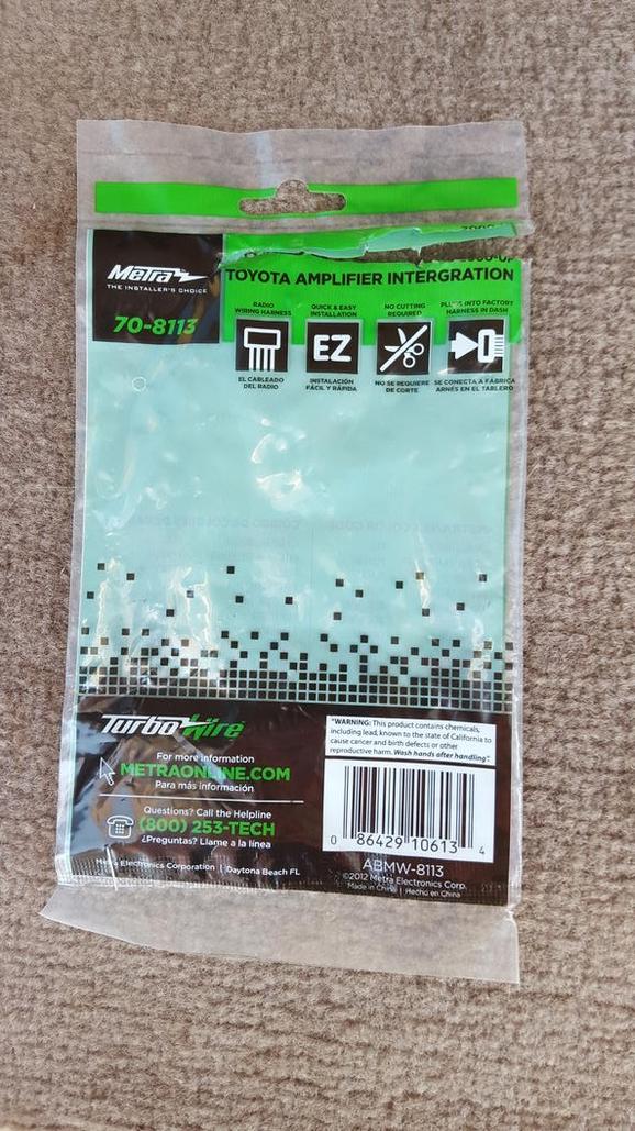

After installing everything i was getting power but no sound and ended up giving up for the day. I posted a help thread and a lot of people chimed in, thanks guys. The next morning i followed some of they're direction and went over the wiring diagrams again and found out that I hadn't connected it right. Turns out I had all the right parts just had to read the wiring instructions a little closer. So the jvc harness only has one wire (blue & white) that is the amp & antenna while the adapter harness had 2, one blue & white which was the amp and a solid blue which was the antenna. After looking at the wiring diagrams again it said to combine both blues from adapter and connect to single blue & white on the jvc harness shown on the picture below where the pink arrow is. After that I had sound. The other thing that will interest you guys is the adapter I bought does go to the factory amp so I wasn't able to bypass it like you all suggested. Not sure if it would sound better with the factory amp or without it but sounds pretty dam good, alot better than the factory. I also hooked up an amplified bazooka bass tube and it brought it all to life. I will post a pic of the package to that adapter in case anyone needs it in the future. Thanks to all who gave me direction, I really appreciate it, hopefully this will help some one else.
The adapter harness i used.
Everything hooked up.
The bazooka base tube.

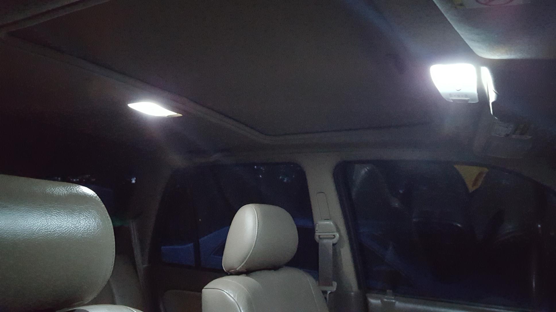

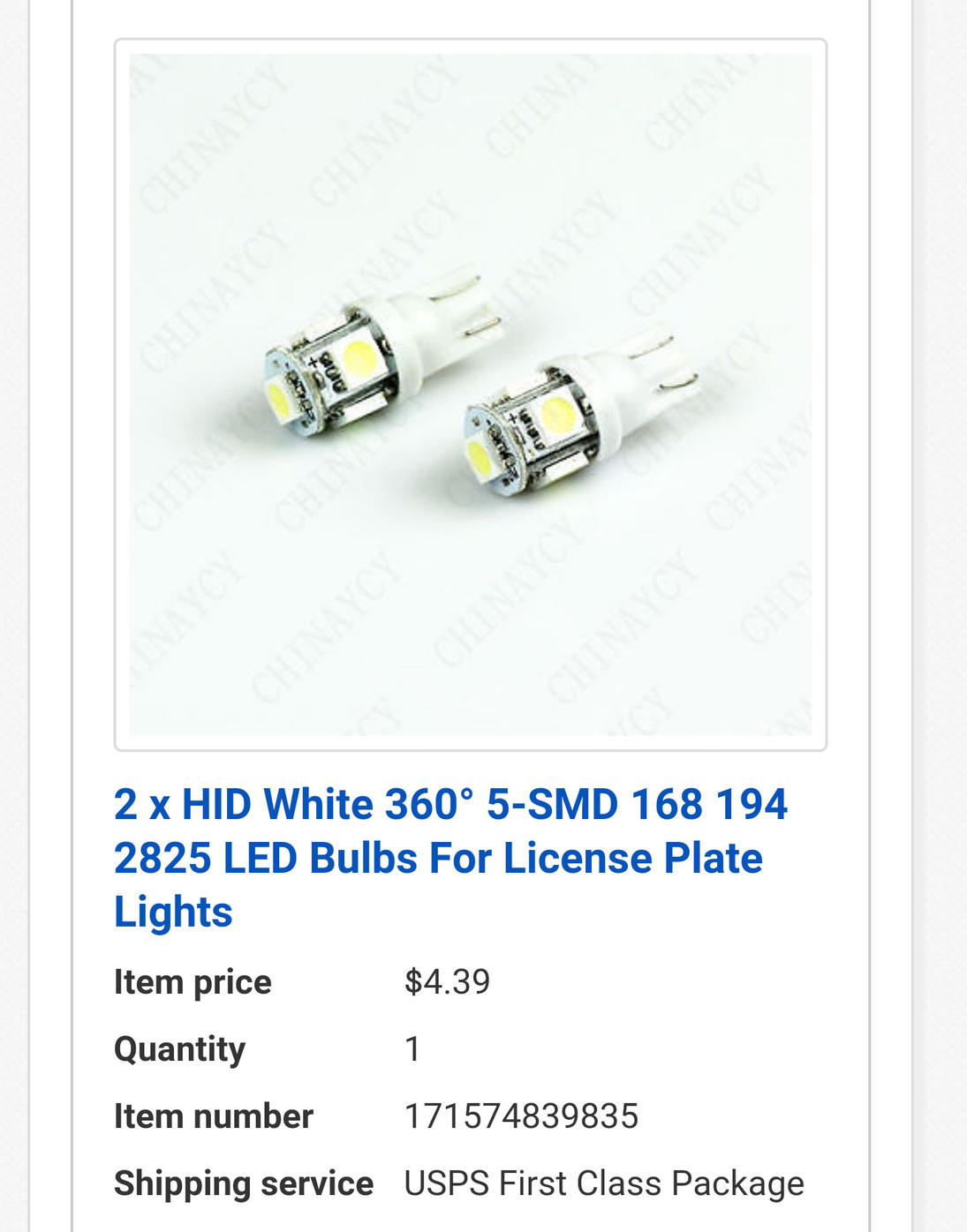

My led interior lights came in yesterday. Did the map lights, dome light, and cargo light, also got the license plate bulbs.
Map bulbs i used.
License plate bulbs i used.

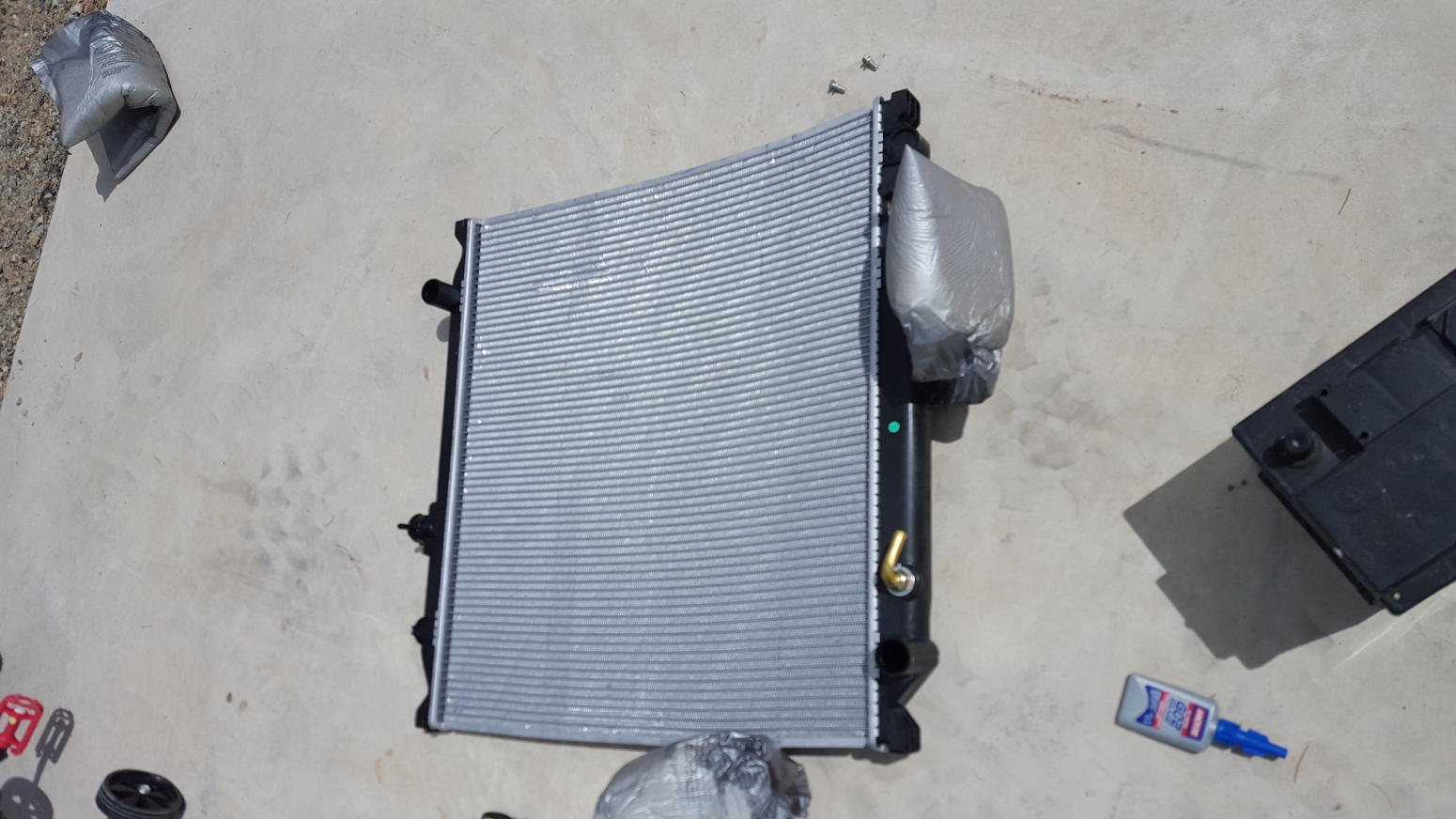

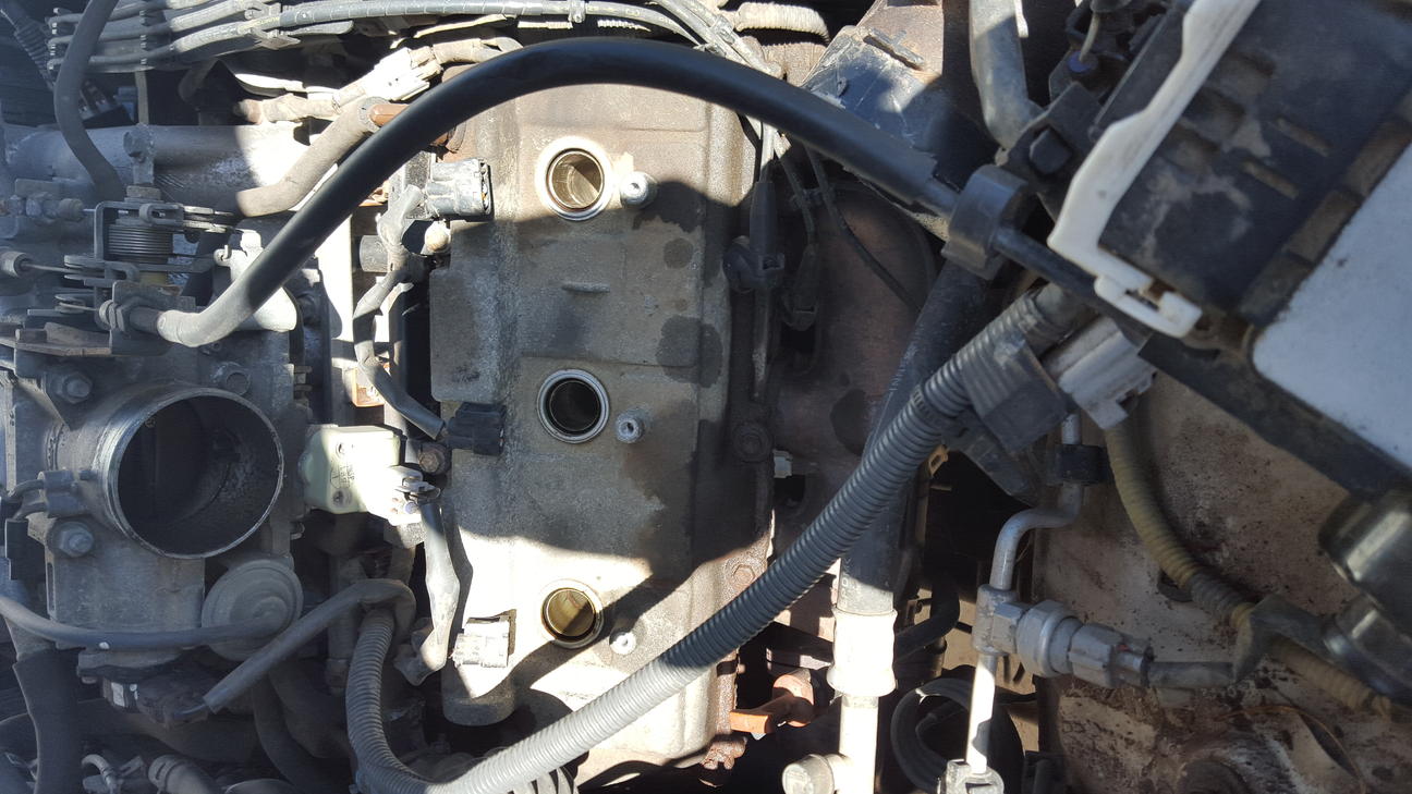

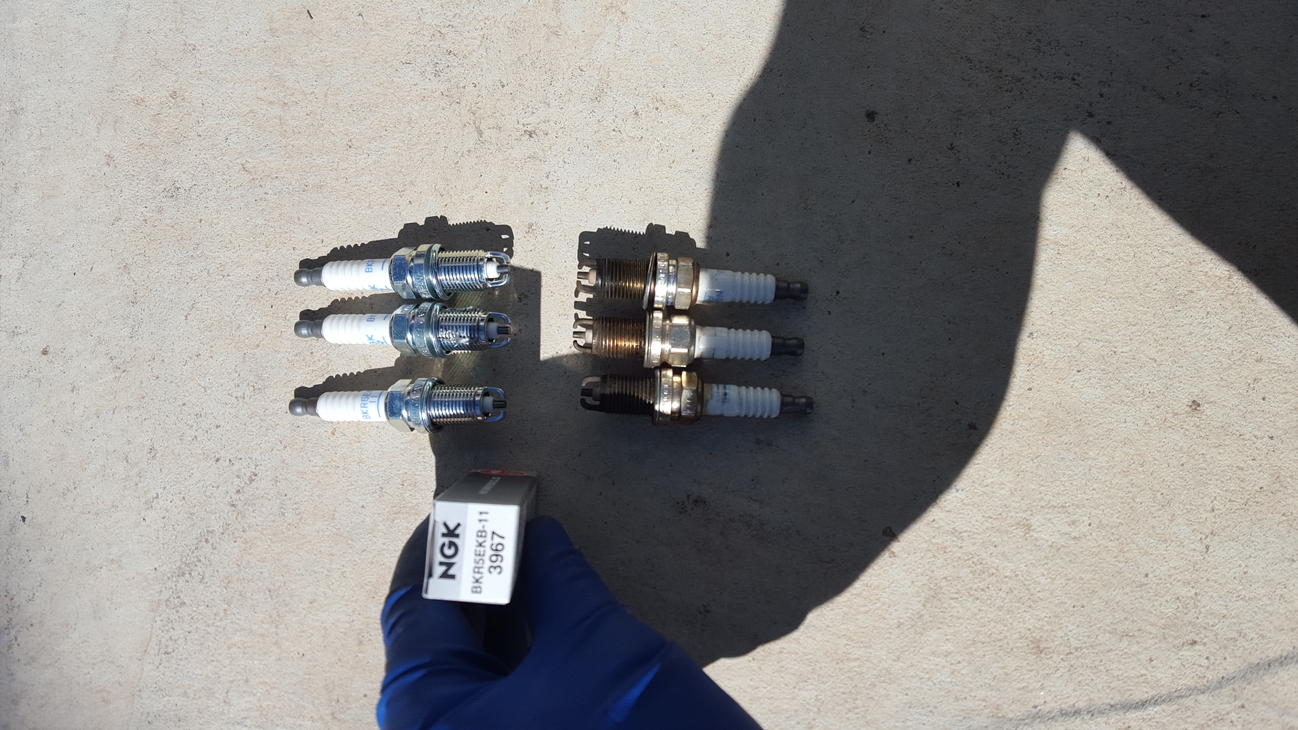

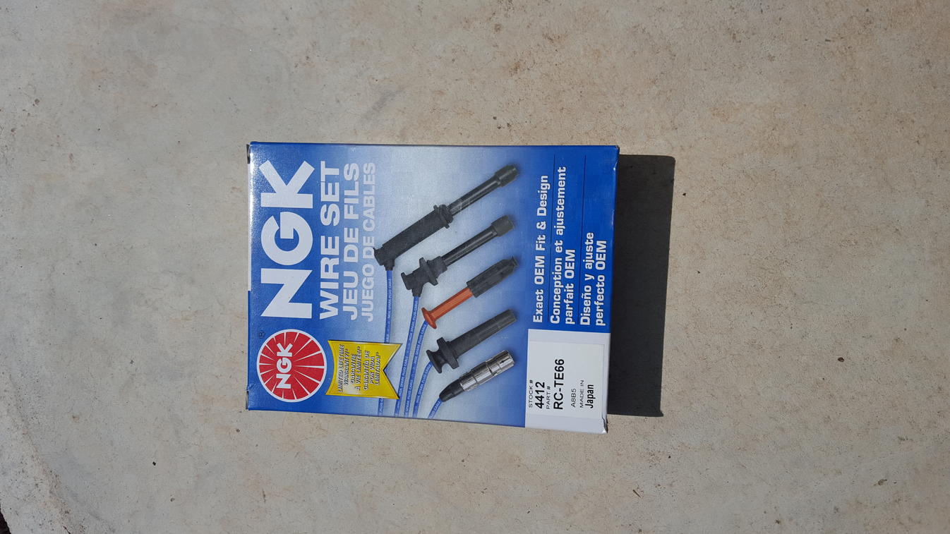

Did some maintenance on the runner, changed out spark plugs, wires, installed a new radiator (that I ordered from summit racing and is a piece of shit btw, but have had it over 60 days so I can't return it), and a new battery.

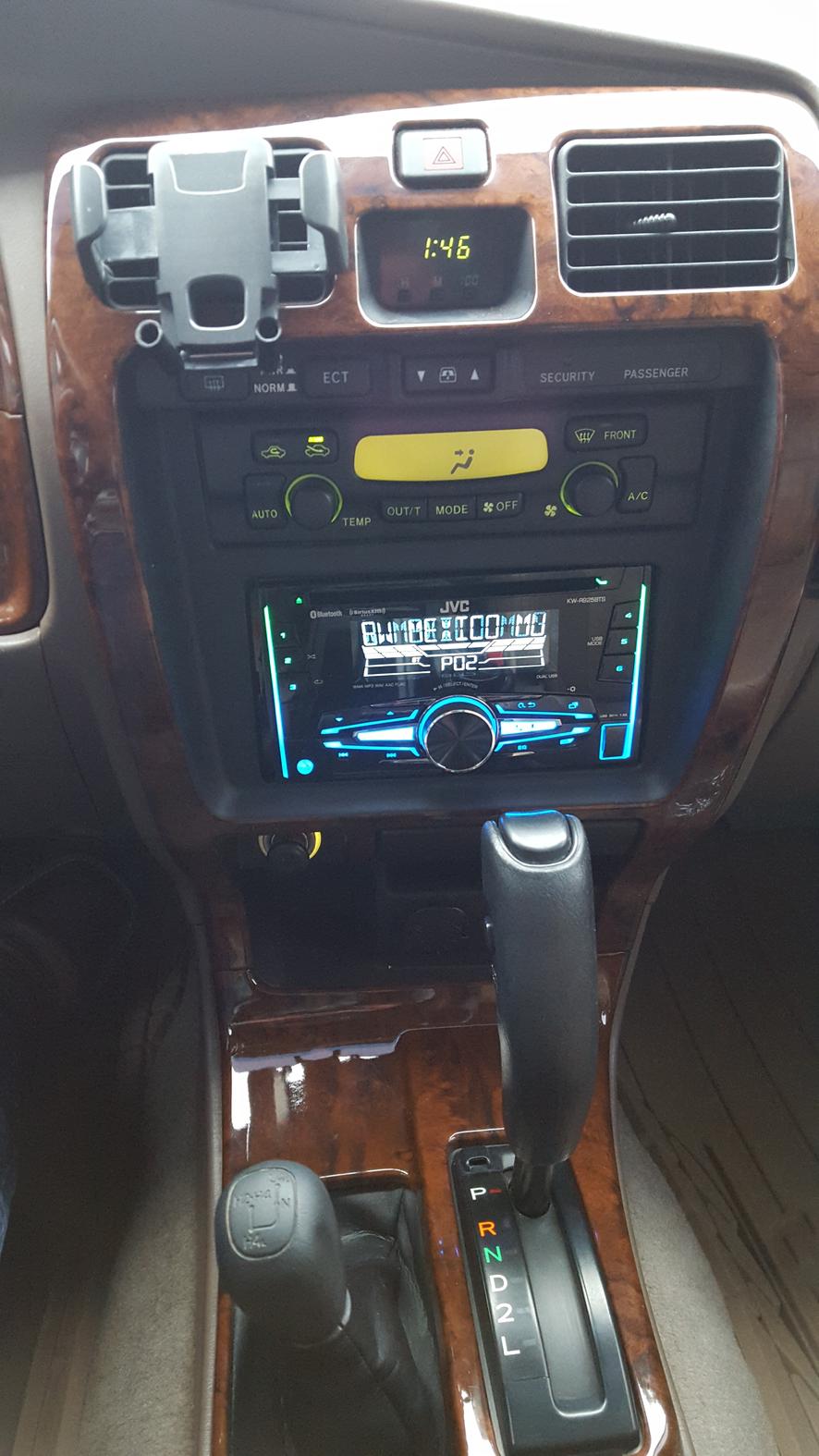

Got the dash all buttoned up, climate control all good to go, thanks John, stereo in and ready to enjoy some tunes.
