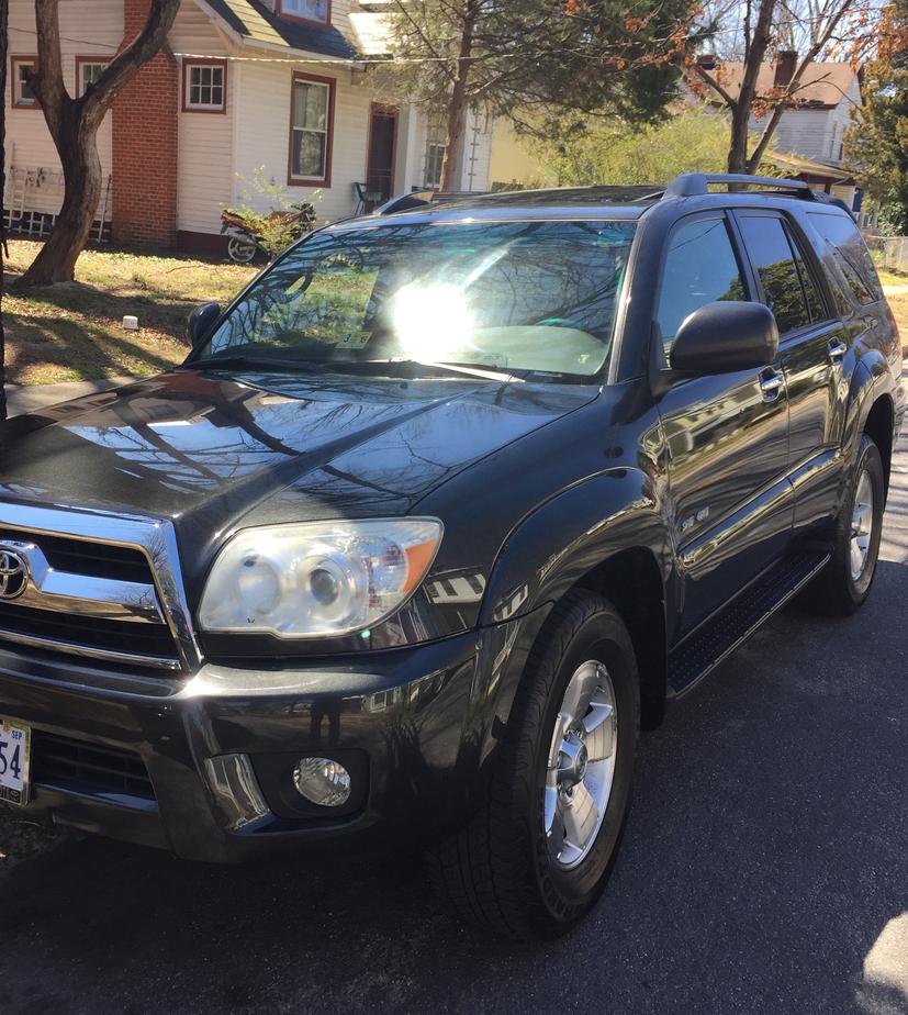

1st photo is from the day I purchased it.

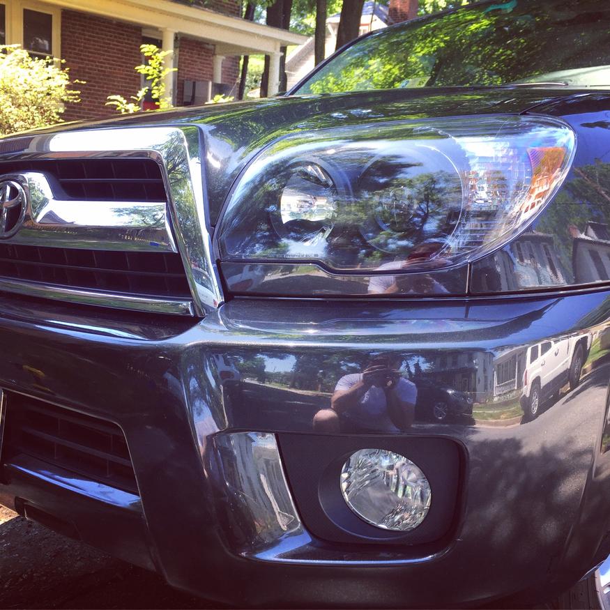

2nd photo is after the headlights installed.

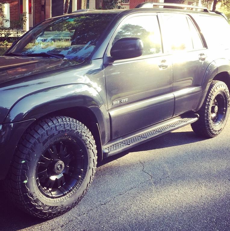

3rd is from last week after I purchased some 17" Pro Comp 5001s wrapped in Falken WildPeak 265/70-17s.
Even though the old tires where also 265/70-17s, the new tires have some major rubbing up front.
I measured the wheel gaps and the front is badly drooped. It's 2.5" lower on both sides vs the rear.

I agree with the decision to lift it. I have the same 265/70/17 Falkens and even with the 2.5/1.5 Daystar, I still had to do some minor clearancing up front to get things to clear. Do a search for the front clearancing on this forum. It's pretty easy to do. I am also running a pretty aggressive offset which doesn't help - 17x8.5 -10mm offset.
What headlights are those and how much did they cost?

Thx for the tips. I'm running 8" wide wheels, a 4.5" BS and while I hope the lift helps with the rubbing, I'm already looking for someone local to weld in the pieces so I can make the front body mount trim mod. Plus, I'll use the heatgun method to reshape the inner fender wells.
As for the headlamps, I picked them up from ebay by DT_MOTO. DOT approved, shipped for $180 back in March.
Install was easy, quality was a lot better than I expected for under $200 for a pair of lights. I did have to mod 1 bulb because the opening was off, which was weird because all of the others fit perfectly.

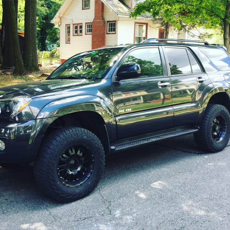

Old Man Emu Lift Installed
It's taken a few weeks, but I've managed to get my 2.5" OLD MAN EMU lift kit installed.
I went with the OME 884 (mild) front springs and medium rears.
I did opt for the front driverside leveling shim.
It's my 1st time doing a truck suspension and I was surprised how easy it was!
A few notes:
- I didn't have to bend the inner fender wells to get out the 3rd top strut bolt. Armed with a ratcheting wrench, I easily accessed the out of sight nut.
- I ended up not installing the diff. drop yet.
I'm not getting any weird noise from the axles and I've read so many mixed reviews. If anyone has any 411 on this subject, please feel free to chime in on it.
-As Luke noted, I still have some rub issues on the frame by the body mount even with the lift. (Although I only notice this really when backing up.)
- I've noticed about a 2mpg drop in my mileage. I was consistently getting about 400 miles per tank and now I'm getting about 350 on all highway stints.
The ride quality is really nice. Firm enough to make highway driving nice, but soft enough to smooth out holes, bumps and debris.
I'll be doing my 1st off-road use this upcoming weekend, while mostly fireroad, I'll be looking to test out the system a if the opportunity comes up.
Here's a photo of my newly lifted T4R.

Looks awesome!
