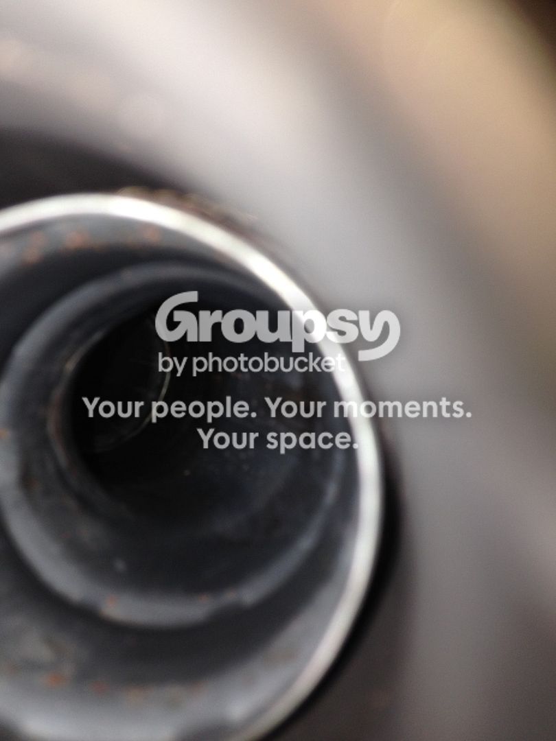

Yup it looks like a GM f body Y pipe lol.. Talking to Gadget there is another restriction to that section of the exhaust as well there are actually two pipes one inside the other. I guess Toyota did this to make the pipe a bit harder to crush since it sits so low. Here is a crappy photo taken from inside showing the second pipe so the outside diameter is no where near as small as the inside.
Yeah... This pipe needs to go.
