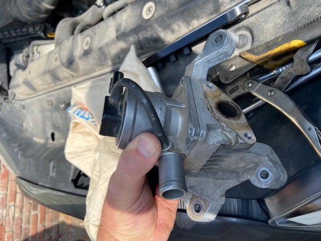

Got the secondary air valve from Toyota. Replacing it takes less than 5 minutes. Had not seen the code for at least 2 days before replacing. No code after starting it. Let it sit for 30 minutes and the code is back.

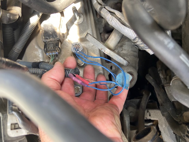

Alright, long week of work writing up quarterly deliverables on the bank I cover at the Fed Reserve. With the light of day on the weekend, I revisited the Secondary Air Valve. First thing, I pulled it to inspect the male side prongs of the plug on the valve and none were bent. So the electrical checked out fine. Did some other checks on the vacuum hoses and noted a rattle inside the valve, so I disassembled it by removing the 4 torx screws holding it together. When I split it open a piece of spring steel fell out. I think I found the problem. Pics attached. Also pic of butt splice repaired harness for the sensor (not the spark plug) under the Secondary Air Valve. New valve has been ordered at Toyota dealer and will arrive Tuesday. This will take just minutes to install.

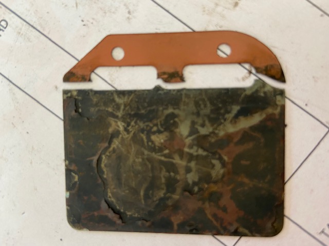

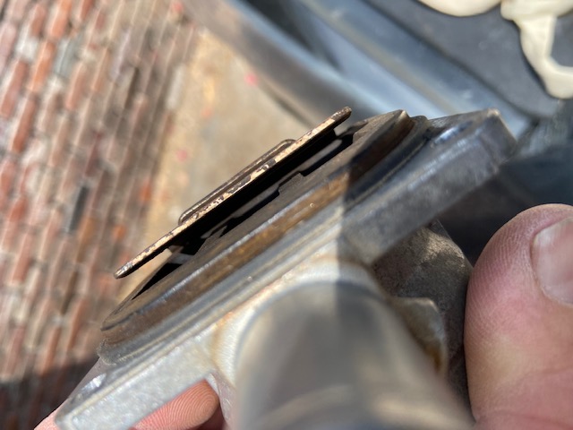

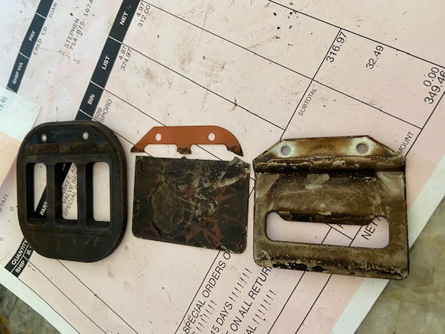

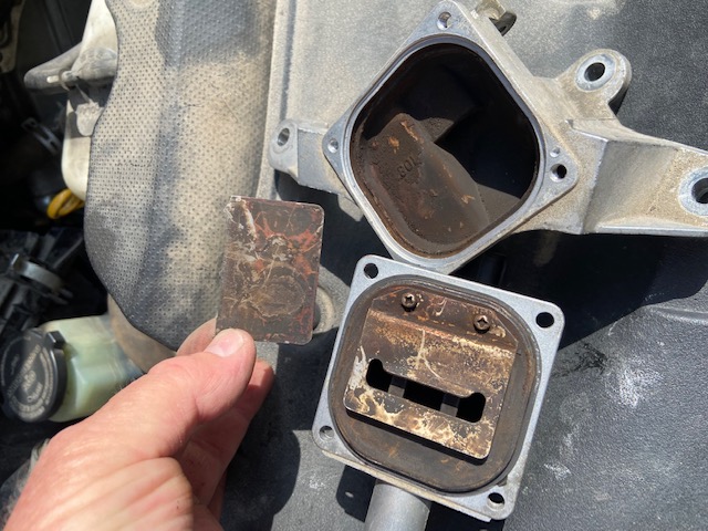

Since replacement part is on order, decided to do a little further disassembly of the valve. The two philips head screws sheared off as they were mushroomed on the back side to prevent separation of that plate from the underlying grate. The entire plate/grate simply rests in a rubber gasket and in theory is replaceable. Honestly, probably could salvage this Denso made valve by purchasing a Valve by Dorman at 1/3 the cost and swapping in the plate/grate. I will be hanging onto this Denso made valve for that purpose.
Anyway, got the plate separated from the underlying grate and you can see where the spring steel flap sheared off from.
Nice investigation!
Could you see the back side of the screws before the heads sheared off or just didn’t notice ?
Valve isn’t cheap!
No could not see the back side of the screws….until the whole thing dumped out of the valve. Doh!
I could grab the back side ends of the screws with vice grips and remove them. But since the whole plate/grate unit just drops out, it would be pretty simple to swap in a new unit.
I definitely can find the valve cheaper for like $200 from On-line Toyota OEM Parts suppliers. But it’s my wife’s truck, so repairing sooner is better. I was tired of her coming to grab me to erase the code with the code reader.
Copy that, never saw one, didn’t know how it was made….. thought maybe valves and rubberized plate was removable and them being sandwiched between metal parts.
To wrap this up, finally got Toyota's pricey Air Valve. It comes with the the 3 legged base that attaches to the engine, when you really just need the valve. They said it was a demand pull order item and required providing the VIN # for the vehicle before they would ship the part to the dealer. In the interim I bought a used valve on ebay for $80 shipped and that arrived earlier than expected, like 2 hours after I had installed the pricey new one from Toyota. So now I have a spare.
Drove the vehicle around at lunch stopping at multiple stores and filled it up with gas. No codes so far. Pretty confident this was the fix as anything electrical throws a code immediately. The mechanical fail was obviously a delayed, or infrequent code trigger.
So for the Toyota Tech Repair manual lengthy list of test procedure for DTC P2443, I would add shake the part and listen for any rattles :-)

Well we were still having intermittent P2443 codes after replacing the valve. Note that the manual says to check the wiring, I went back to do that. Pulled the plug from this Secondary Air Injection Valve and this time the outer wire on the right side (plug facing you) simply pulled out of the back of plug, similar to what happened on the sensor plug underneath this valve the last time I changed spark plugs. The wires are simply pressed into the back of the plug and it is often not a solid connection. Once a wire pulls out, they are near impossible to get back into the plug. This time I was able to jam the wire back into the plug, but there is no guarantee it will stay there. I cleared the code and so far it has not returned.
Last time I found a replacement plug for the sensor. I had to cut off the old plug and butt splice the new plug into the engine harness. I know that I posted about it here, so I need to find that post and see if it will lead me to a source for this connector plug to the Secondary Air Injection Valve.
At the outset I joked about Gracie and her small hands being ideal for the spark plug replacement job.....and I was not kidding.
