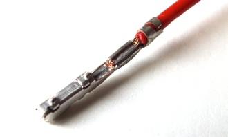

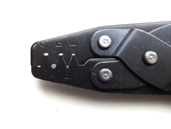

So it’s a two step crimping process. Can you describe which part goes where in the crimping tool. Back end of the female terminal is for the insulation portion of the wire. Where does that go in the crimping tool. Similarly for the wire portion of the terminal.
Here is a video that will help….
How to Crimp a Terminal - YouTube

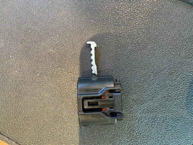

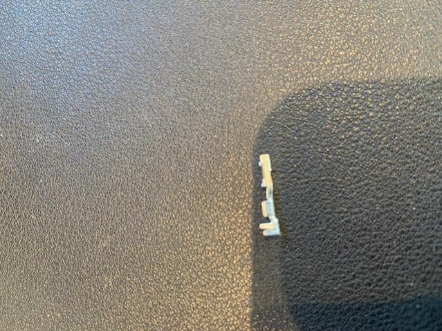

Wish I could figure out the damn locking clip. They come out easy.
Ok I crimped a pigtail of wire to a terminal and pushed it into the existing plug. Once again, could not get the locking clip in. The terminals have two barns atop the female end portion that also lock it in, or you at least need a tool to release them. So there is some redundancy and it is being held there. I plugged it back on and no code, but the real test will be after the next cold start-up.
I wish I could help you with the locking clip , never delt with that one.
Only suggest looking at some videos….
Traded e-mails with the owner of cycleterminal.com. That white plastic locking clip is supposed to slide to the outside, but remain in the plug. Then you put the wire terminals in and slide the locking clip back in place. So it's really a just a shift, not a full removal. As the locking clips got ruined in my dumb shit move, I ordered a couple more plugs to make a final, permanent repair.
Currently the plug is in place without the locking clip. The terminals do have two barbs which also hold them in the plug. Wife was driving it around yesterday and today and so far no codes. Pretty certain the problem is resolved, but I want a more permanent solution on the plug with the lock clip in place.
