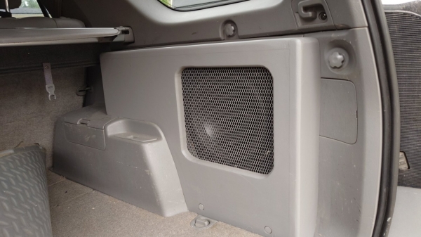

"Hot knife method"? Interesting. I pulled the side panel which should have been easy except for the knob plastic connector. Stock sub is dual coil. Both VC's measured about 7.3 Ohm which I think is good. Surrounds were gone but the driver should have moved with signal. I replaced both head unit and amp with same result. Hmmm.
Very easy/lazy method, just take a knife, heat it up, cut out the surround. I used a folding husky box cutter knife with a fresh blade.
With a clean cut the mesh surround just pops right back in. A few forum threads detail the process.
Downside is you lose protection for the sub from objects being thrown around in the cargo area but I keep a ton of crap back there and never had an issue. Also easy access in case sub goes out again in the future.

Oooh. I just looked at photos. It's 2 Ohm rated so a tough load for amplifier. Can our stock amp handle this? And what about mounting? I see four mounting holes in the sub photo while our sub box has six.
The sub-panel that covers the sub is in theory removable but it has a hot weld in the back to hold it in place. (This sub-panel does not have a grill opening for non-JBL optioned trucks.) If this panel can be made to open on demand, that would give plenty of access to the sub cover. It would look totally stock and not compromise protection.
Thanks for the replies. I ordered Pioneer TS-A2000LD2 from Amazon, $65 shipped, includes $60 coupon for signing up for Amazon Shop card. This sub has 6 screw mount so easy install. I cut out the plastic welds for the sub cover. Cover pops back into place and is friction held but the mounting posts. Not ideal but it stays in place.
