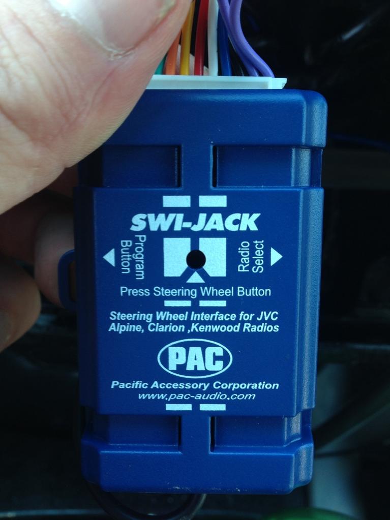

I wanted to avoid trying to shove wires through the rubber door bendy tube things. However, since you mentioned it, I went out there and looked at the wire bundles going into the doors and realized that I can simply splice into the speaker wires right there at the door jams. Does anyone know which harness is for the steering wheel controls?
This is the module to utilize the steering wheel controls, I'm pretty sure they're universal you just have to program it to your truck.

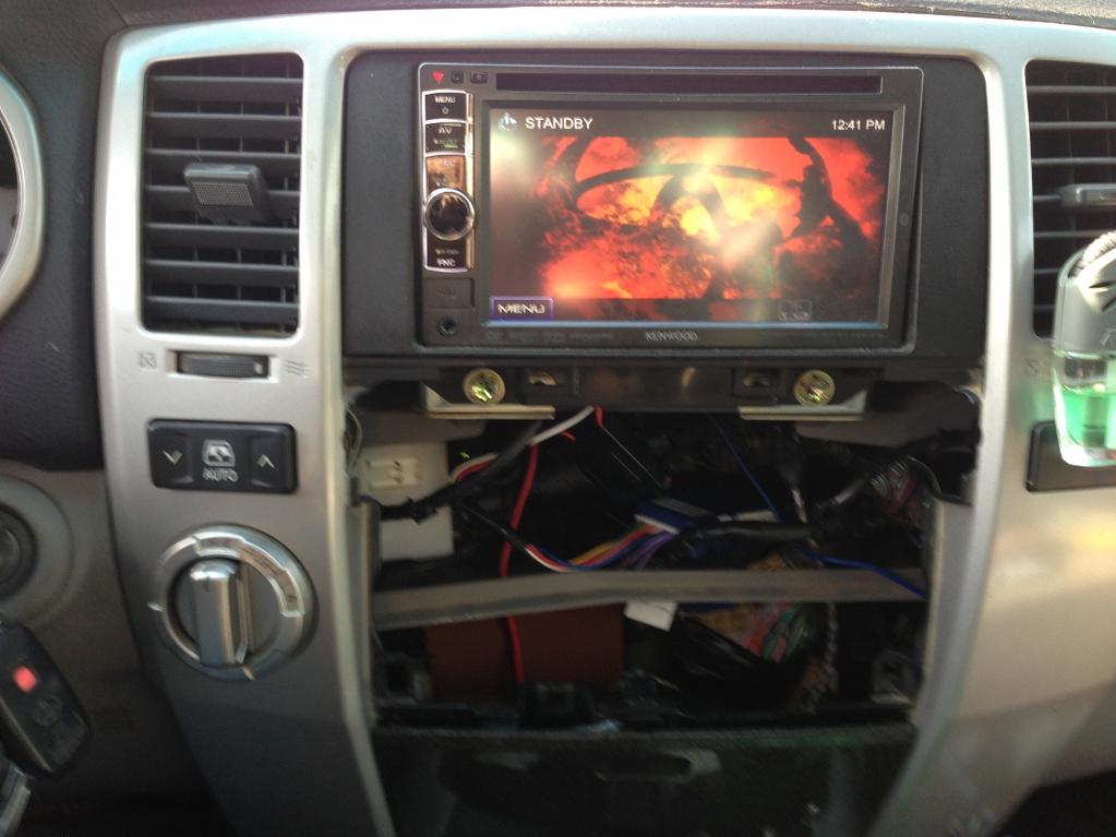

Tucks in the dash easily

I By passed my factory amp right at the amp connector I used a signal indicator to tell me what speaker wires were which and spliced the incoming signal wires to the corresponding out going speaker wires. The Kennwood HU has a built in amp that pushes plenty of power to the door speakers (I'm still using factory door speakers and tweeters gettings great mids and highs out of all of them) I deleted the front center speaker as it became the loudest speaker in the truck after the install (IMO the sound is much much cleaner) added in a JL250 single channel amp to a JL10w-7 port/slotted box and the sound is amazing.
I'd post pics of the splice job but I've had that back panel off enough lately lol if i have to pull it to run my back up cam video feed soon I'll get a shot of it then. I was even able to leave some of the wires connected to the factory connector and tuck it away incase anyone ever wanted to re-install the factory sub/amp HU setup (who knows why but its there anyway). all in all it was an easy install the biggest pain was determining which factory speaker wires were which while by-passing the factory amp.
